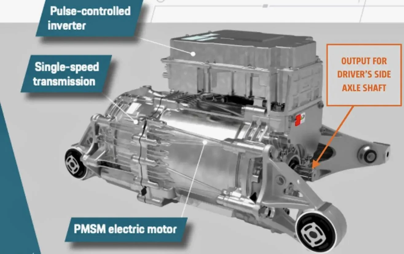

It's not just software, at least between Turbo and Turbo S. Turbo S has different front motor & electronics than Turbo. I don't have hard data on the GTS.

No need to guess, it is in the public domain.
All 4WD models have the same front motor but the turbo S has double the inverter capacity to all the others.
The standard, 4 and 4S all have shorter rotors in the rear motor housing than the GTS, turbo and turbo S. So 2 different rear motors.
There may be other small differences but I believe that is it, so the rest is probably only software.
Only the inverter (600 amp instead of 300amp) same motor as far as the literature goes.
In any case, according to Porsche only used in launch mode.
IIRC inverter electronics are part of the motor unit.

Inverter in the Turbo S is rated for 2x the current too, vs. just Turbo, so it's a hardware limit, not just what you can pull out of the battery.
