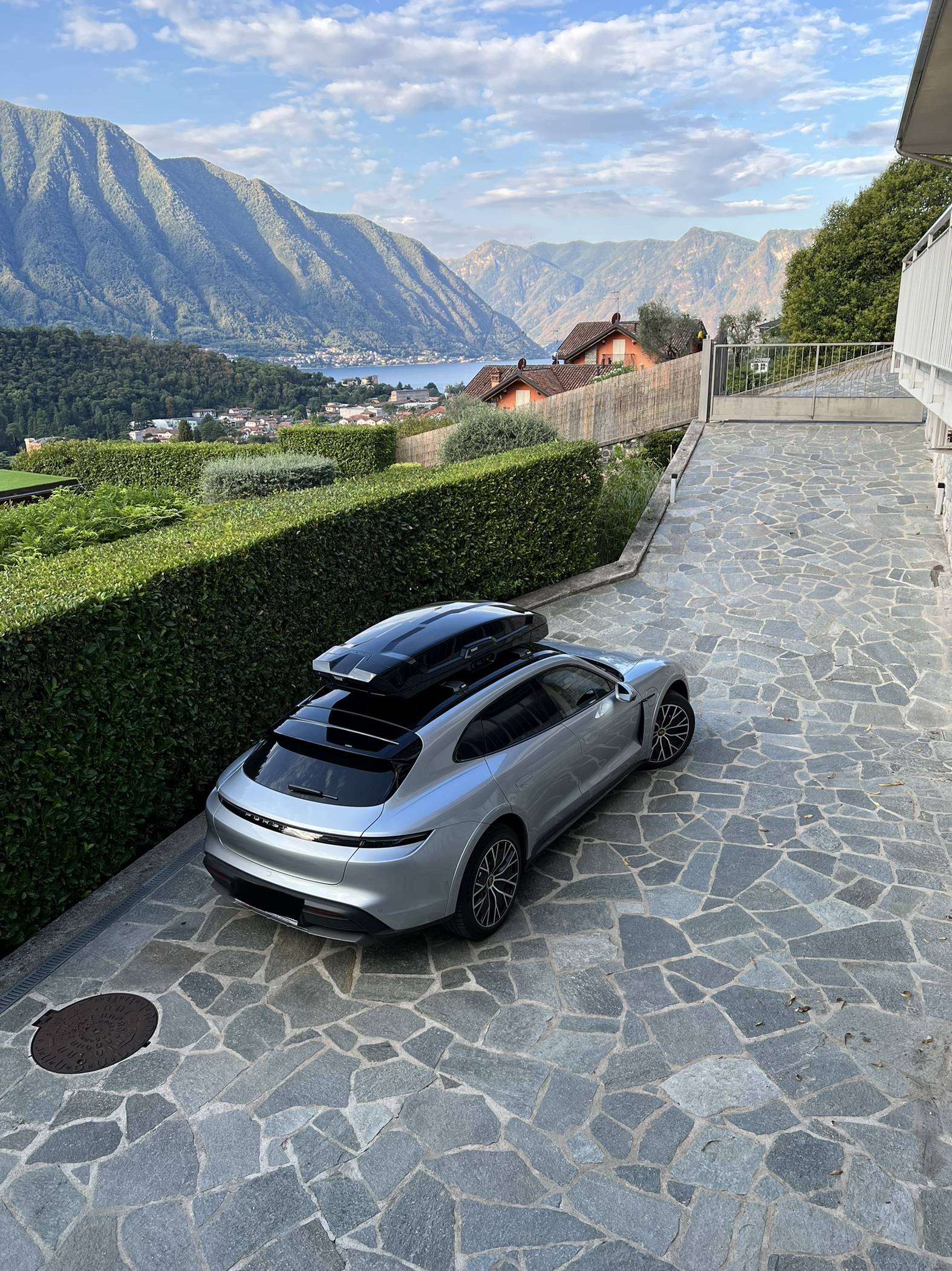

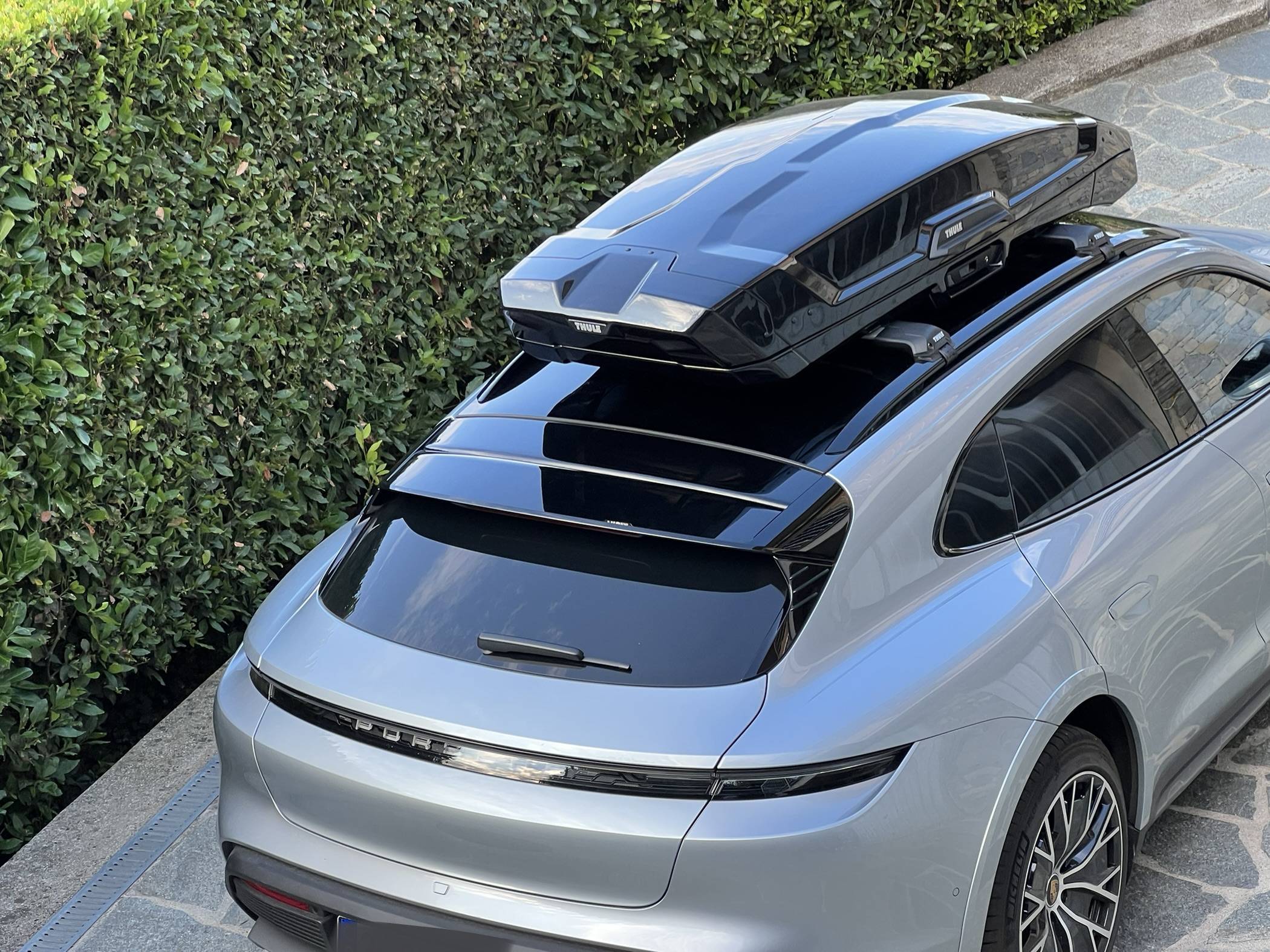

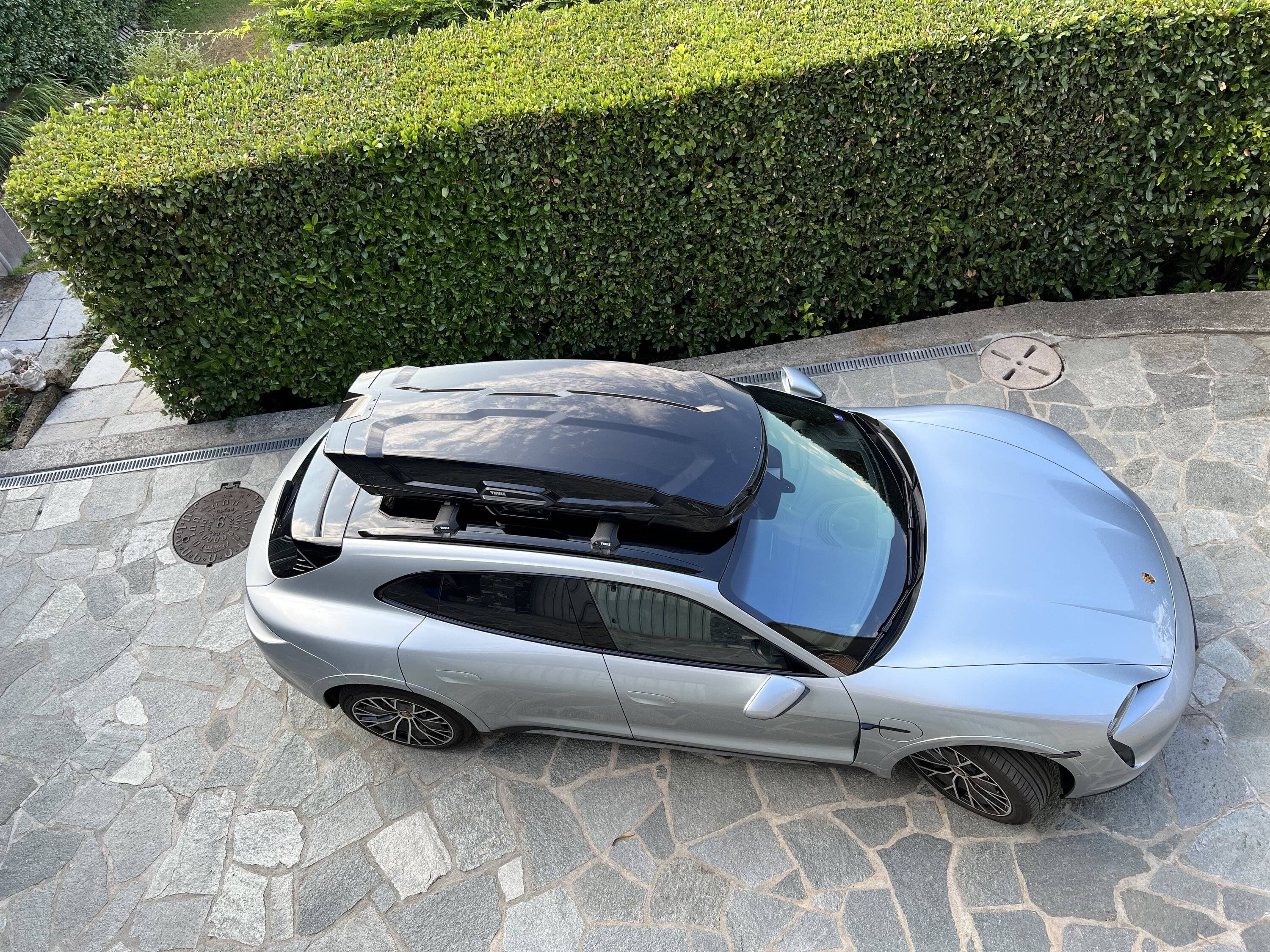

Some pictures of the car and the box around lake Como.
Happy with the CT couldn’t have made it without maximal lift of the air suspension.

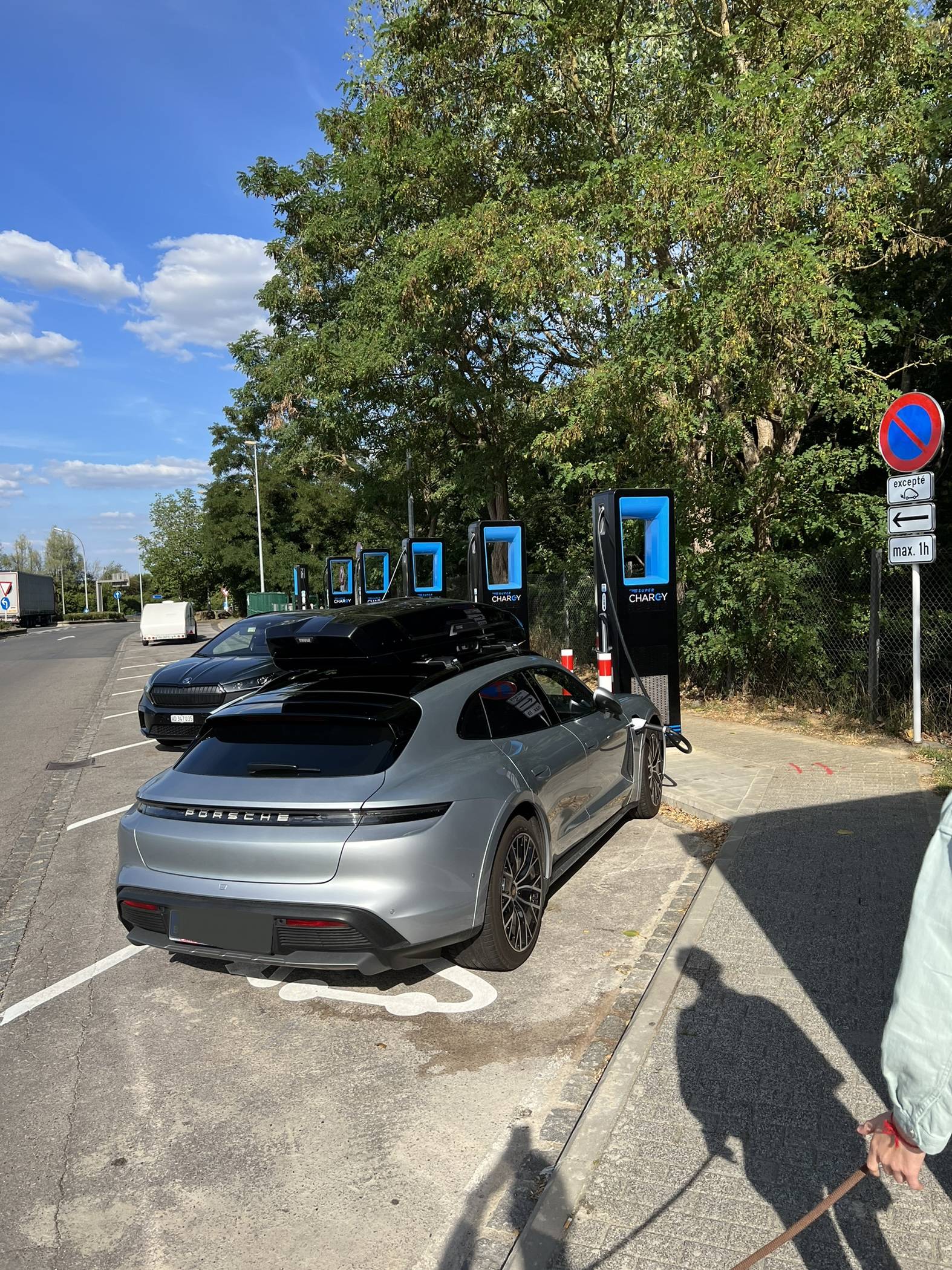

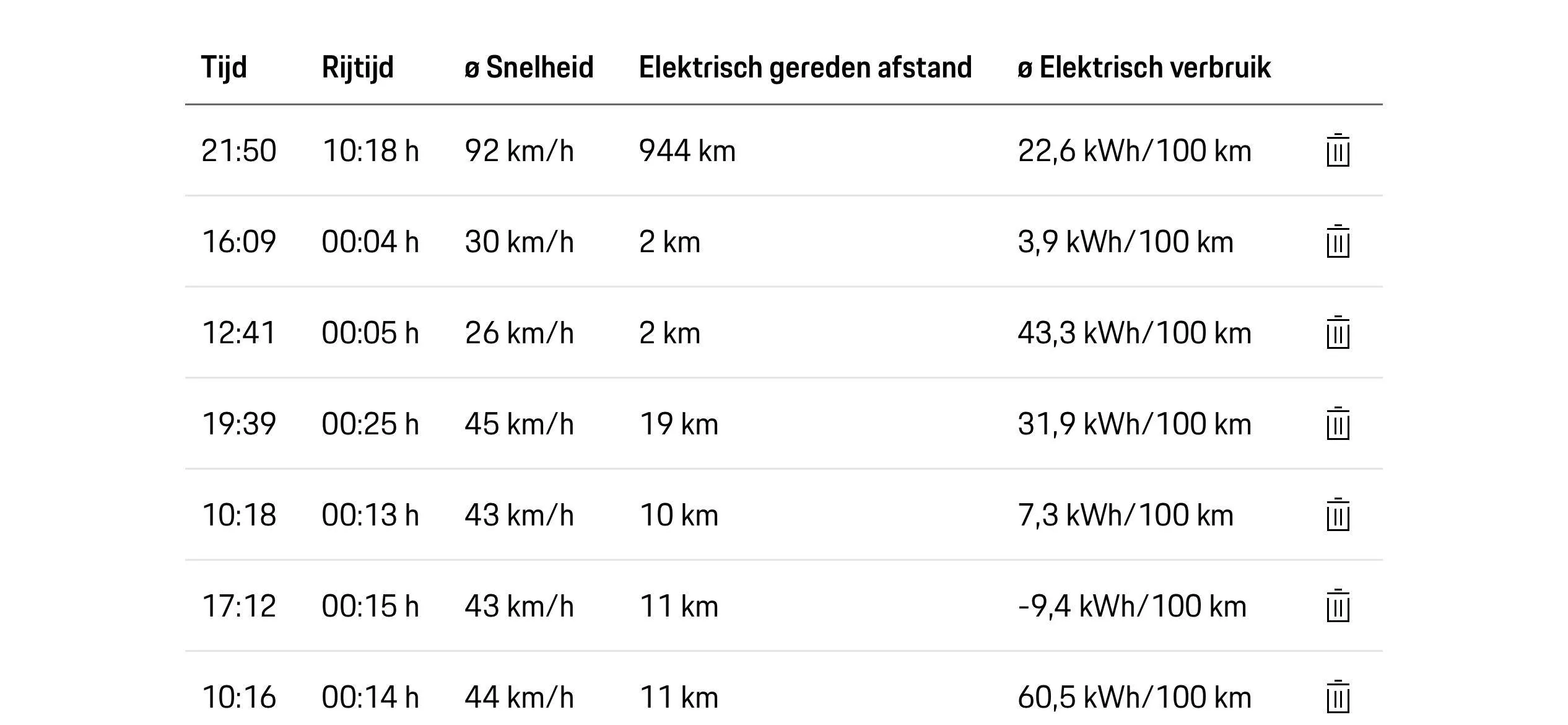

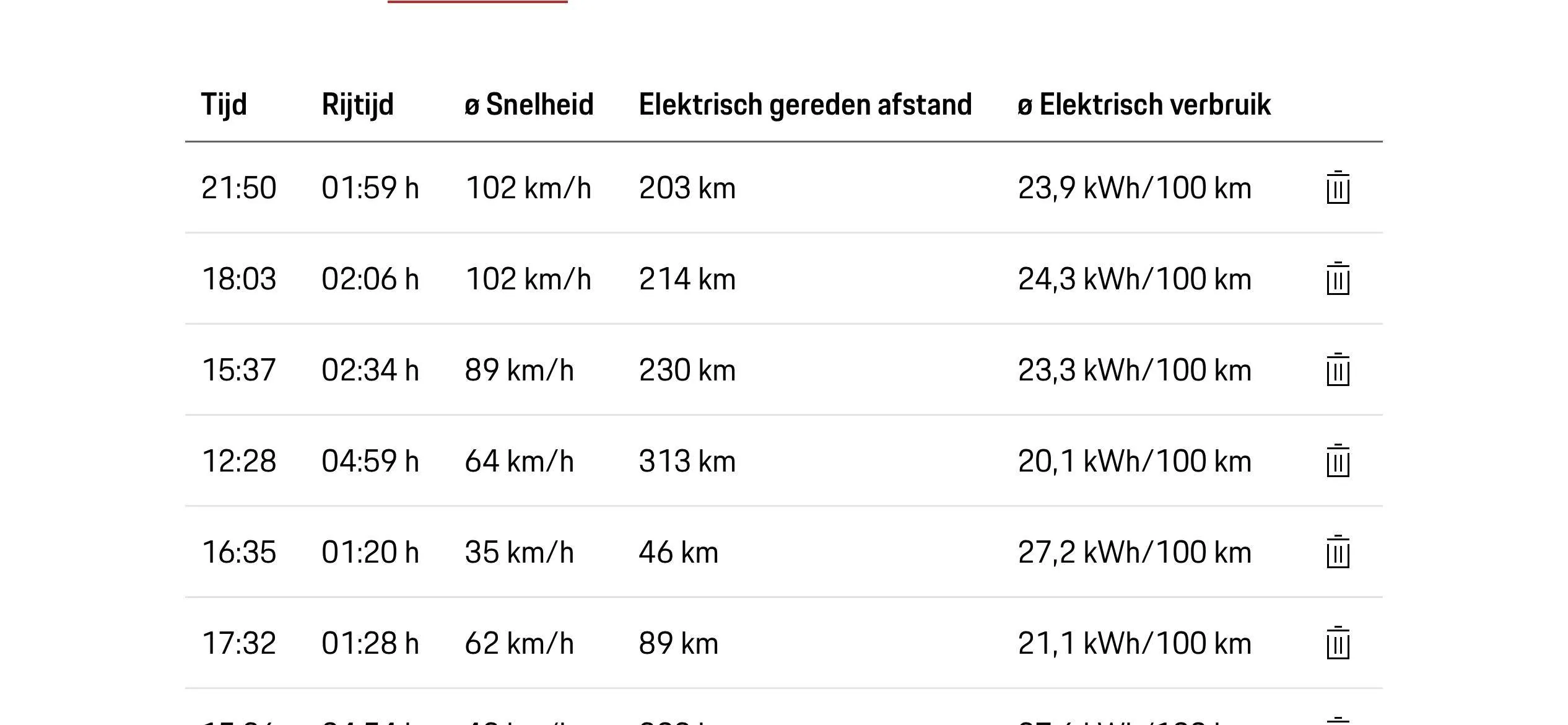

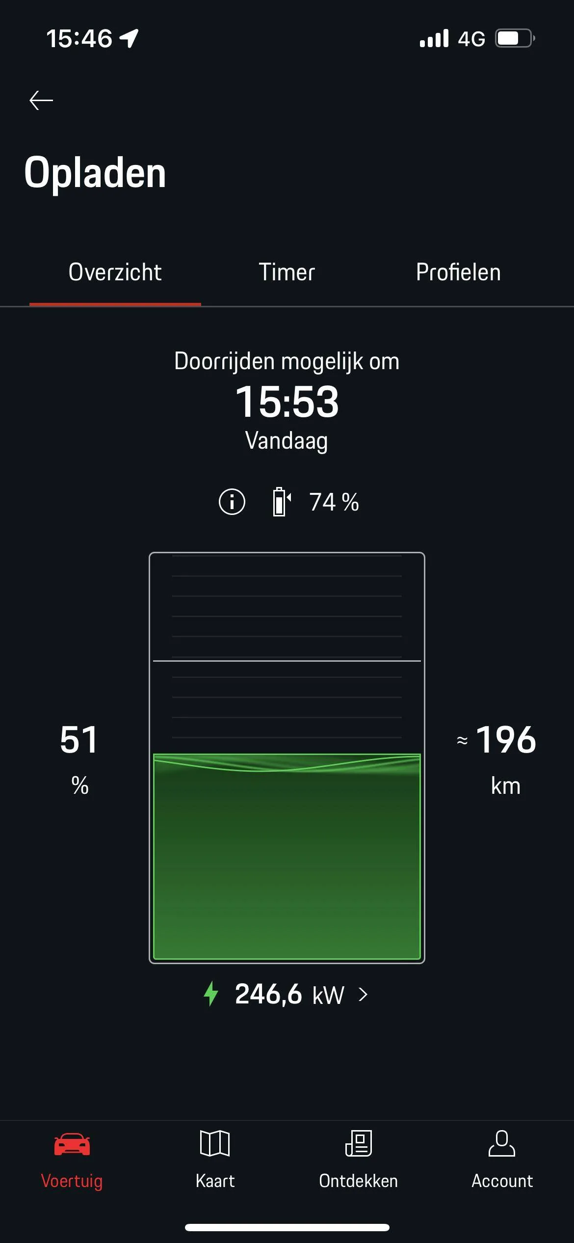

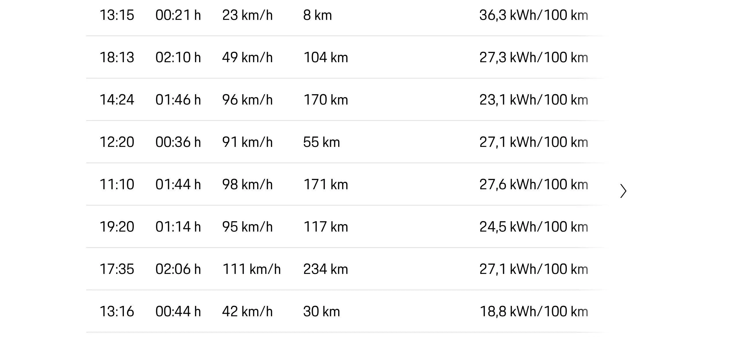

For those interested in the range with the ski box and fully loaded: I drove 944 km today through Austria, Germany and Belgium. Some traffic jams. 30 degrees outside AC on 22 normal mode. I drove the allowed speed or 135-140 when no speed limit. Had to charge 3 times. The first part of the trip was 45 km down hill. I actually gained SoC. Average 22,6 kWh/100 km. Incredible how precise the range estimate is. Even with a long descent, very different speed limits and temperatures, roofbox and fully loaded with luggage and 4 persons it was still accurate.
Today I have driven like I would have with an ICE. The stops were necessary anyway for coffee, lunch and the dog. The stops were longer than charging.
Great charger coverage in Germany. And very fast Ionity charging sessions. 51 % SoC and still 246 kw charging. It was preheated to 45 degrees and 51 at the end of the session.

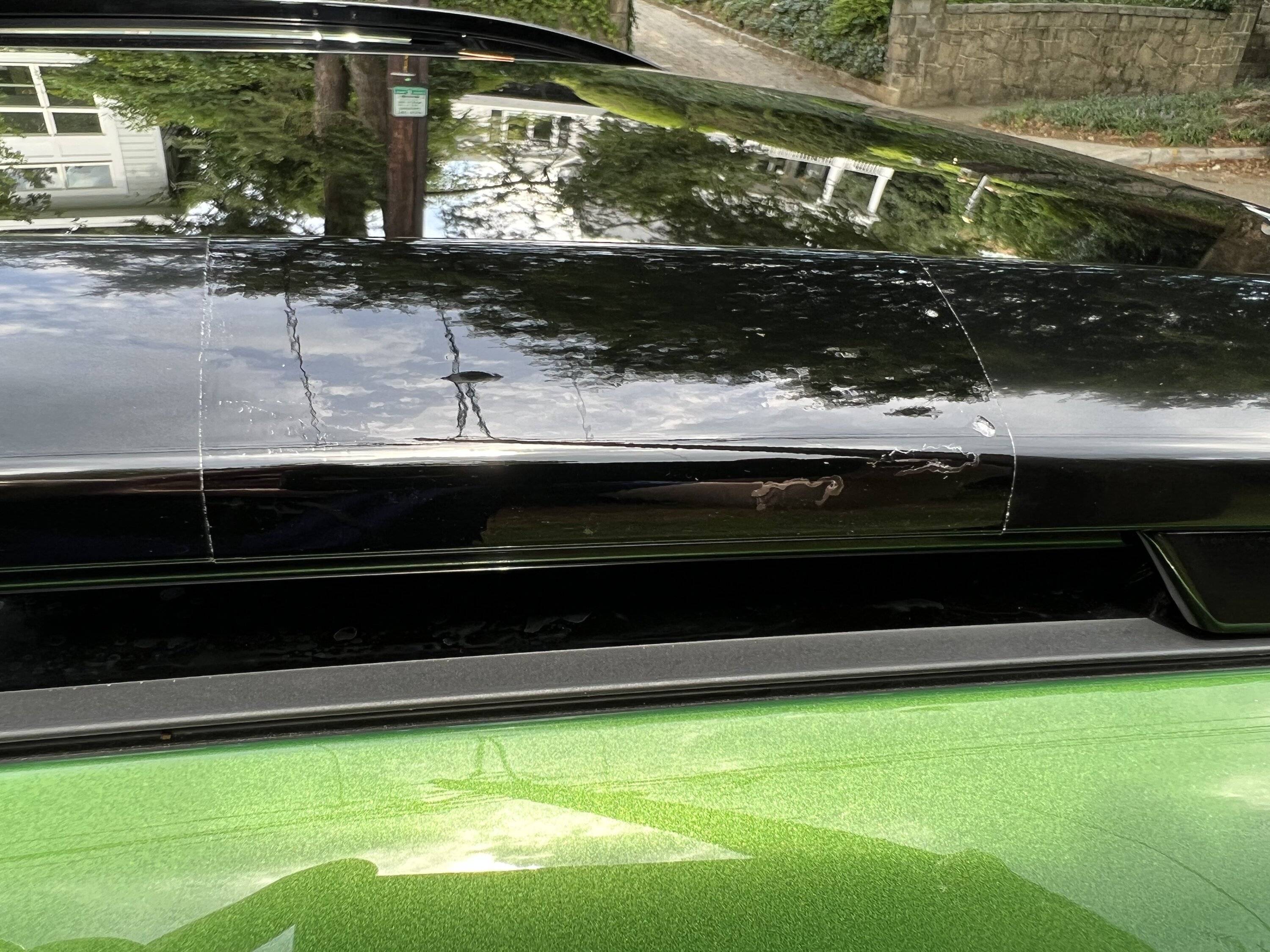

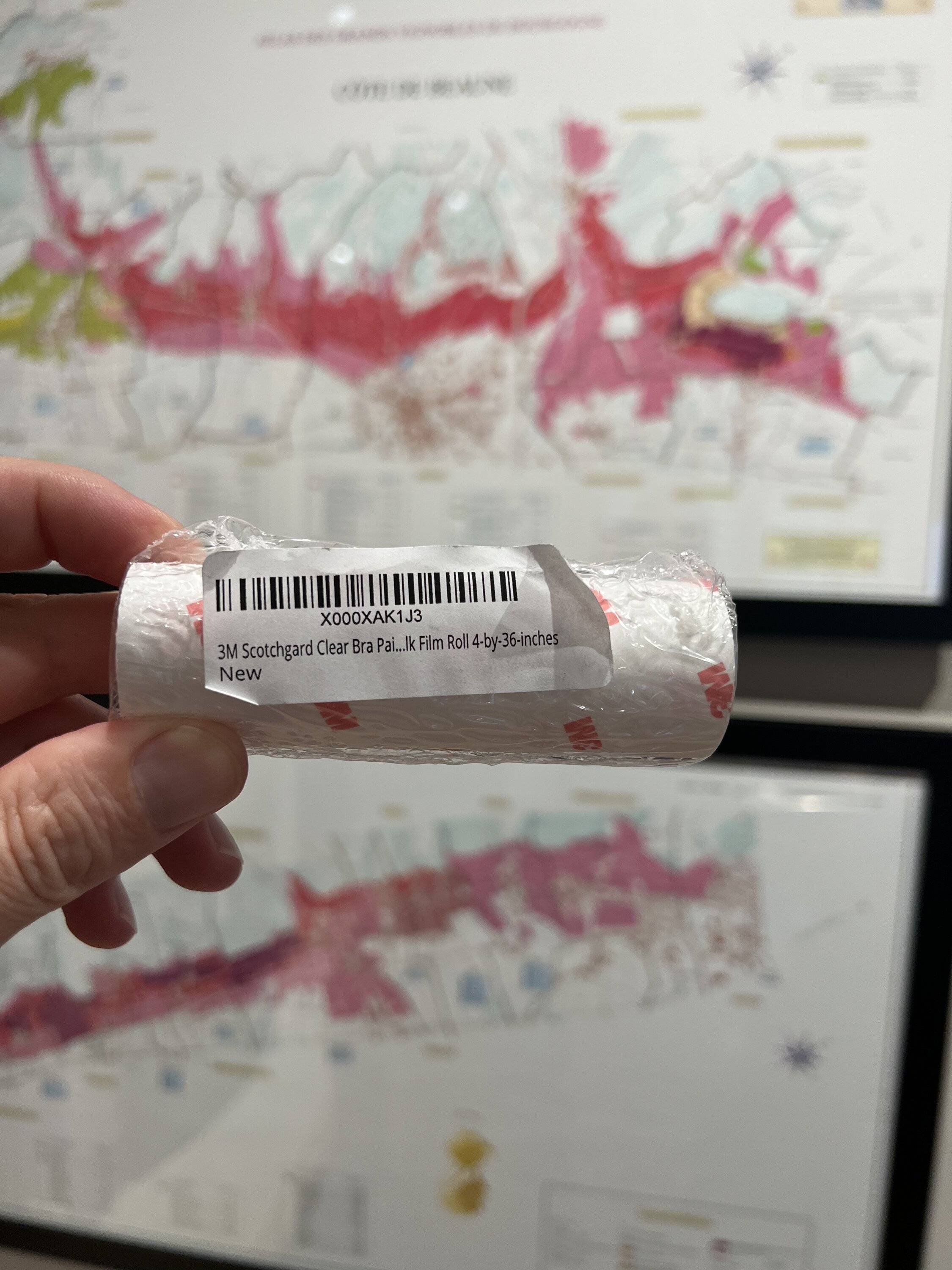

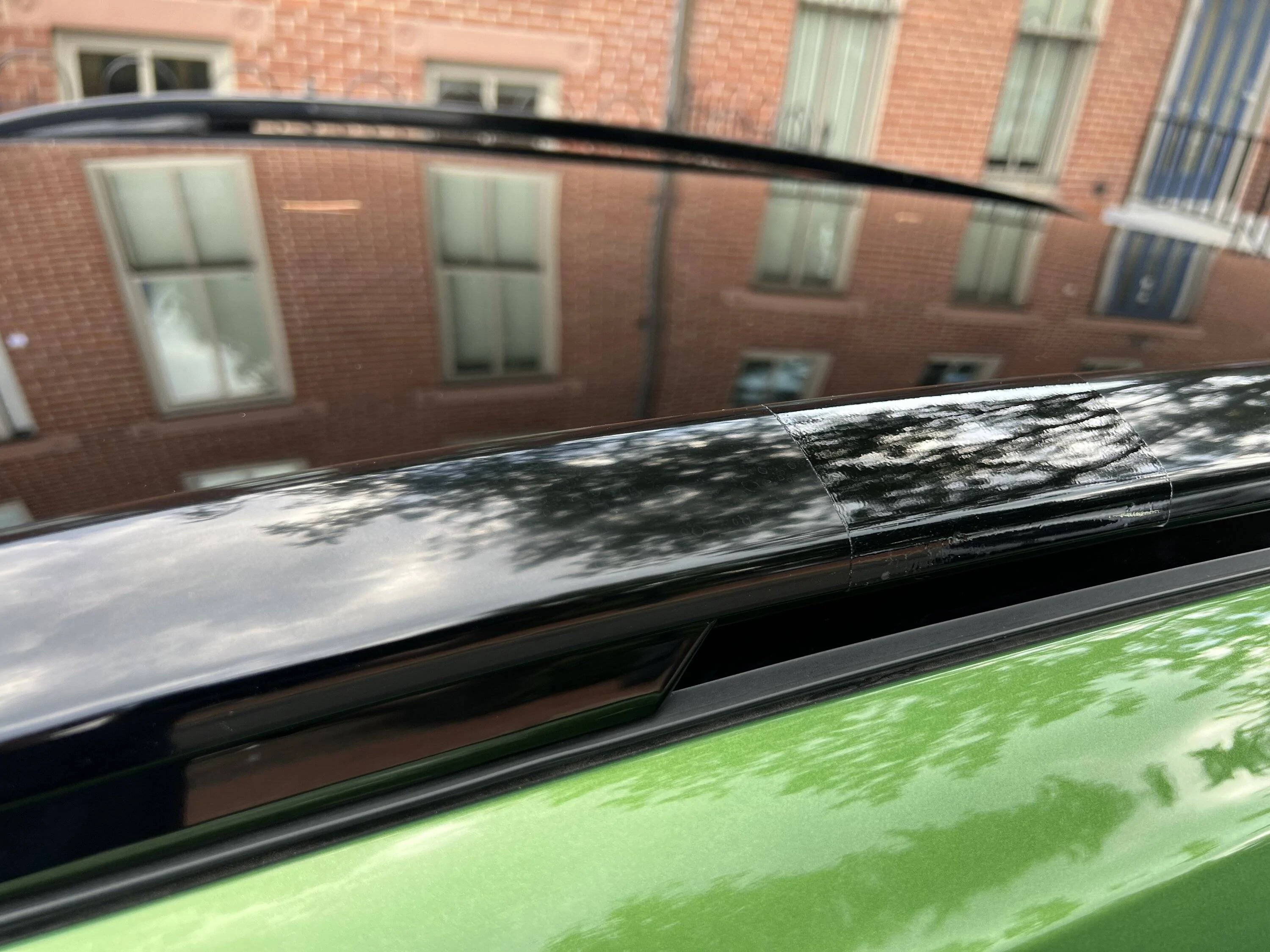

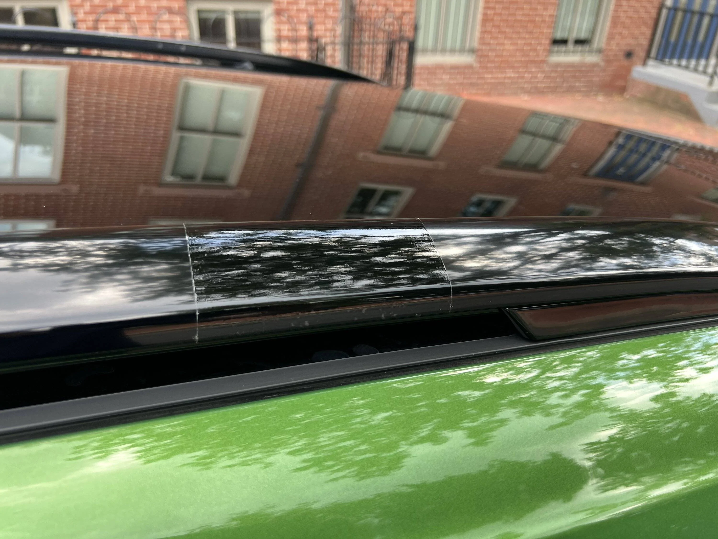

Jesus. What a pain it was trying to install this 3M clear bra on the roof rails. So, my original plan was to wrap the entire roof rail with a 4” strip where the cross bars go. Um, no. The profile includes two notches: one facing the exterior and one facing the interior. I found it impossible to get the 3M clear bra to stick into those recesses. Yea, I’m sure that professionals could make this work but dammit, not me. So I chose to just cut the film and stick it under the recess on inside and outside so that entire visible part of rail would be protected but not the underside. Even that was complicated because the whole thing slides around like snot on shinola. I finally used a little blue tape ro hold it in place.
I came back a few hours later (and after much wine and food) to remove tape to see that a few bubbles had developed under the tape. Gah Dammeh. I know that there are few owners of Porsches, and fewer owners of Porsches who visit Internet forums, and even fewer who are engineers that race cars who are actually type A personalities, but I suspect I may be one of the few because it infuriated me to see the bubbles that had developed. I managed to remove most because, just as in pool/billiards, wine inspired me and enhanced my natural abilities so that I could remove virtually all of the bubbles with a microfiber towel. So, it worked, but moral of the story is that I will never try to install 3M film myself again even in the limited circumstances here because life is just too f@ck#ing short. Now, if my rails get damaged even after all of this trouble . . . :p
in the light of day, looks better than I thought. Only one has bubbles, but probably I’m the only one who will notice. After all this, there is a fair chance that cross bars will damage film anyway (but at least rails will be protected).

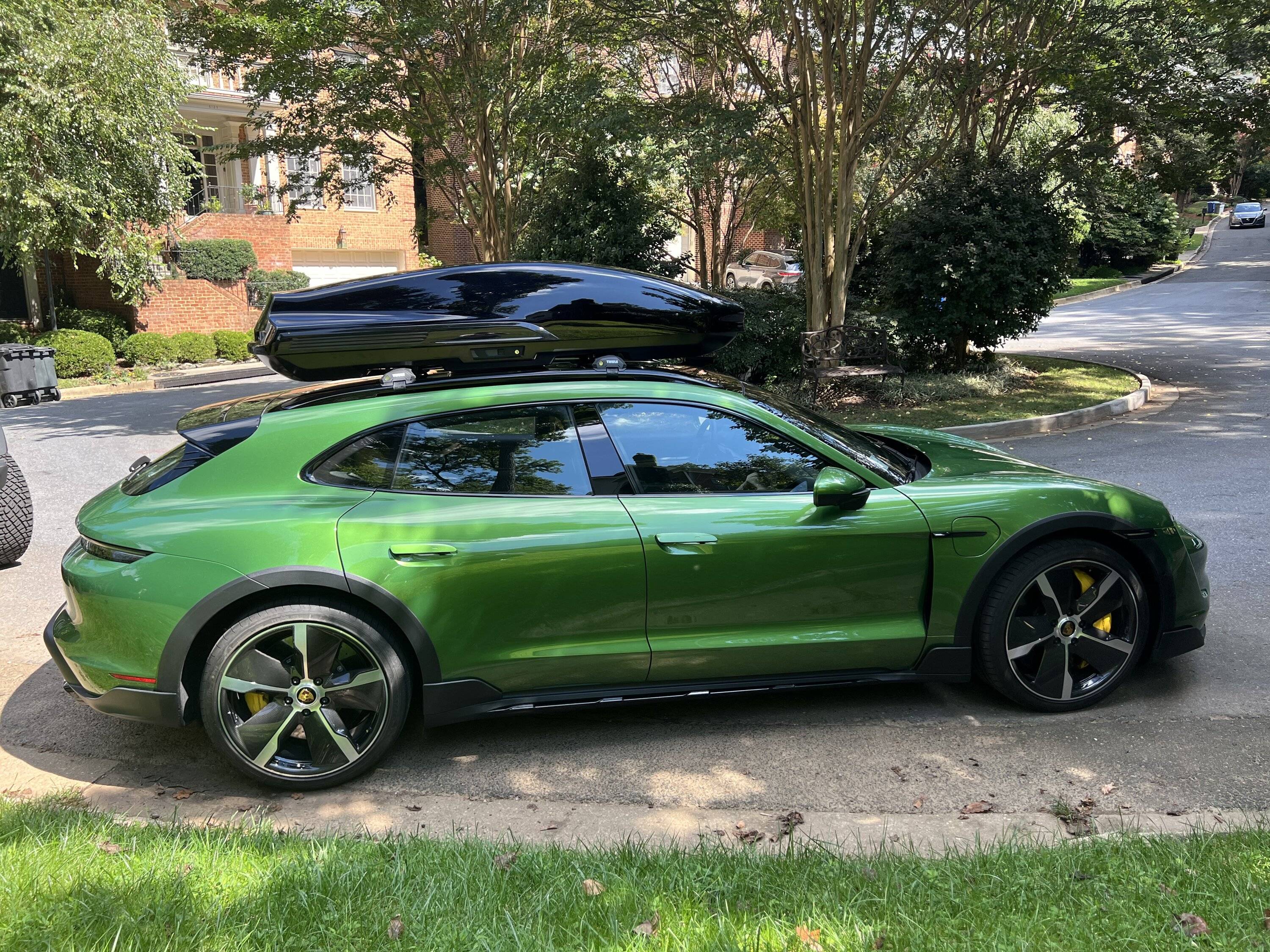

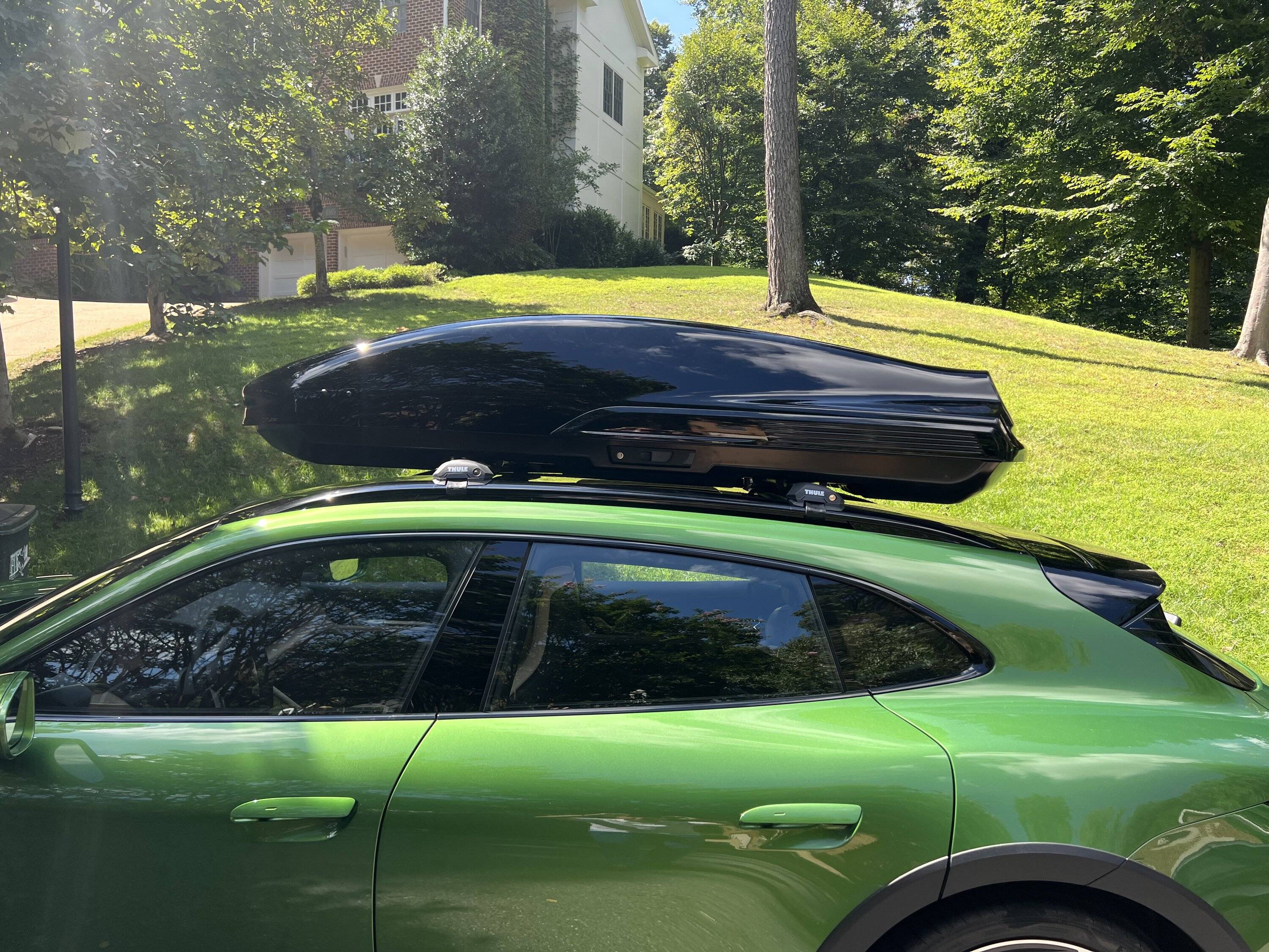

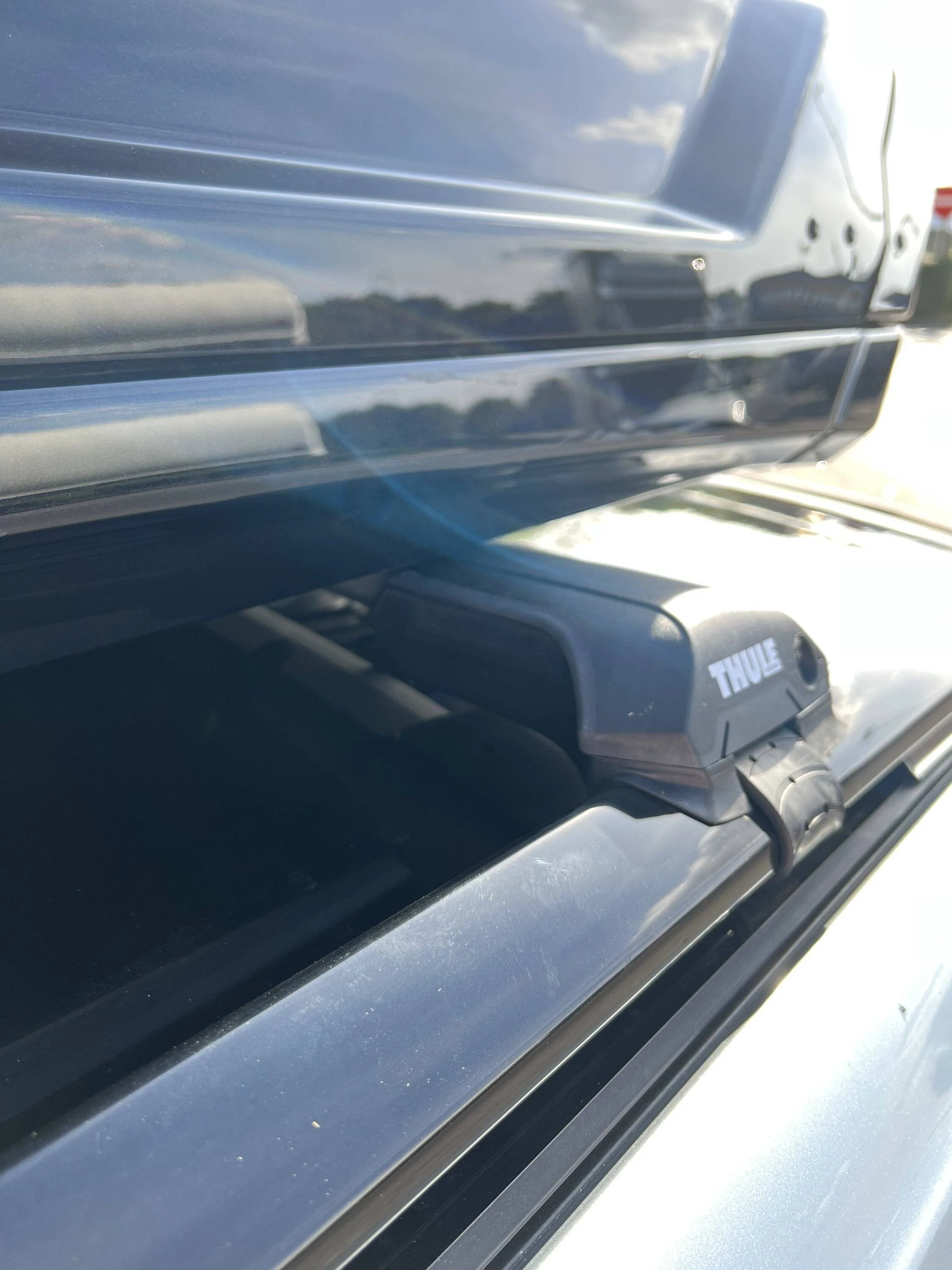

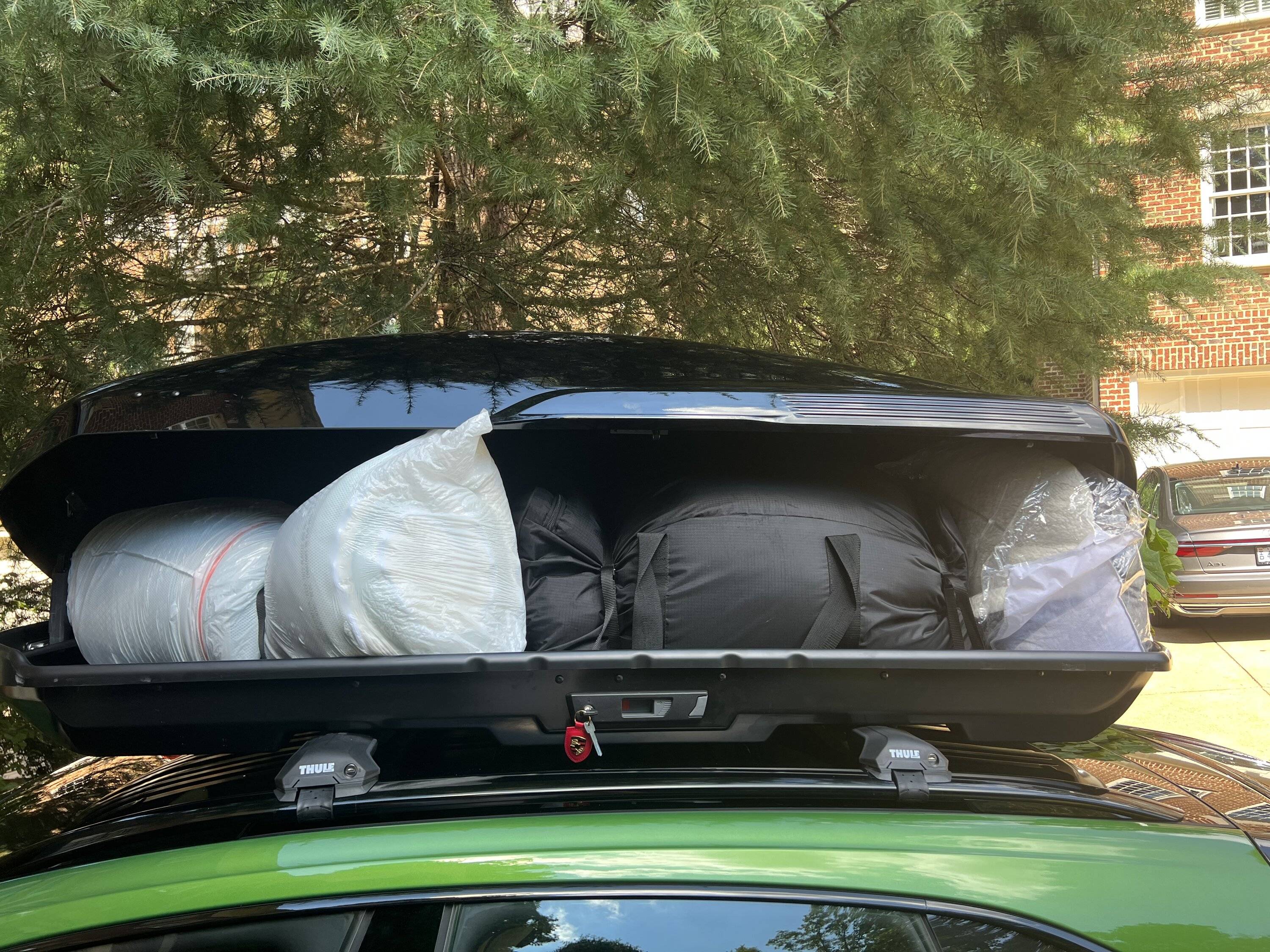

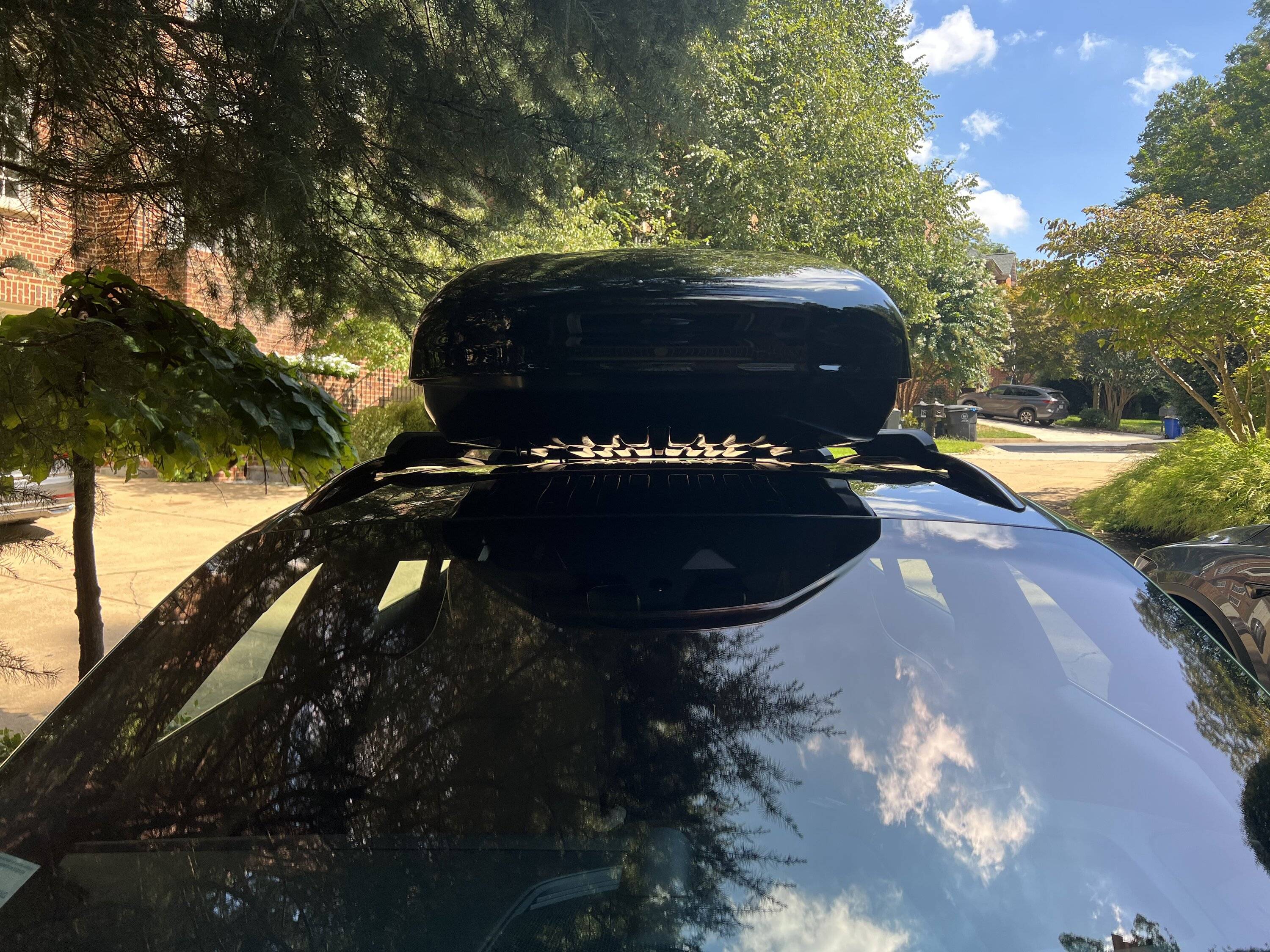

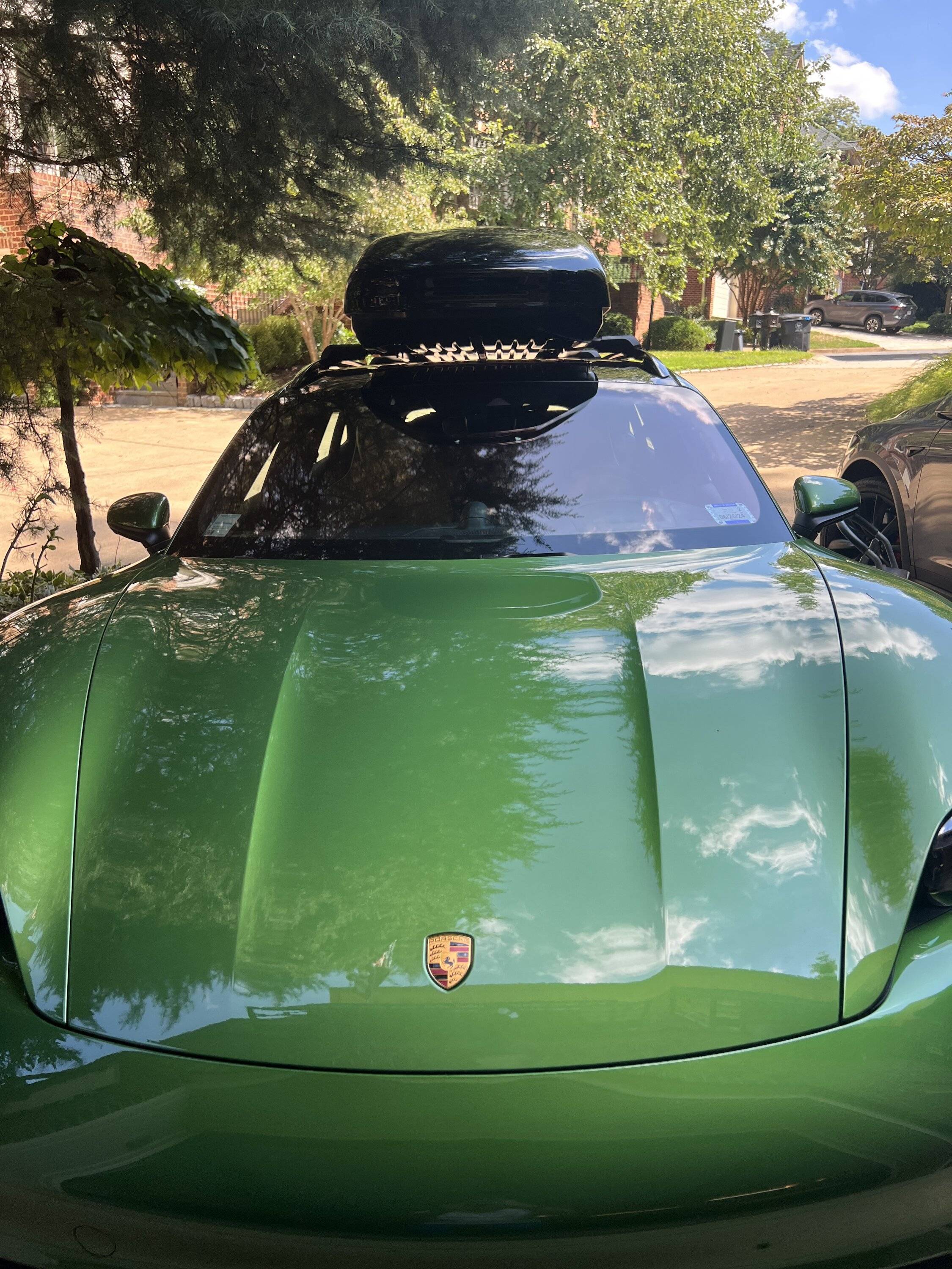

I just finished installing everything. Overall, not too bad.
I was surprised at how much the cross bars move around while trying to tighten them. They would tend to torque diagonally, so I resorted to measuring from nearest end of roof rail (based on trying to put rubber strap between holes), tightening one side completely, then pushing the other side into the same distance from the end of roof rail while tightening.
also surprised that the Porsche Performance box is so wide at the rear that it seems to nearly touch the end caps.
I also wish it were a bit shorter for aero purposes. I tried to move back as far as I could, and even set the rear hatch to open slightly lower, but it seemed like much more would be diminishing returns because still doesn’t allow you to move the box back more.
no worries about claw space. Everything with the Thule cross bars looks like it was designed for Taycan with precision.
super glad I put on clear bra at strap points, although I recommend 6” wide rather than 4” inch wide so it covers the entire rubber foot.
double check end caps because four were super tight and secure, while one popped off when I brushed against it, so must not have been locked in properly. It was fine after I reinstalled.
I was slightly annoyed that I seems to have scratched the box slightly right above the driver door so I have to see it EACH TIME I enter or exit door. Why couldn’t it have been over rear passenger door so I could forget?
I’ll post pics of clearances tomorrow.

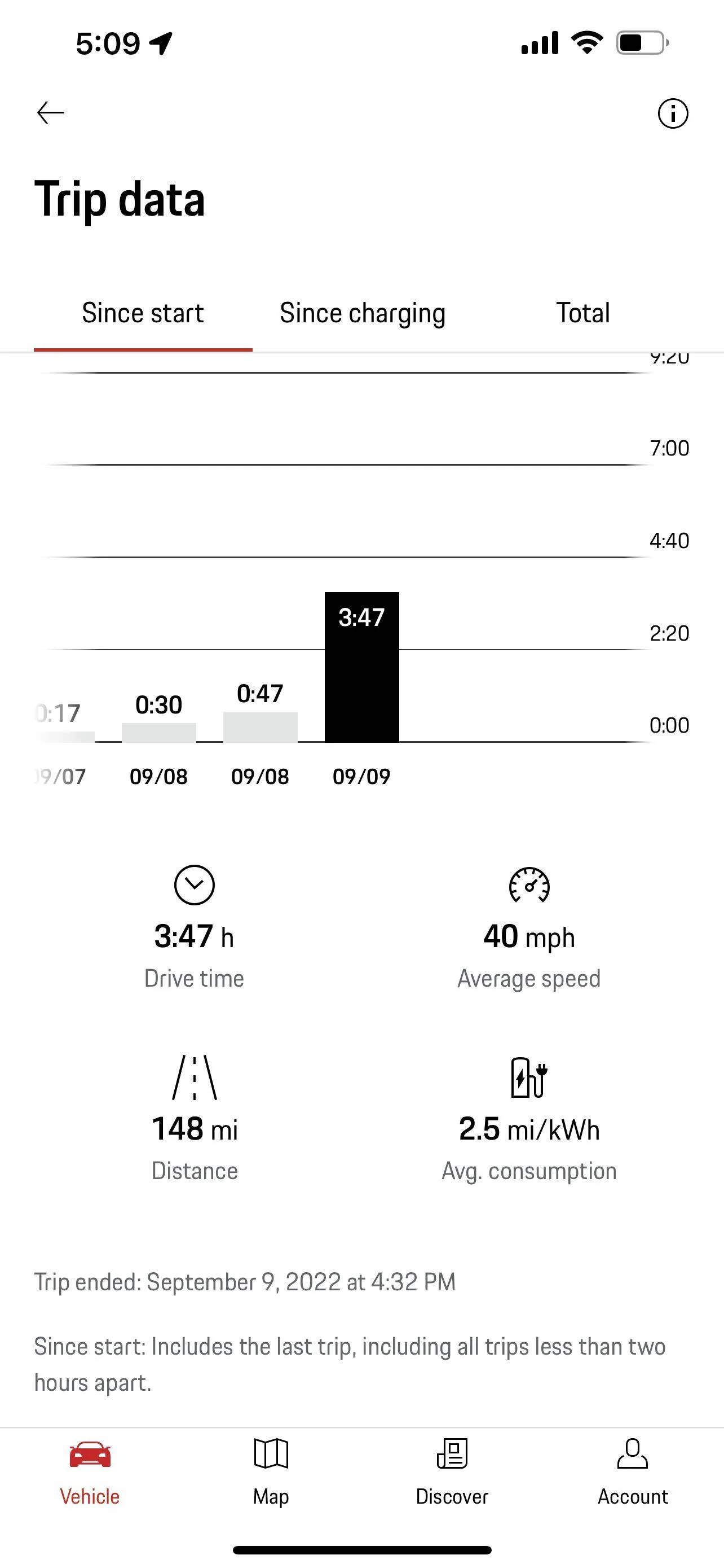

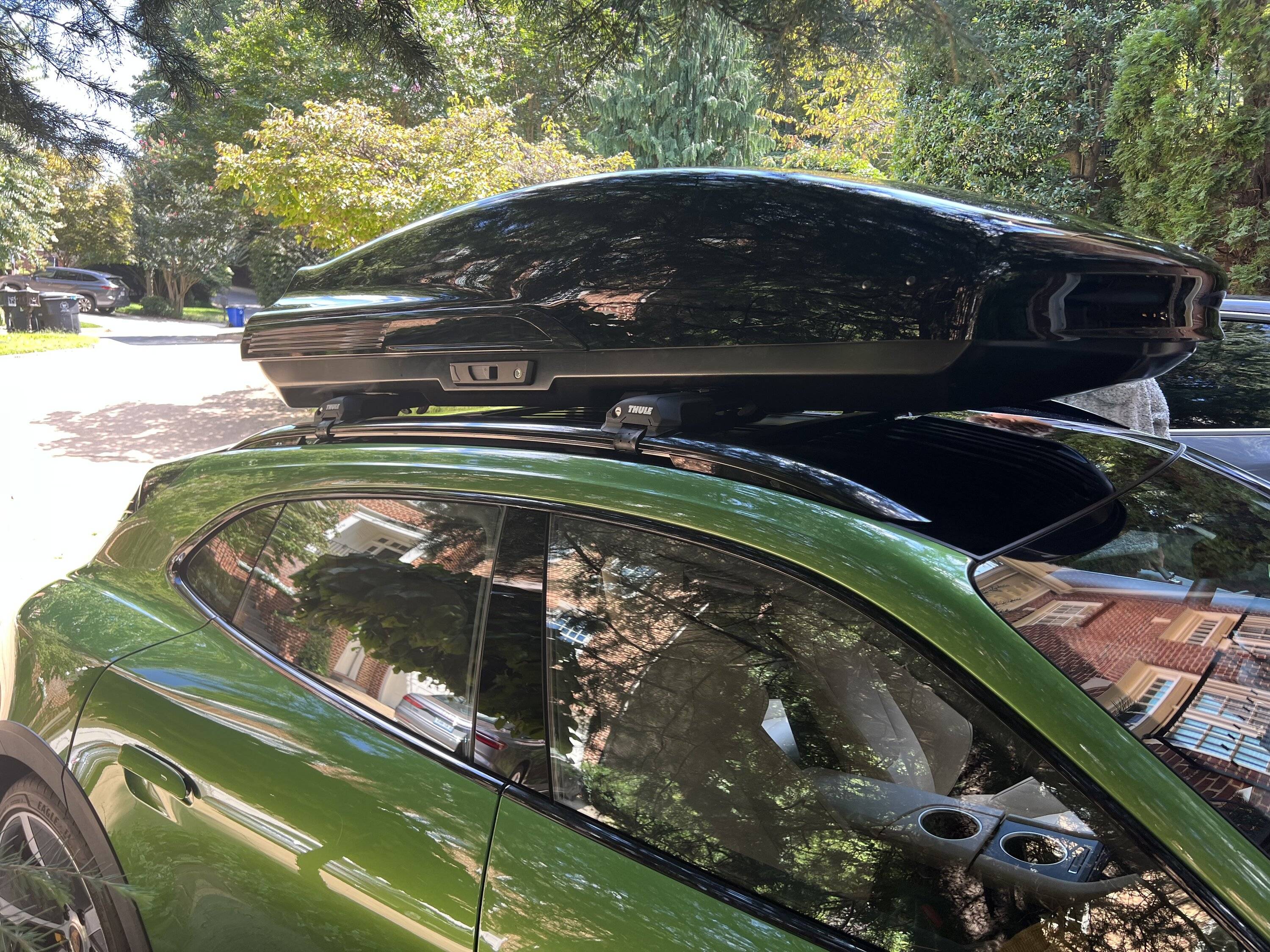

Mid-trip update while stuck in traffic jam due to wreck. Virtually no noise from the box all the way up to 90 mph. I’m impressed.
Now that I have arrived, I’m pleasantly shocked to learn that my consumption was nearly identical to my last road-trip without the box

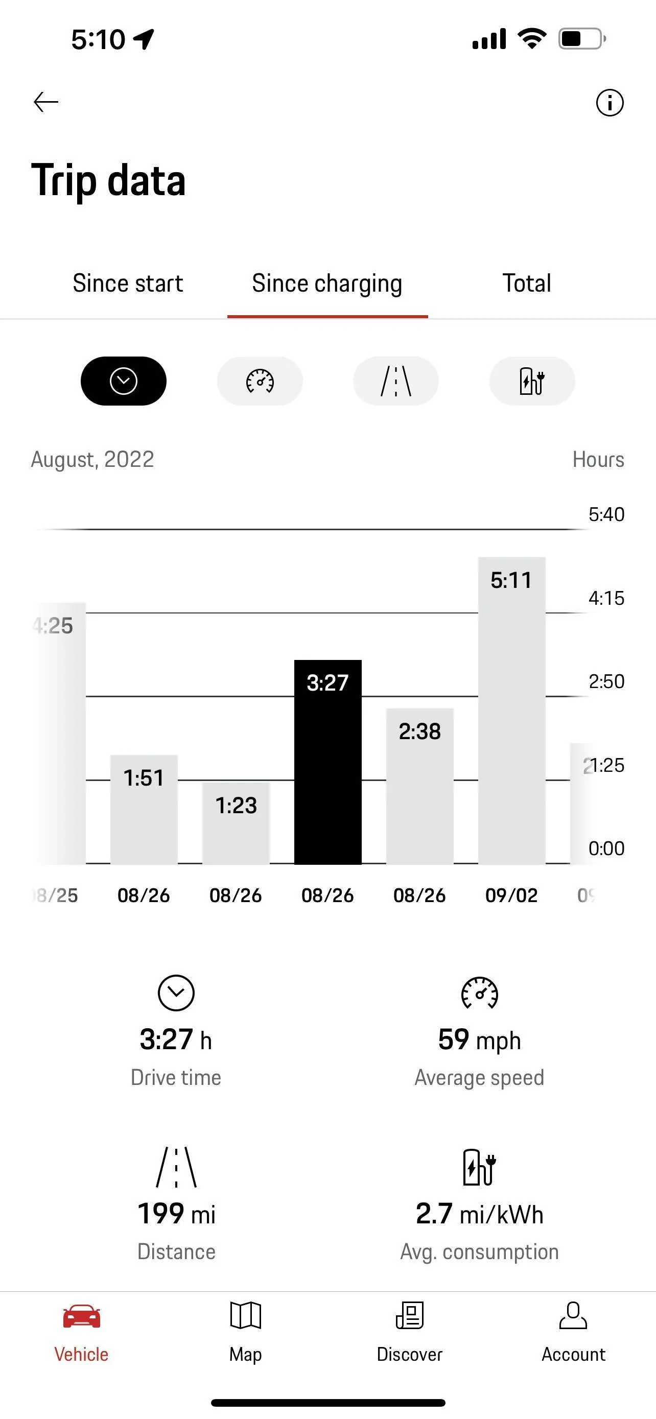

For those of us who are math challenged, my consumption with the Porsche Performance Box and a full car (avg. 40 mph/65 kmh for 148 miles/238 km) was 2.5 mi/kWh, which equals 24.85 kWh/100km.
By comparison, a somewhat similar recent trip without the box (avg. 59 mph/95 kmh for 199 miles/320 kmh) was 2.7 mi/kWh, which equals 23 kWh/100km.
So, although the trips weren't fully equivalent (I got stuck behind a wreck for 45 min on the trip with the box), I took about a 7.4% efficiency hit, which isn't too bad considering the benefits.
