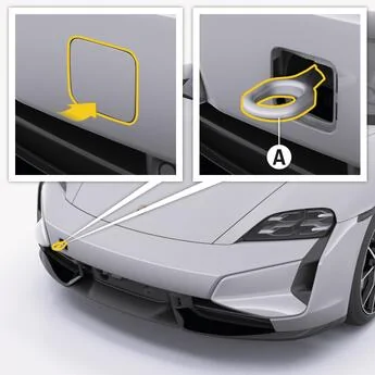

What does the towing hook look like? Should I have one that came with my 2021 Taycan?
I think it's actually called towing lug. It's in your frunk on the left side. Check your car's online manual and search for "Using towing lug".
Ahhh! That makes sense. I’ll have to find it and put it under the seat with the folding wheel chocks I’m going to order on Amazon for $7.99 which I’ve purchased for my other vehicles in the past.
