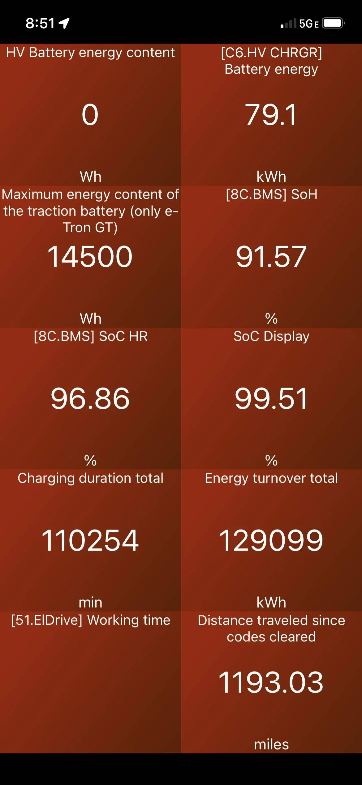

I have had exactly the same problem you initially had, with the replacement of two modules. My battery capacity is down to 79kWh at this point, and I'm being told that it will take three weeks of charging from 10-15% to 100% for the battery to 'adapt' to the new modules. Did you have this same experience? i.e. did you see minimal improvement with the replacement of the two modules, and did you see your battery capacity improve over time? I'm a bit skeptical here, but I will defer to the experts and follow the recommended charging protocol. Here is the text from the technician, after I was told to charge/discharge from 10-15% to 100% three times, but evidently it needs three weeks:
Our last correspondence we all agreed that he would follow a specific discharge and charge cycle for 3 weeks. The capacity adaption will not be complete after 3 drives. It takes time for the new capacity to adapt after introducing new modules into the rebuilt battery.

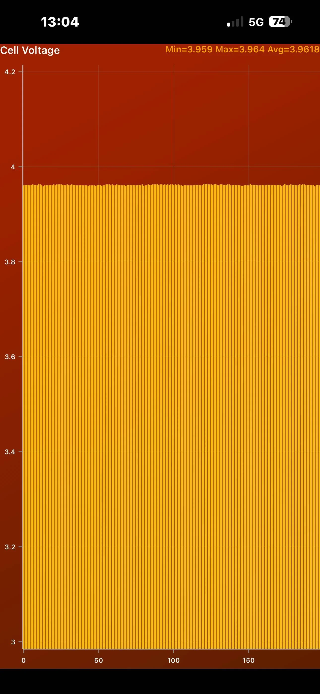

Well, it's been about a 4 month journey, but the replacement of my two battery modules seems to have worked. I've been following the 'balancing' protocol outlined by the Porsche battery technician, and it works - my battery is now back to 'good as new', or possibly better, after the module replacement. I was getting 236mi on 85% charge before this all started, and today (in the winter vs summer), here's my reading (all at normal setting)::like:
