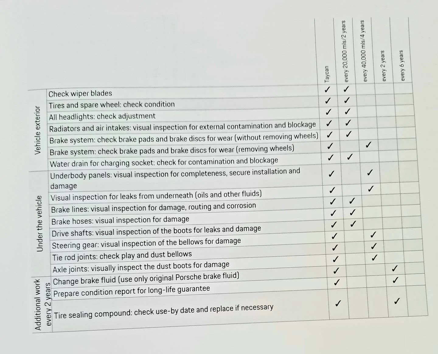

So what’s this BS about the mandatory drainage test listed by Porsche UK in their extortionate service plan? Very fishy.

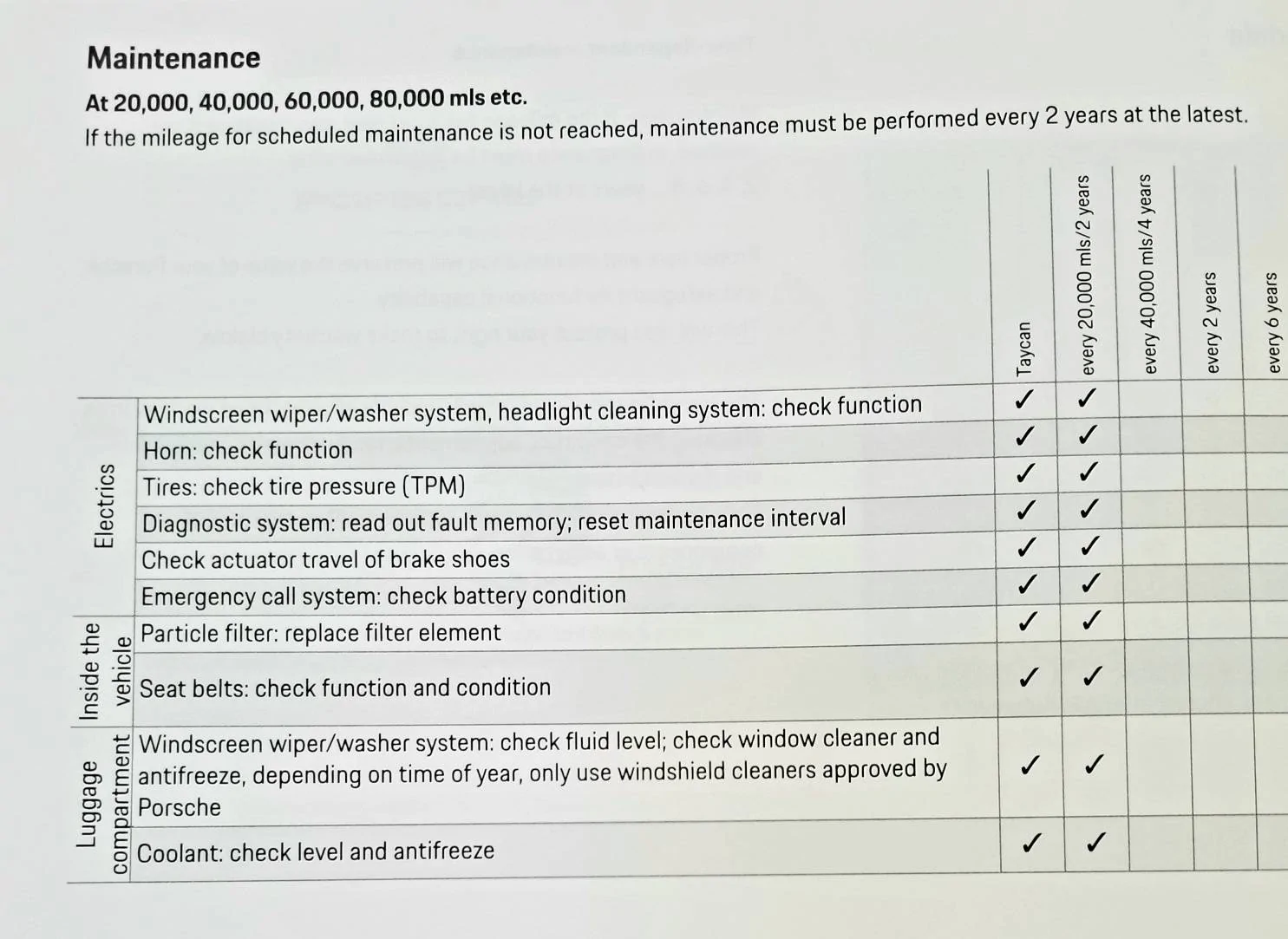

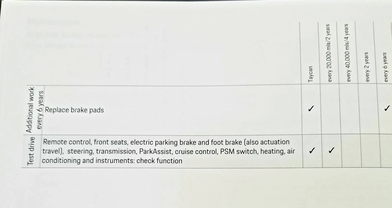

Here are images of the checklist from my Taycan's Maintenance manual (US).
Perhaps it is the "Water drain for charging socket: check for contamination and blockage" on the second page.
