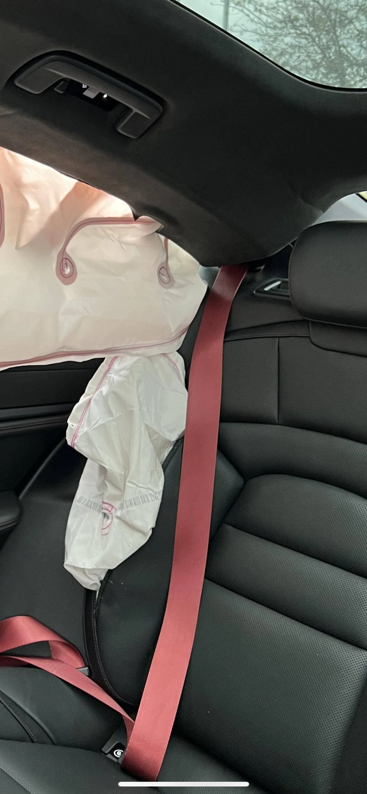

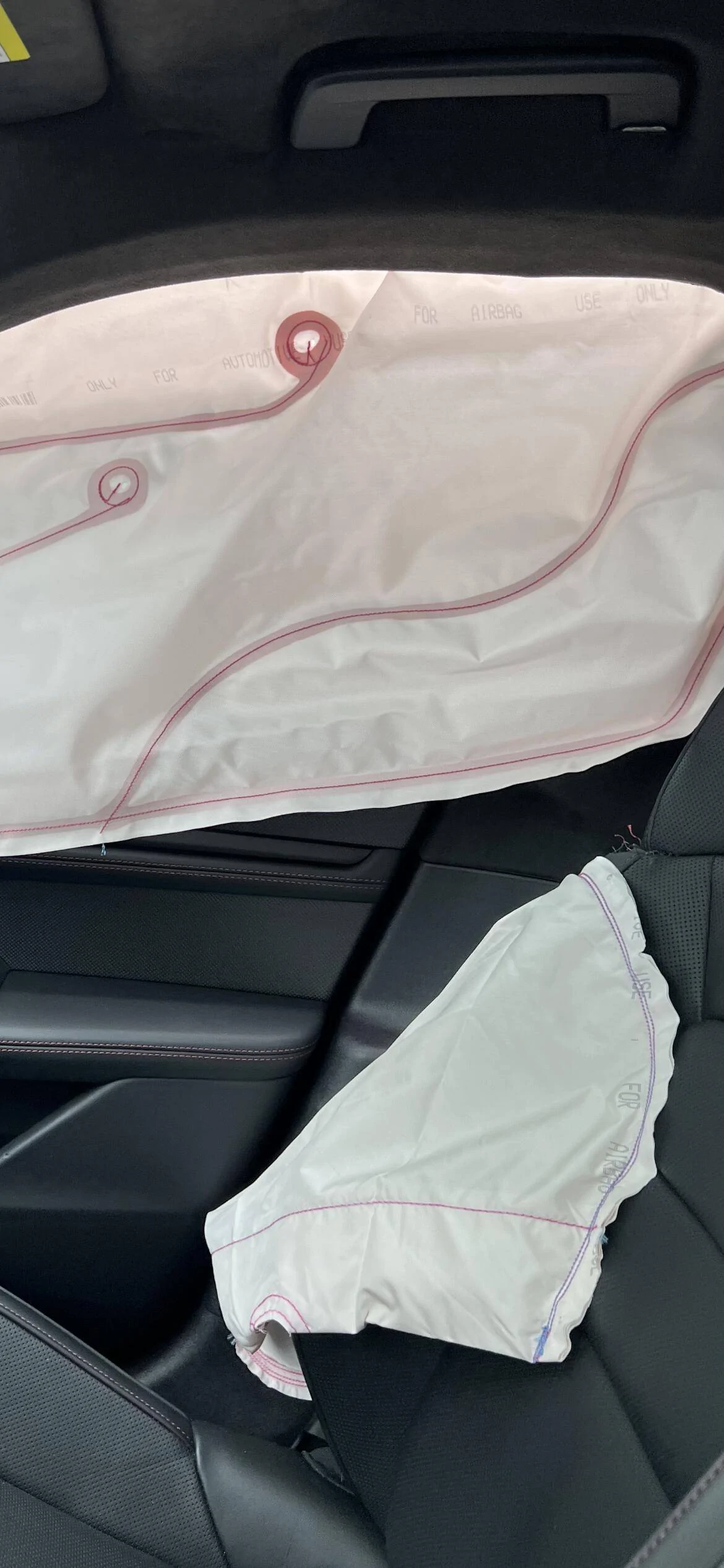

Thanks everyone again for the insight.
One thing I noticed in some of the photos is the airbags caused the stitching to come undone in the front passenger and back passenger seats. If the seats have to be replaced with red deviated stitching, this sounds like a pretty expensive part to replace.

driver69
Oct 15, 2022
147
179
Ukraine
Taycan Turbo S 2021
- Hood/Bonnet
- Bumper
- Fender/Wing
- FR Matrix (or is it just LED?)
- 4 Rims (Because Porsche won’t sell you just one)
- Airbags
- Stitching and whatnot
- ? Suspension
- ? Steering rack
- ? Internal cooling system (there’s a lot of piping at the front behind and in front of the motor)
- ? HV Battery
To me personally it looks like a total loss.
