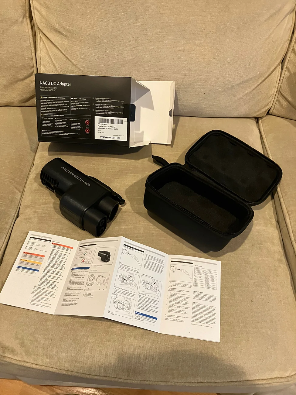

I'm in Massachusetts (USA). After I'd been checking roughly every other day for a couple of weeks at the Porsche USA and the Suncoast websites for availability of the new Porsche NACS DC adapter -- to no avail ("sold out") -- I decided to just call the parts department of my closest Porsche dealership. They had them in stock! So I ran over to buy one immediately ($185 USD + tax). I then drove to the nearest Tesla supercharger station a couple of miles away, to test it out (Burlington mall). The EA DCFC station was full, as usual, but there were several empty spots at the Tesla site. I had 60% SoC so wasn't going to charge much -- just wanted to test out the new adapter. I already have had the Tesla app on my iPhone because I've been occasionally using Magic Docks at select locations; I went to my vehicle page, and saw that there's now an option to click for NACS adapter, and once I clicked that, the app showed the Burlington mall site (which previously was invisible to me on the Tesla app due to its not having Magic Docks cables).

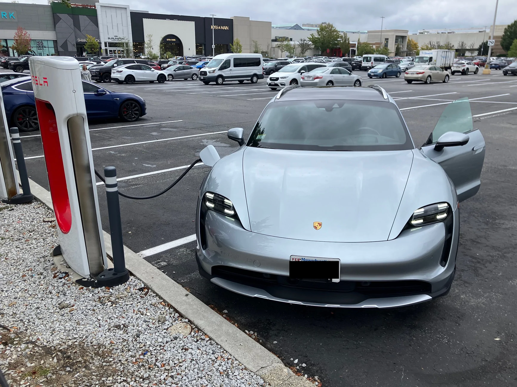

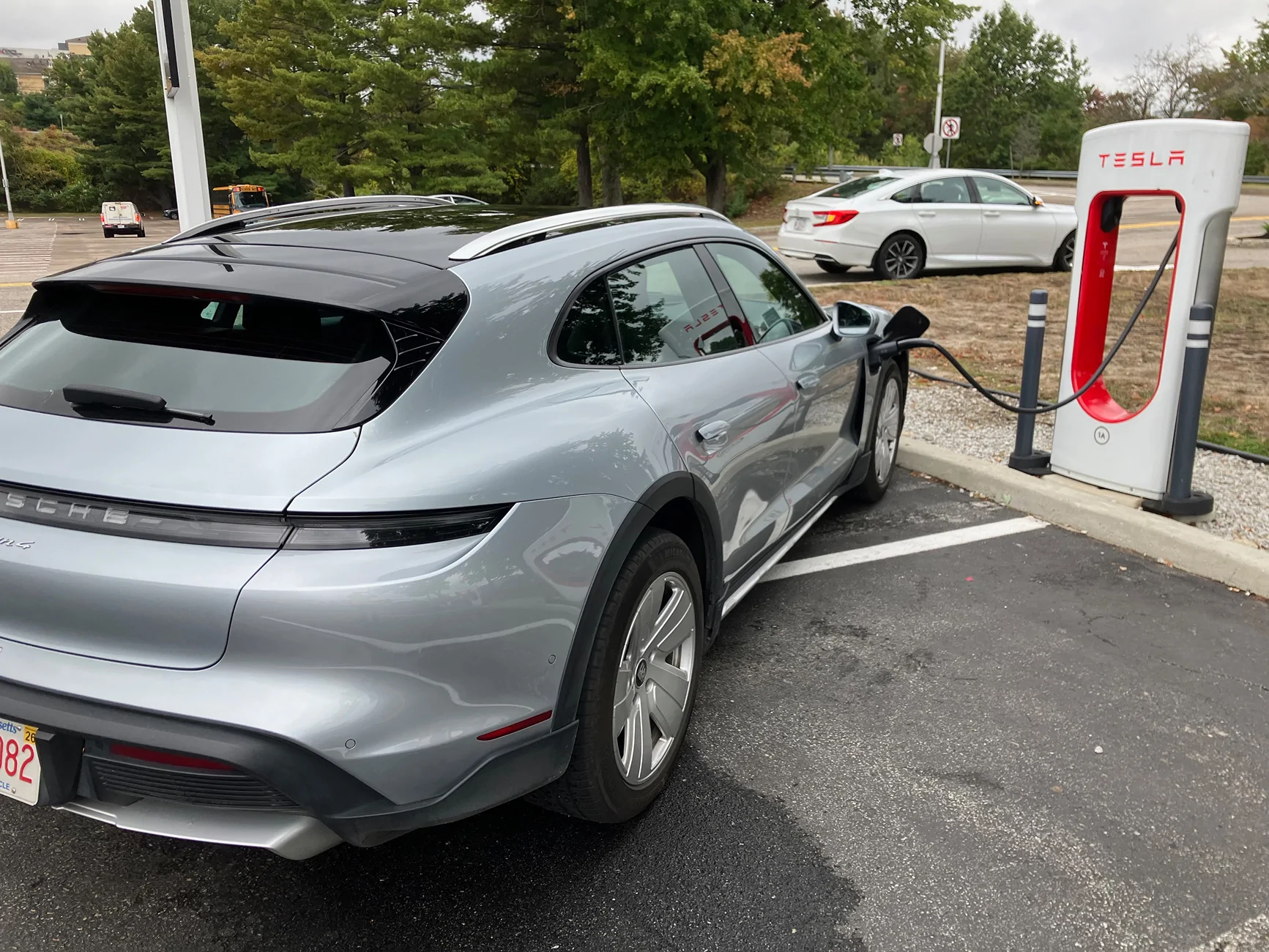

I had to park at an angle as usual (see photo below), taking up two spots, but it wasn't a problem because (a) there were numerous open spots and (b) I wasn't staying long -- because the cable was too short for straight-in parking (as usual at Tesla stations for our Taycans). At the angle that I parked, it was an easy plug-in; I first put the NACS plug into the Porsche adapter after selecting the Burlington-mall Tesla site in the Tesla app, then plugged the adapter into my CCS port, then clicked on "start charging" in the app, and all worked fine. See other photo for what comes in the box with the Porsche adapter. The instructions say to do what I did: NACS plug into adapter first, then adapter into car port, then start charging via app; after stopping, push the button on top of adapter to pull out from car, then push button under adapter to release NACS plug from adapter.
Nice to have this extra option, even though I'll use Tesla superchargers only in emergencies due to the short cables, the pain of using an adapter, and the slower charging speeds (I got 95 kW max at 60% SoC, which isn't bad with cold battery and battery-health feature turned on). I am guessing that dealerships have NACS adapters on hand because they are given out free with their new cars; I thought this news might be useful to some on this forum who might not have thought to contact their local Porsche dealership parts department.

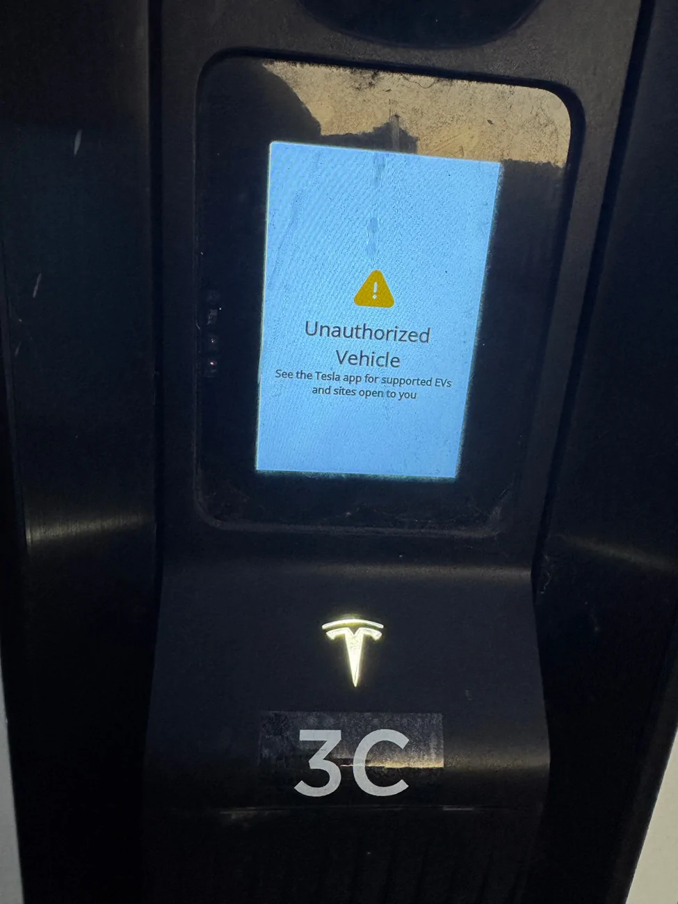

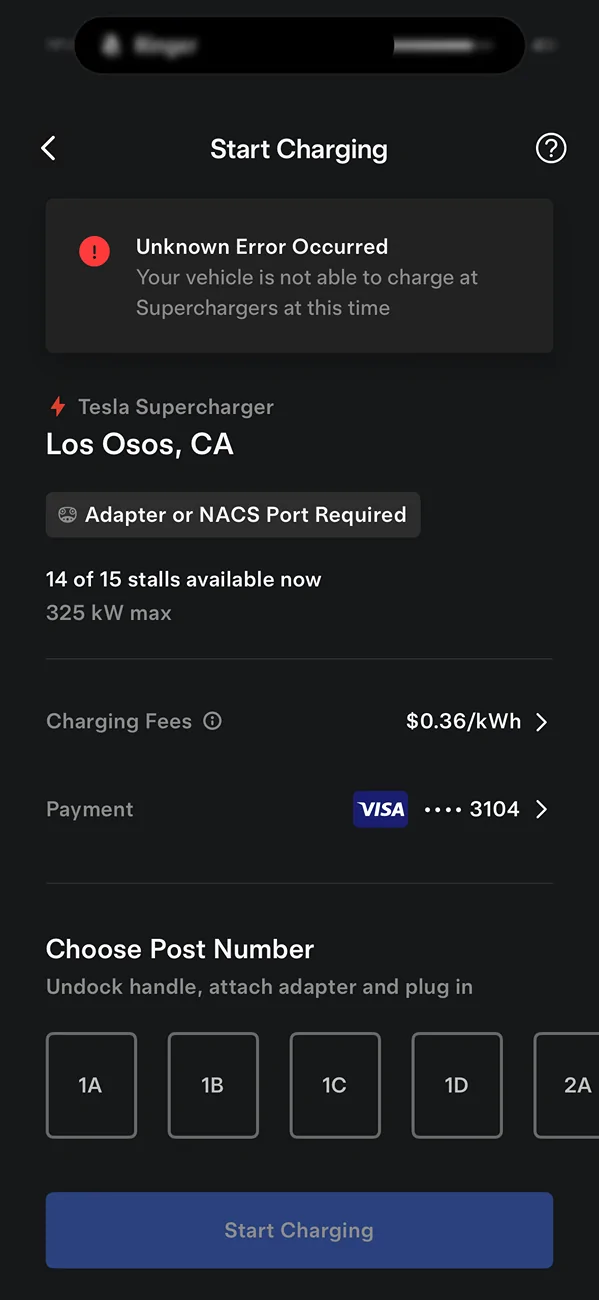

Yesterday I went to the only Tesla SC4 in the area and still no dice. Attached are photos of the Tesla app's screen after declining to charge the Taycan. Also a screenshot of the SC4's nice little monitor which reads "Unauthorized vehicle"
My guess is that Porsche support has not been turned on my local set of SuperChargers. I'm going to contact Tesla and Porsche just in case that is the case.

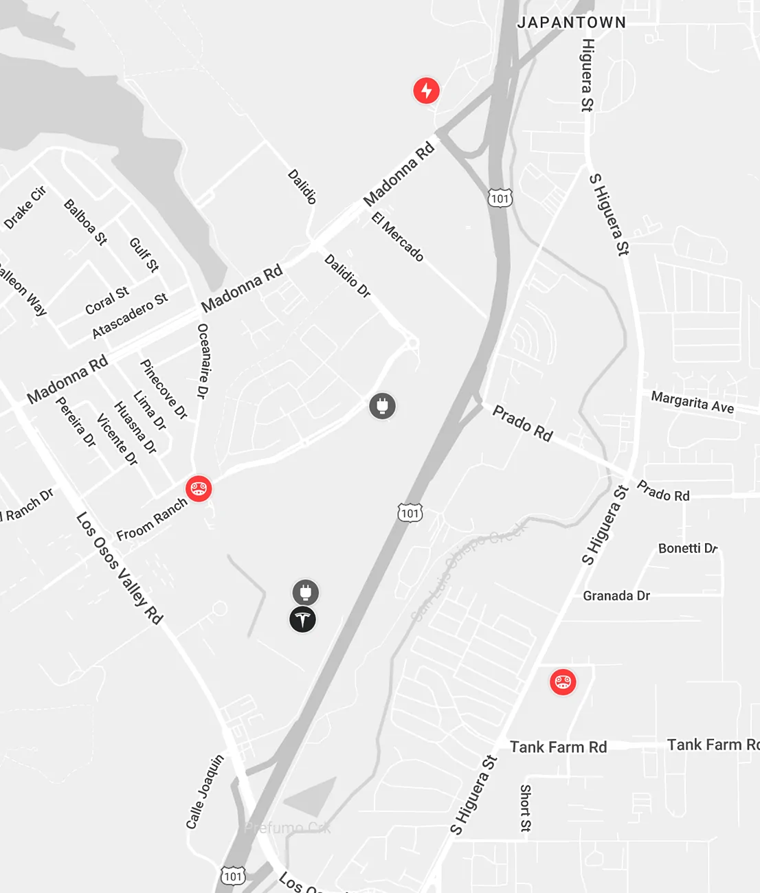

Interesting. The Tesla map should indicate this. In my case, the stations are definitely open to non-Teslas but so far not to my Porsche. This is from Tesla's charger station U.S. map. The symbol by "Madonna Rd."
Porsche Taycan Tell us your Tesla Supercharger experience 1758765096387-b9
apparently indicates Tesla only whereas the other two symbols near Froom Ranch Rd. and Tank Farm Rd.
Porsche Taycan Tell us your Tesla Supercharger experience 1758765144792-oh
are marked for both Tesla's and approved makes with appropriate adapters.
Here's a link to their map:
https://www.tesla.com/NACS

That’s the same error message I received before understanding you have to use the Tesla app (other posters have said PlugShare app as well) to determine if non-Teslas (or maybe Porsches specifically) are supported at that particular Supercharger.
That experience is what prompted me to create my post on the first page of this thread.
