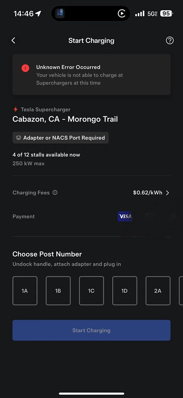

Wife wanted to go to the outlets at Cabazon, CA so I took the chance to try the new official Porsche adapter with a Tesla supercharger. superchargers there are Tesla only so I went to the adjacent casino and used their superchargers.
On the Tesla app it showed the superchargers would work for the Taycan (250kw max V3 superchargers), however I tried 3 stalls and non of them worked. Both the car and the Tesla app constantly told me there’s an unknown error after a long handshake while the Mercedes EQS next to me was getting charge no problem with an adapter.
Eventually I gave up and went to an EV go charger, till now I still don’t understand why this happened.

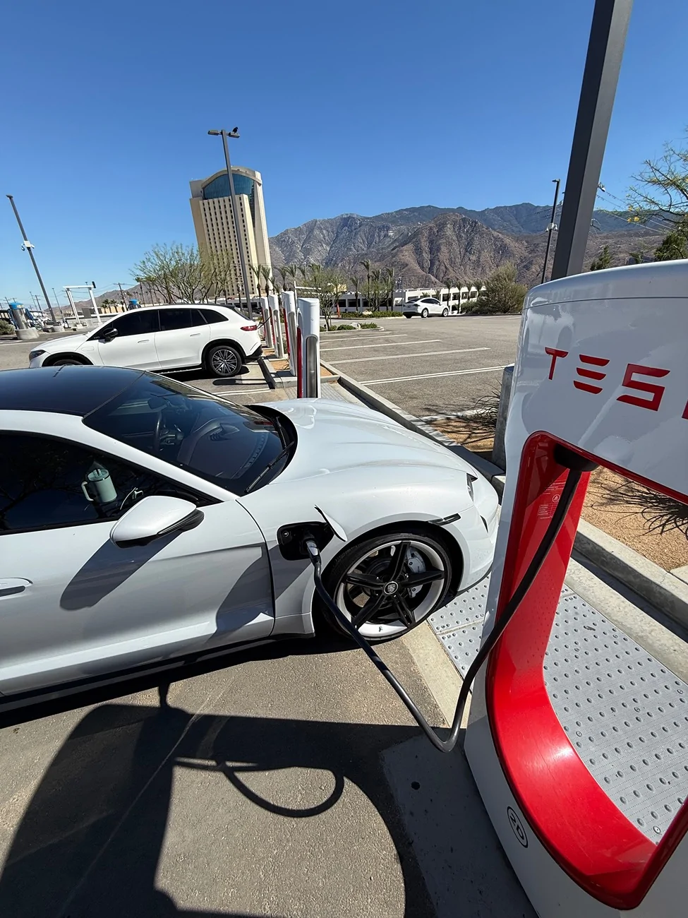

I had a great supercharger experience today.
I needed a charge, so I navigated to EA. Of course there were only 4 stalls, and all were full.
I glanced across the lot and saw a bank of 15-20 Superchargers with plenty open stalls, all side-saddle.
It was an easy choice. I was in and out of there before any of the cars at the EA station had left.

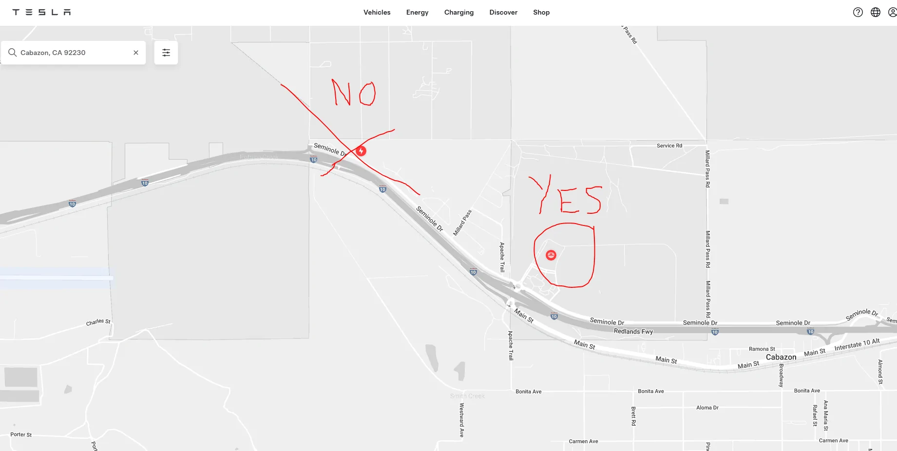

There are two Supercharger sites near Cabazon - are you certain you weren't at the one that DOESN'T support NACS?
Porsche Taycan Tell us your Tesla Supercharger experience 1758468130675-bg
https://www.tesla.com/findus?bounds...tion=CabazonCASupercharger2&functionType=nacs

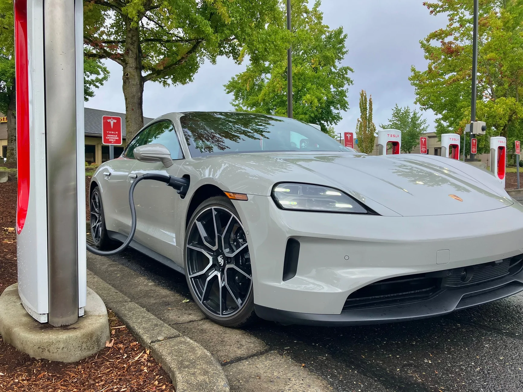

Received Porsche NACS adapter last week and tried it yesterday, Sunday. (I had previously added my car to the Tesla app.) One of the Tesla supercharger sites near me has one charger that allows Teslas to pull in head first, so-to-speak, so I went for that (had to wait a few minutes for a model Y to leave...) and backed in...see pic. Successfully charged to 60% SoC with a steady 136kW.
As I was driving home I went by another Tesla site and noticed a Ford Lightning beginning to charge with an extension cable. In talking to the owner a bit, it turns out he had just bought the Hansshow adapter/extension cable and was testing it. His Lightning charged successfully and he asked if I wanted to try it on my Taycan and so I pulled straight into a regular spot and we attached/plugged in and initiated charging via the Tesla app and it worked great.

I have two EVs. I've successfully charged my Ioniq6 using A2Z adapter at our local Tesla superchargers several times.
However, no such luck with the Taycan. Someone suggested removing the Hyundai info. from the Tesla app. Good idea but it didn't help.
Yesterday I went to the only Tesla SC4 in the area and still no dice. Attached are photos of the Tesla app's screen after declining to charge the Taycan. Also a screenshot of the SC4's nice little monitor which reads "Unauthorized vehicle"
My guess is that Porsche support has not been turned on my local set of SuperChargers. I'm going to contact Tesla and Porsche just in case that is the case.
