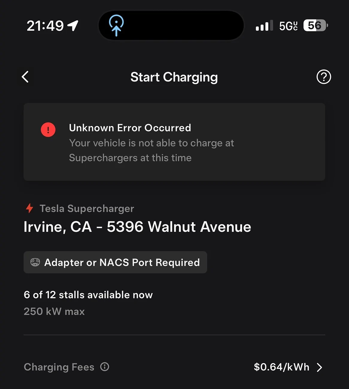

That’s the same error message I received before understanding you have to use the Tesla app (other posters have said PlugShare app as well) to determine if non-Teslas (or maybe Porsches specifically) are supported at that particular Supercharger.
That experience is what prompted me to create my post on the first page of this thread.
Sorry to hear of these glitches
Sorry to hear of the glitches. With the Tesla app, if the location isnt compatible it just doesnt appear on the map. So for SLO, only the 2 locations appear. However that doesn't seem to explain the issue at the Cabazon location, which does appear to be the 1 that is compatible..
Also one of the Irvine locations (didnt screenshot the other that didn’t work), which if you look up is also supposed to be compatible.

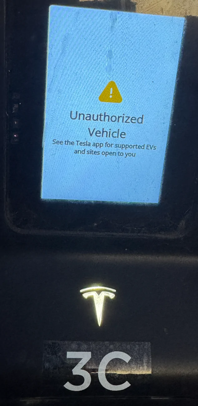

Right, two SC3 stations are available in SLO. However, in nearby Los Osos there is a SC4 station which is marked in the Tesla App as compatible for non-Teslas. So that is the third station I tried (pump 3C, as shown below, along with the SC4 analysis of the connection).

I thought I'd post an update on my efforts to charge my Taycan at our local Tesla SCs. From what I can tell most everyone is being successful using Tesla SC with the occasional exception that some SC stations aren't currently accepting non-Teslas. All the SCs I've tried locally do accept non-Teslas and, apparently, other Taycans (according to my Porsche dealer) ... just not my car.
To recap, I'm signed up with Tesla and have successfully charged another EV at the same Tesla SCs. I have the Porsche-labeled adapter and that adapter has worked fine with my other EV.
As to charging the Taycan, I've tried two SC3 and two SC4s in my area. In every case either an "unexpected error" is reported by the Tesla App or "unauthorized vehicle" from the Tesla App.
The Taycan always recognizes that a charge is being initiated but not current ever passes into the car.
I've asked my local Porsche dealership for help in figuring out where the problem is. I'm still waiting to hear what they suggest. While my car is still under warranty, I'm not sure such warranty actually covers being able to charge at Tesla through an adapter.
No idea whether my experience is totally unique or represent some sort of repairable condition in the Tesla (that's why I was hoping to do a poll of Tesla SC users).
