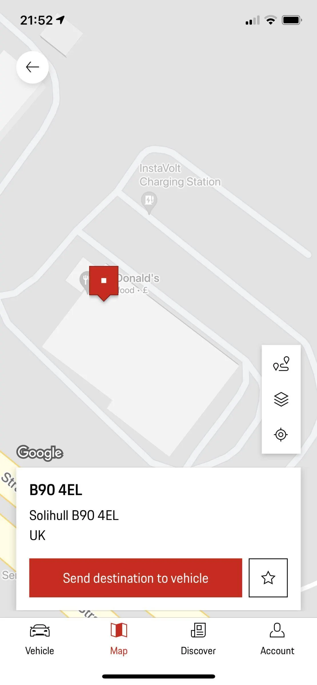

Hi. Sorry if this is covered but I can’t find it anywhere. I have only charged at home and at work so far but understand the need to pre condition the battery if charging at a DC charger to get the best rates. But how do I do this if the charger isn’t a Porsche one? I am using My Porsche and was looking at it this evening. The charger shown is likely to be a useful one to me returning home if I need a bit of extra charge, but it is in grey on the map. So is there a way of telling the car that the destination is a charger? I can’t see how to do it in the app. Am I missing something? Or can I do it in the car at some point? Or do I have to cheat and tell it I am going to the Porsche one up the road?

The app is rubbish for this. Do it from the car, you can navigate to the EVSE (and as far as Im aware) it will then pre-condition the battery.
I think there has been a recent update for the maps in the car which allows for the above. When you click on the DC icon from the map, you can then find out what the EVSE outputs etc.
I think in the USA you can see more through the app, including the output of the EVSE at locations. I’ve tried mine since seeing the post and I whilst I can search for a local location I know has Instavolt, it doesn’t show on the app. It does in the car.

Thanks. If I send a route from the app, can I then amend it in the car or do I need to do it all from the car? I hope they continue to improve the app as it could be good if this sort of functionality was added
Yes - send to the car and edit from the Nav screen.
The recent EVSE updates to Nav don't yet feature in the app unfortunately.
Either start with the app or wait until in the car. Select the DC EVSE shown on the map or search for it.
Either use this as your destination or add as a stopover.
As long as the EVSE is recognised as such then preconditioning should initiate and be completed as you reach it (unlikely if only a short distance away).

Setting any EV chargers as destination will trigger the pre condition even if you don't drive there and go to Porsche or anywhere else for that matter. If it's a short ride it will make little difference. The pre heat / cool will raise the battery temperature quicker so set that an hour before you leave. I charge at Porsche every two weeks. I authenticate with the card or the Porsche Charging app. Both work. Staff are friendly and always offer a coffee. It's not all bad out there.

Getting back to the subject here… I tried it out this afternoon. Went to Solihull - put the postcode in and transferred it to the car from the app. Got in the car and worked out that I had to look for charge points close by. The 120kW Instavolt charger wasn’t there. In the end I gave up and selected the Porsche charger about 1 mile away. This pre heated the battery as I drove to the Instavolt charger. I got 63kW for about 30secs which the went up to 120kW. I suppose this is the solution although it is a bit annoying that I couldn’t Locate the charger I wanted to use in the sat nav or the app.
