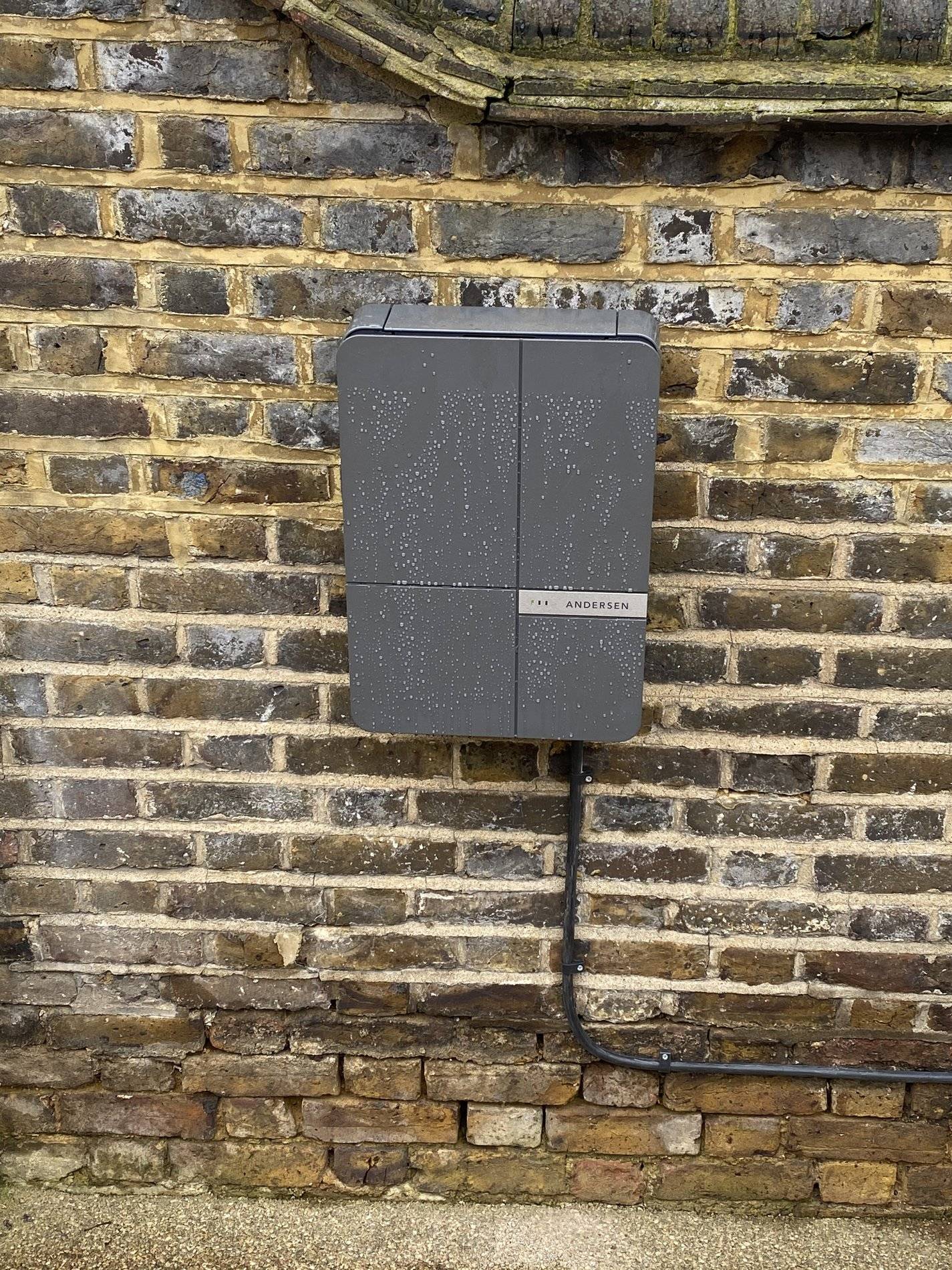

Ordered mine a while ago and had it installed today, I am very happy with it.
Cost was £995 for unit + £400 installation - £500 OLEV = £895 total
(I then had some extra costs on top of this as the unit was going in a "weird" place which needed an extra outdoor circuit board and buried cabling, but I think my situation is not typical)
The installers had only good things to say about Andersen, the quality of the units and more importantly the customer service. They mentioned a much more well known brand and they said they will not ever install again due to endless issues.

can I ask who you got it installed by? Have had a quote through this morning but it’s £1095 after grant which is £350 not £500?
SteveMc
Nov 10, 2019
115
95
Mine was installed by an Andersen approved installer (called Elecolgy who were great)
The OLEV grant dropped to £350 on 1st April 2020
Looking at the Andersen site it still looks like £995 for the unit + £400 installation, so you should be getting £1045 after the grant?
