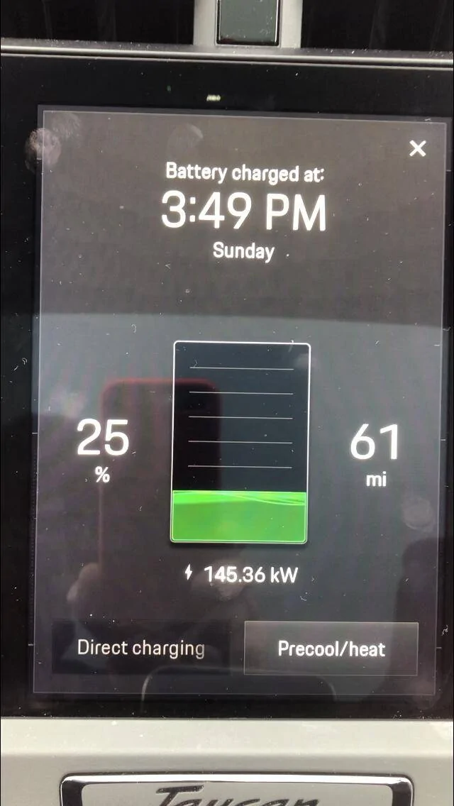

I took photos at the charging UI during the charging session - and then transcribed them into a spread sheet - I logged all the data from the photos for each “%” change - and if there were multiple photos with the same % value - I choose the highest displayed KW for that % ”segment” - at the charge rate you‘re getting more than 1% per minute - so the data log is roughly the charge rate broken down by the min for the 45 min session - as the car got closer to full and the charge rate started dropped I stopped taking pictures as frequently
along side the graph I posted is the raw “data table” the graph is made from - so each value corresponds to a photo that I took.

Sorry @daveo4EV you should update the title of this thread, the charger was not 400 V. I do not have the upgraded DC-DC converter, only the base 50kW version. I too got a peak charging rate of 146kW.
as you also figured out the tag on the side of the charger is not correct, the unit is obviously not 125 amp. Once you figure that then you could figure that the voltage may be wrong as well. This all makes perfect sense as you would know that to get 150 kW at 400 V would require 375 A. They could not possibly be pulling 375 A through that cable that is not water cooled. Solution, it’s a 800 V or maybe 950 V charger. This makes sense why they call it an 80 kW³ on their website. It’s 80kW at 400 V or 160 approximately kilowatts at 800 V, they very well may just clip it at 150 kilowatt. I would speculate the max they can put on those cables is 200 A to be within their specifications at 400 V that is 80 kW.
I did end up having to call EVgo support at the end of my session because I had unplugged the Honda clarity that was using that charger and was it done. I verified it was done on the screen he first drove away and then he came back accusing me of stopping his charge because it was 91%. We called if you go and they explained that the charge was stopped because of the 45 minute max session time Which she was not aware of. I did try asking the EVgo person about why I was getting this rate versus what is posted in their app but she really did not understand. They seem unaware of the fact that some of their chargers are now 800V.

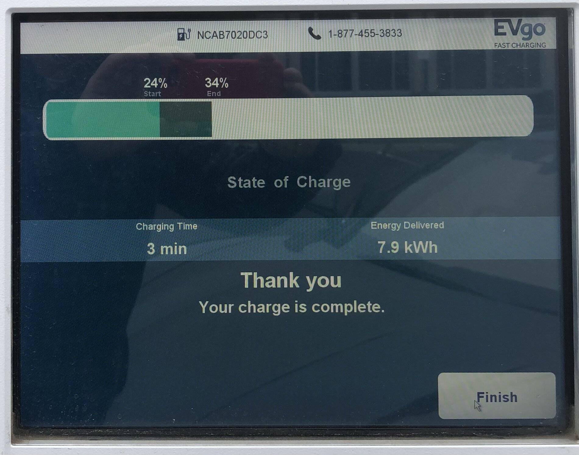

24% to 34%, 7.93kWh in a 3 min session. Only paying $.30 a minute is a deal getting that much power. They’re obviously going to have to change their pricing structure as more 800 V cars come along.
Email summary from EVgo
Feb 14 at 2:48 PM
Dear Ron B,
Thank you for using the charging station at Foster City - 1030 E Hillsdale Blvd, San Mateo, CA. Your charge session has ended. The total duration of this session was 00:03:45 and the energy charged was 7.930 kWh. Your total cost for the session was $0.90.

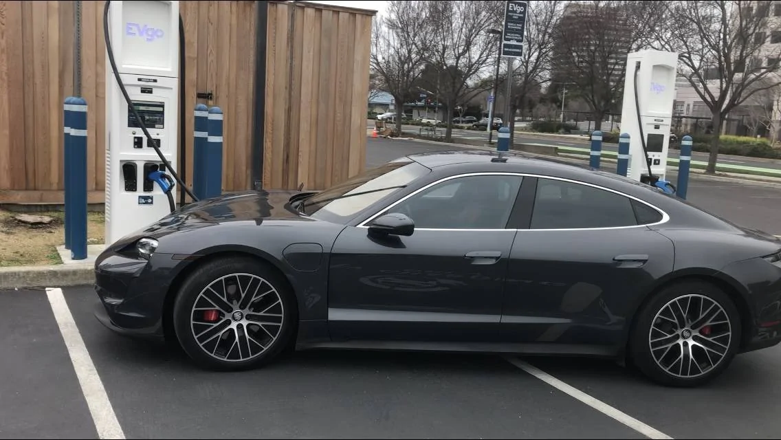

Notice also that EVgo cords are very short requiring one to Park a Taycan in a rather obnoxious way. As I stayed with the car and would have moved it if there was any conflict I didn’t see it as a problem this time.

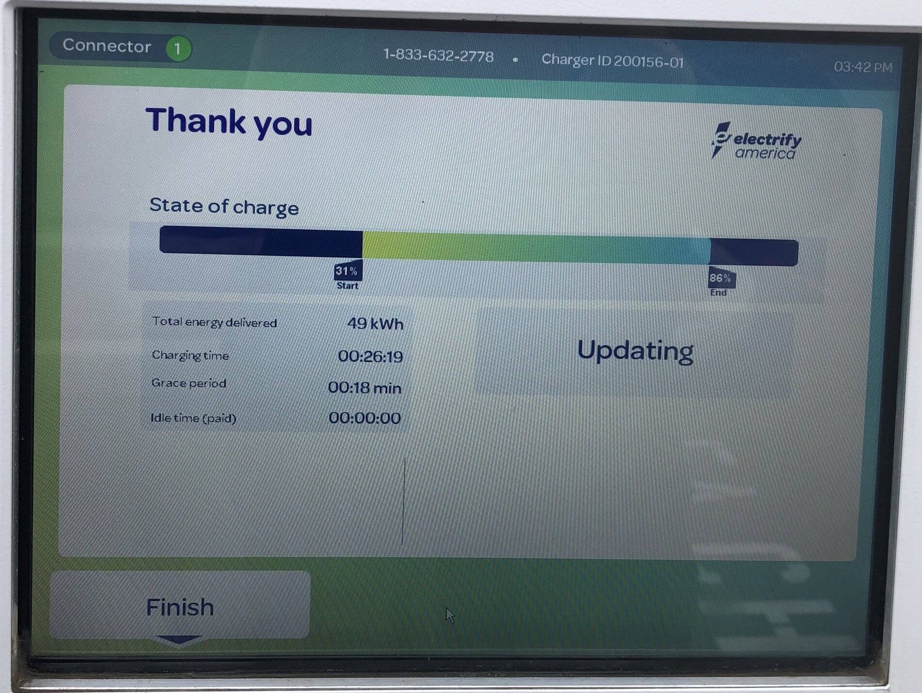

After my short test session I then moved over to an electrify America 4 miles away that was in a Safeway parking lot which allowed me to do some grocery shopping for the wife. Always good to get a few points on Valentines Day and kWh too.
It was not a fabulous session, only about 135kW for most of it then dropping to 100kW for the tail.

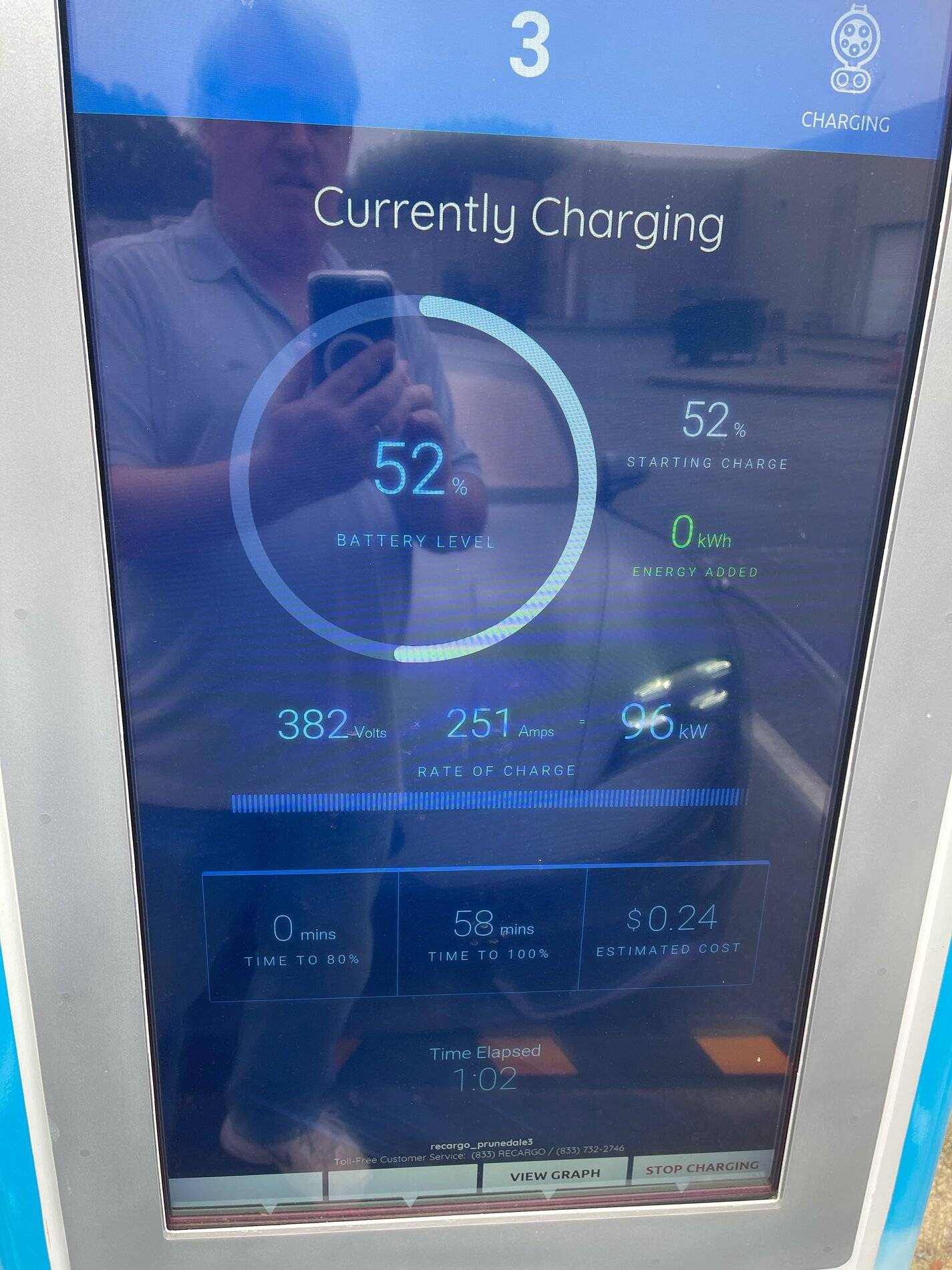

actually accomplished a 100KW 400V charging session - so _RESULT_ - but these charging stations are supposed to be 800V capable - so we don't know why we didn't get an 800V charging session - but the Taycan charged at 95-103 kW from 52% to 91% - station status screens report voltage so we have a confirmed instance of my Taycan charging faster than 50 kW @ 400V session - but it could be a bug that this station did not negotiate an 800V session…
pictures below tell the story
BTW: these chargers are great!! some of the nicest I've ever used - nice user interface, charging session just worked, reasonable pricing - great summary data at the end of the session - great sustained charging rate

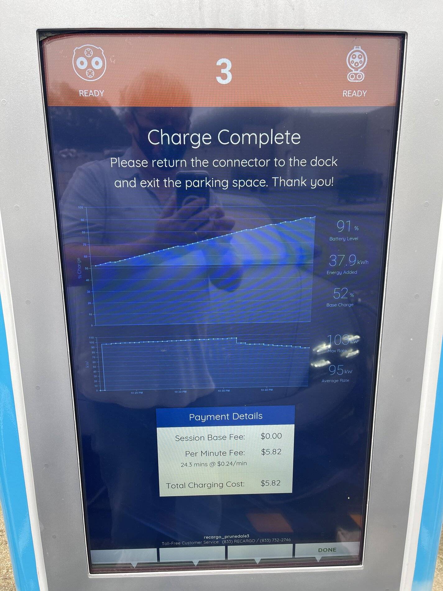

the Taycan continues to be a charging champ - with it maintaining >=95 kW charge rate into the high 80% SOC…range - session was 30 some minutes and got from 50'ish % to 91% - 38 kWh added to the battery...
clear result that that my Taycan charged twice as fast at an average rate of 95 kW - but it was only a 400v session due to a potential bug in the Stations software - customer support says they haven't done a lot of testing (probably none) with Taycan's.
Picture #1 - shows 382V @ 251 amps - 96 kW charging rate at the beginning of session
Picture #2 is the very nice summary screen at the end of the session with all the data calculated for you…

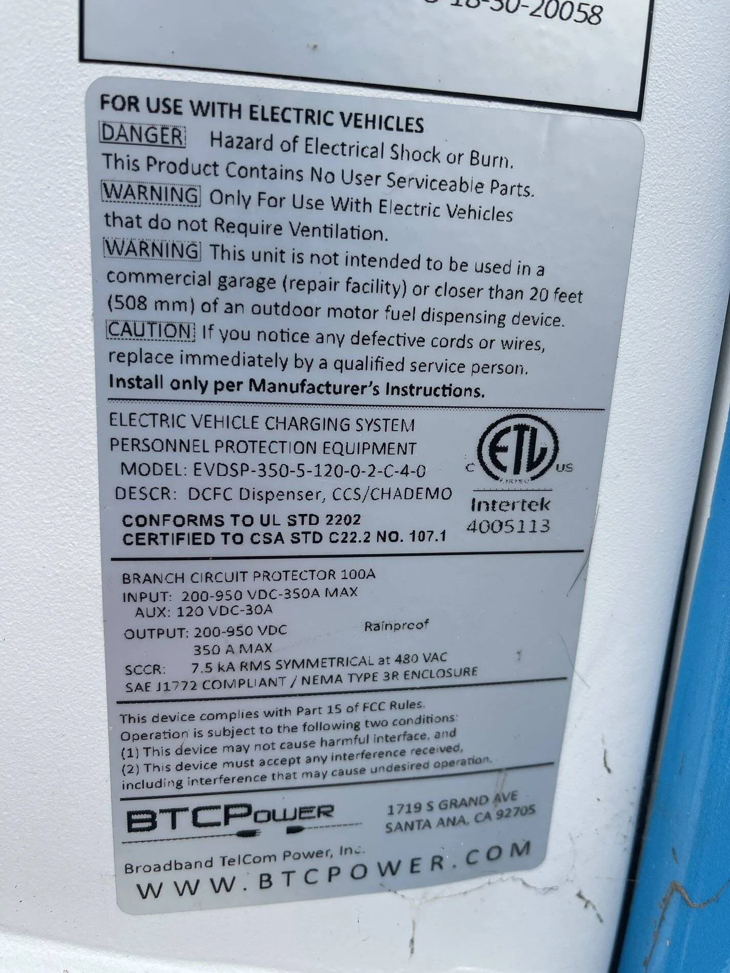

Picture #3 is the power disclosure from the station - clearly showing it should be 800V capable.

  • the Taycan clearly benefited from the option because we had a 400V charging session at greater than 50 kW (95-103 kW charge rate observed during session)
  • but that was a "bug" in that the station did. not successfully negotiate or engage an 800V session - which clearly would've charge the Taycan both faster and would've had no need for the option

And I will continue to assist in this test also, I will try to arrange a stop at this charger @daveo4EV hit with my Taycan before they fix the 800V negotiation issue.
I had called BTC power to report the problem as well after Dave told me of this behavior as I knew these chargers were supposed to be 800 V from my previous experience with my Chevy I had to use them a few times in the past. Dave sent details of his session so I hope that they will start looking into it.
