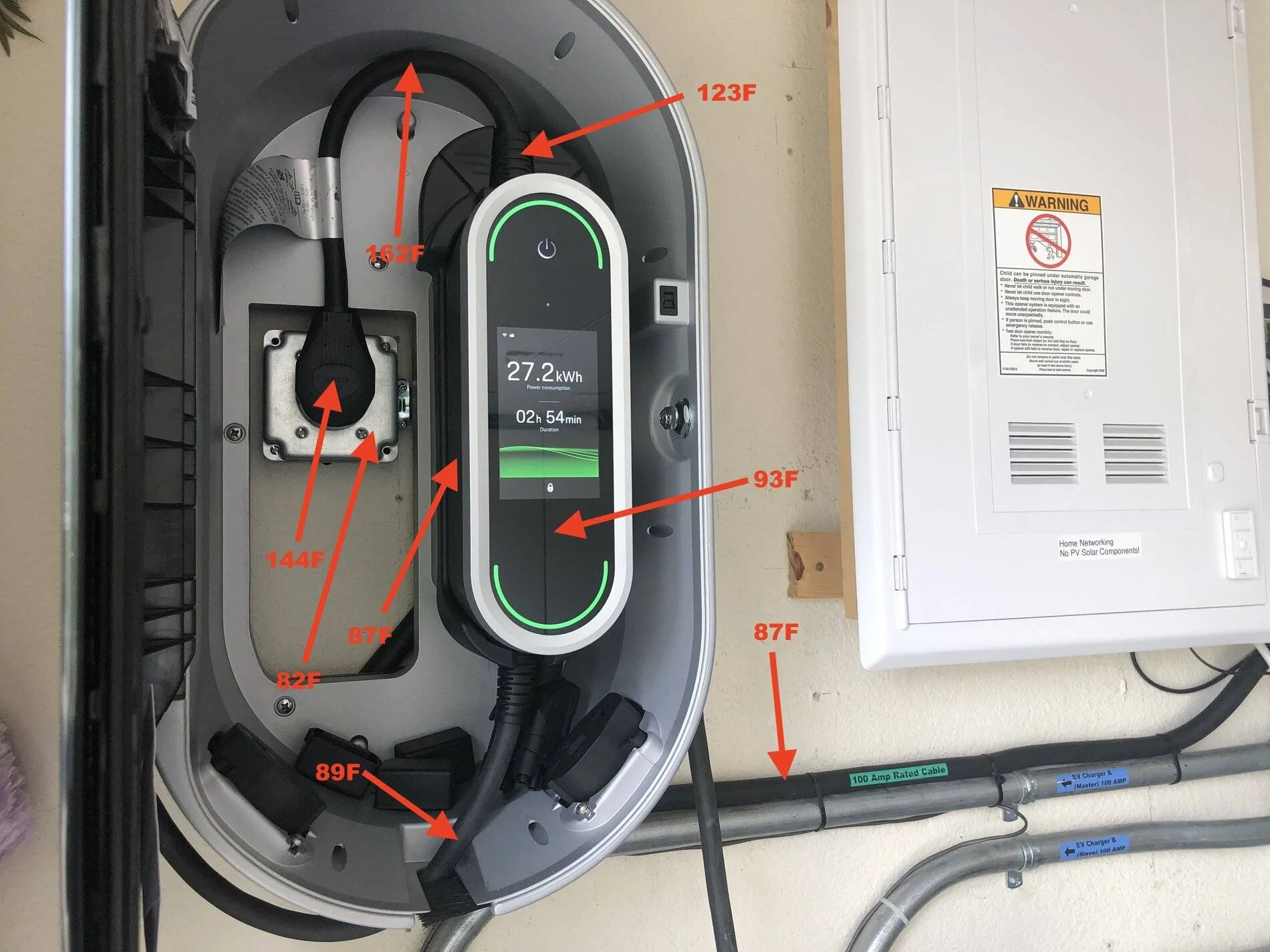

Hello,
my Taycan has been charging at 40 amps for over 2 hours this morning at roughly 64 degrees ambient temperature. I gathered the following data from various points in the charging circuit:
all measurements are on Fahrenheit:
I think the NEMA 14-50 cable is getting too hot - probably due to inappropriate wire gauge - the label says rated for 16 amps - and thickness is appropriate for 16 amps - I'm betting they didn't do the proper gauge for North America, and instead are working European standards - 3 phase 16 amp rated wire - but what do I know.
the supply Cable from the sub-panel is less than 90F - and the breaker itself is less than 90F - but the Porsche provided supply cable is running 2x temp vs. the rest of the system - something seems wrong.
the temperature of the J-1772 cable and the J-1772 Plug are below 90F - so no issues there.
thinking about this today - we're full circle now…Porsche did in fact have a problem - their components are "safe" but they do thermally stress "other" components of a charging system in residential…
their official response to this is…it's all good advise - but the Porsche EVSE's are thermally the worse performing EVSE's in North America…Porsche to date refuses to update/change/fold/spindle/mutilate their power supply cable to lower their thermal demands on other parts of the system.
But we have clear guidance on a "proper" install which we lacked when thread originally posted over 3 years ago…

it's also important to define a few terms:
  • Charger - this is the module inside the vehicle that converts AC power to DC power required to charge the battery
  • EVSE - PMC+/PMCC - these are _NOT_ chargers - they are external power supplies - they are an on/off switch to start/stop the flow of power under the vehicle's onboard charger's control
  • Overheat: an item that fails to operate due to excessive temperatures
the PMC+/PMCC power supply cables do not in fact overheat - I have not personally experienced any of my unit's overheating. Also to date there are zero reports of Porsche's Power supply cables "failing" due to any thermal excess.
Running "hot" is not the same as "overheating" - the Porsche power supply cable is rated for 105C operational temperature or 221F - the insulation on the power supply cable is rate to maintain it's integrity up to this operating temperature. To date I'm unaware of any reports of Porsche's power supply cables reaching their thermal failure point.
That's not to say that I believe their normal operating temperature is "ok" or desireable or even should be an operational goal. In my usage I routinely saw operating temperatures of 166F surface temperture. This is much hotter than other EVESE's I've experience, and is in my opinion an undesirable operational envelope - but it does not rise to the level of actually "overheating".
the Porsche EVSE's normal operating temperature is higher than I personally desire in a consumer electronic's device, and there are examples of alternative products that provide the same 9.6 kW charge rate and do not operate at similar temperatures.
Porsche's EVSE does thermally stress all components of a 50 amp 240V North American residential circuit and therefore all other components must also be designed/specified to integrate well and tolerate Porsche's normal operating thermal envelope - sufficient to note that most $12 NEMA 14-50 powersockets are probably not formally rated to handle hour's long operational temperatures 7 days a week of 160F+ - and we have examples of "lesser" NEMA 14-50 sockets demonstrating thermal stress induced failures (melting) when paired with a Porsche EVSE…it doesn't have to be this way, but Porsche's EVSE power supply cable is not in fact overheating - it's demonstrating a 90F-100F operational temperature rise/delta + ambient for 40 amp continuous load - which is exactly what the engineering tables expect/predict for 10 AWG wire. Porsche's insulation is sufficient o absorb and handle this temperature with out failing…so there is not technically an overheating problem.
The porsche EVSE sucks in my opinion (news I know) but it doesn't actually fail - it's just very demanding of it's enviroment and Porsche to date show no interest in changing it's operational parameters. it's a 40 amp EVSE that runs hot - their response is to "get over it" - our product is fine and well designed - and they are not technically wrong…
my units are no longer in use and I've purchased and routinely use other EVSE products that delviery 11 kW of power on a daily basis and also happen to operate at much lower operational temperatures vs. Porsche's design.
I value the ability for me to make a choice as an informed consumer and I've done so. But Porsche's units do not "overheat" - they just run hot as part of their normal operating process.
Porsche now has extensive operational documentation for a "correct" install for use with a PMC+/PMCC - to date I'm unaware of any operational issues with the PMC+/PMCC when following Prosche's recommended install process and equipment. It's a 40 amp/240V/9.6 kW EVSE that will routinely achive 165F operational temperatures - which is not technically a problem if all the elements of the system (breaker, supply wire, NEMA socket) are rated to handle this type of thermal load…
all that can be said is that other competitive/alternative 40 amp/240V/9.6 kW EVSE's do not have a similar thermal profile - but Porche's unit's technical do not overheat - they just run really hot - according to Porsche this is expected and normal given their design.
