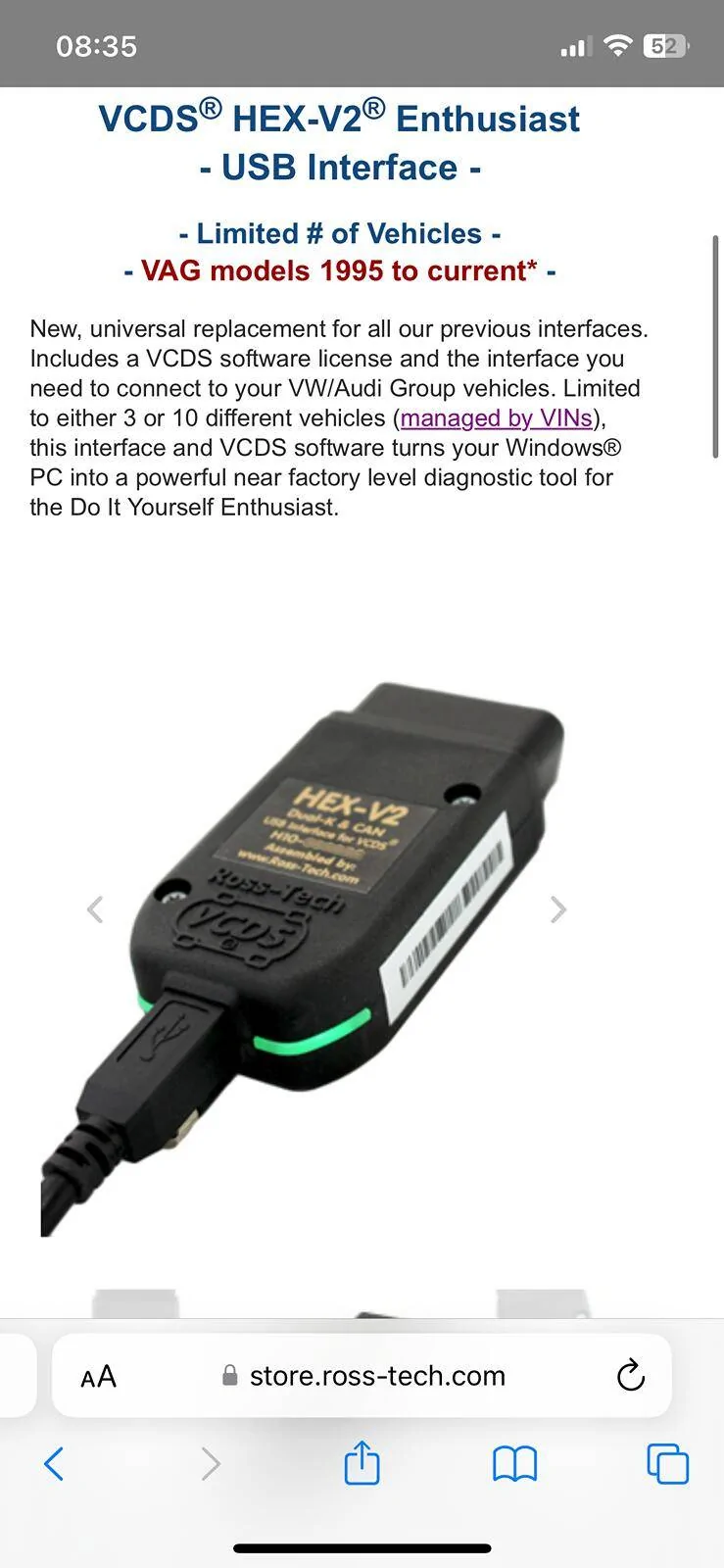

I have ordered a Ross-tech HEX V2. I read on this forum it can be used to lower the Taycan.
I’m curious what (other) functions can be programmed or altered via the VVDS.
Does anyone have experience with it?
