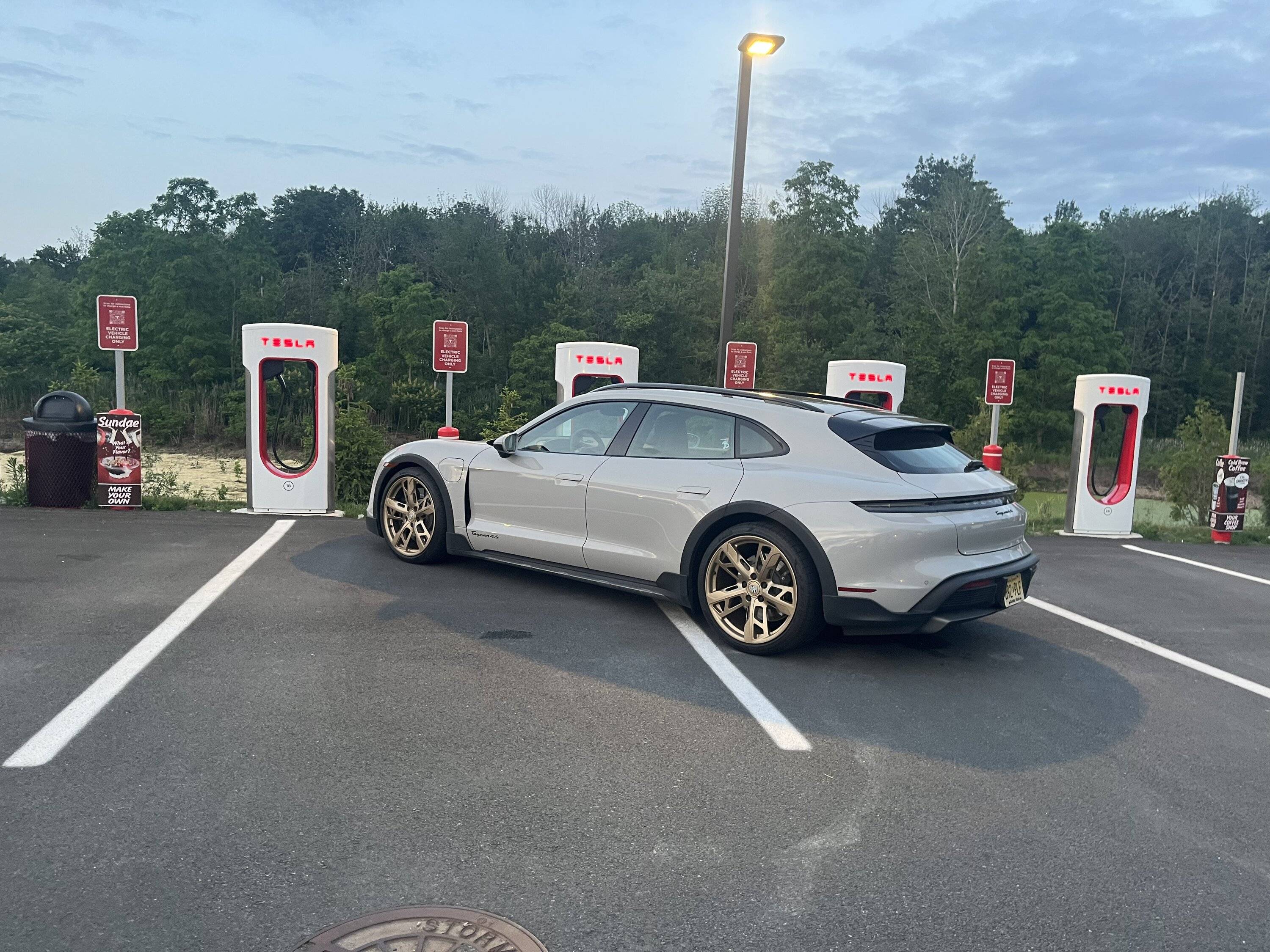

I got 126kw at one of the first “magic dock” stations here in New York. Had to take up two stalls to teach the socket though!
