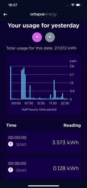

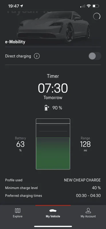

So, i thought I’d have another go at using the PCM to control the charge based on everything I’ve read. I now think my car is officially taking the p&ss out of me, or the software is corrupt.
Can anyone explain this?
Charge at 63%. Combo of timer/profile covering the following. Min charge set to 40% so wouldn’t start early.
Max charge set to 90%. 27% is achievable in 4 hours on my car as the smaller battery. Preferred timer set to 1230-0430am. Departure set for 730am. No pre warm selected.
Shot of my electricity usage that night.
Car started charging at midnight. Stopped at 1230am. Then started charging at 430am. Brilliant. Literally managed to avoid all my cheap electric hours!
I unplugged it at 630am ish when realised it was charging.
All worked fine pre my software update. Could it be corrupt?

There doesn't appear to be anything wrong in the profile or timer.
Which charger are you using - Porsche or other brand? I believe you are using your Podpoint on a 13A 3 pin plug - right?
Not ideal for home charging and worthwhile to revisit having a 32A feed from your fuse box to get the most from your single supply (twice the output and half the time).
If your Podpoint has a max rating of 3.2kW then clearly you are limited to the slowest possible charge and stuck on a 13A 3 pin connector.
Therefore if you repeat your test with the PMCC which I think you also have you will achieve the same charging rate as your Podpoint using the 13A 3 pin plug to connect to your supply.
Potentially there is an incompatibility (firmware update needed on your charger?) as the car controls the charging process and not the charger. This incompatibility may have arisen following the software upgrade to your car.
It would be worthwhile to repeat the same test using either charger on the same supply connector. My guess is it will work as desired on the PMCC.
Setting your departure time to 04:30 will not make any difference - illogical to think otherwise.

If you look at the shot of the charging, the time slots are ½ hour so looks like the supply is close to 7.2 kW. So there probably is a 32 amp supply.

Supply looks to peak at 3.6kW (look again) - that’s 13A on a 3 pin UK plug.

Nope, as Scandinavian says they are 30 min slots, so 3.6 x2 is 7.2kwh. I have a podpoint that is wired in as part of the process presumably to a 32amp board to allow 7kwh. If I used the Pmcc I wound only be getting the glacially slow 3kwh as you’ve stated so not really an option.
It is a bit confusing to look at his picture but it actually shows half hour consumption ie kWh! Not the power level in kW! Look again!
