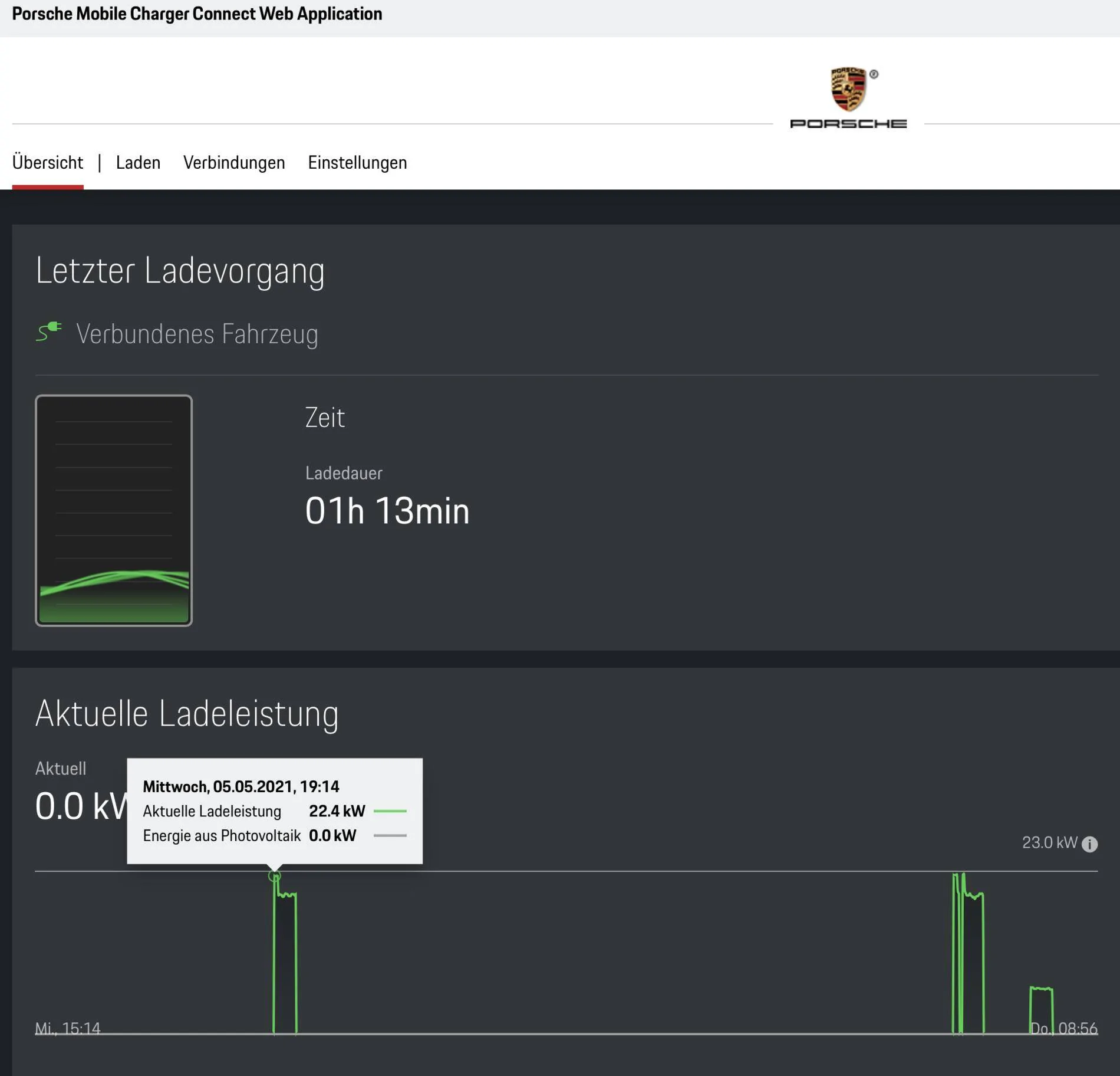

Weird indeed but what make and model of charger do you have and what MY is your car?
2021 T4S and it is the PMCC (free with the car). Took a bad screen shot of it this morning as times not visible but was 19h-20h and 06h-07h and then a small blip before 08h to warm up the car.
I keep thinking it is a daylights saving time issue but then it would be consistently wrong -- which it is not. One hour too early in the evening and right on in the morning.
Porsche Taycan Will my car charge tonight? Screenshot 2021-05-06 at 08.56.43
11,078
6,858
Same setup as me. When the charger is connected and you connect to the charger portal where does the charger get its time from - the car, network, other?
Time zones are weird for sure and worst on My Porsche where my charge start and end times displayed never align with the actual times and I can't figure out why. All I'm assured off is that charging occurs between the parameters I set.

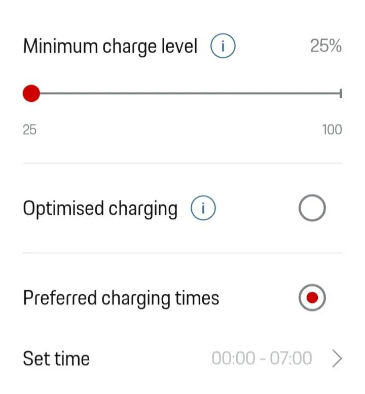

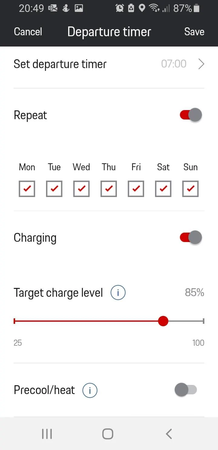

Use a profile + departure timer. Disable any other timers / profiles which may conflict.
Check that what you had previously hasn't been reset post the software update(s).
I have PMCC, all updates and no issues charging between 00:00 and 07:00 to 85% (my off peak period).
