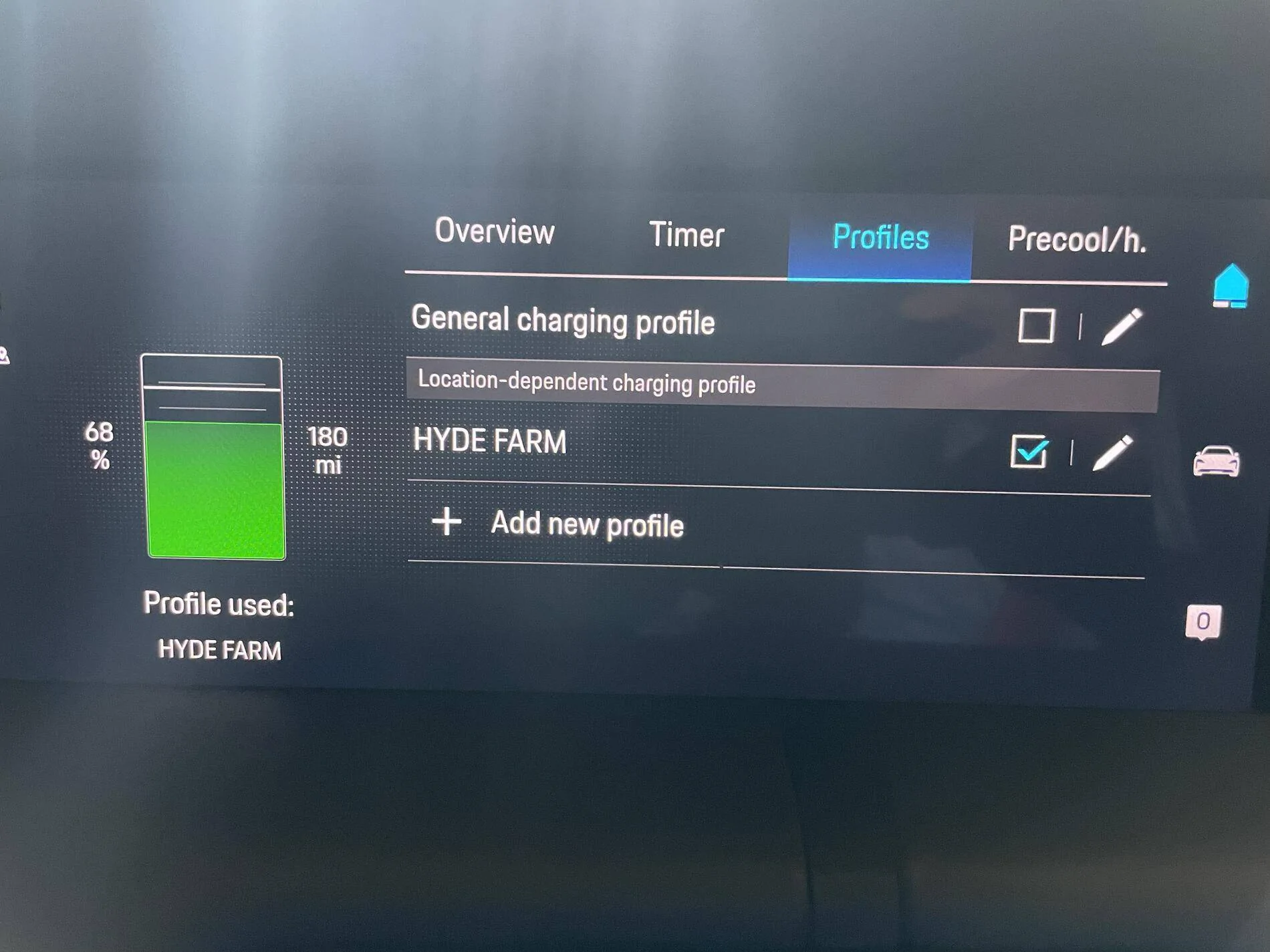

I have a dedicated 32A connection for my PMCC

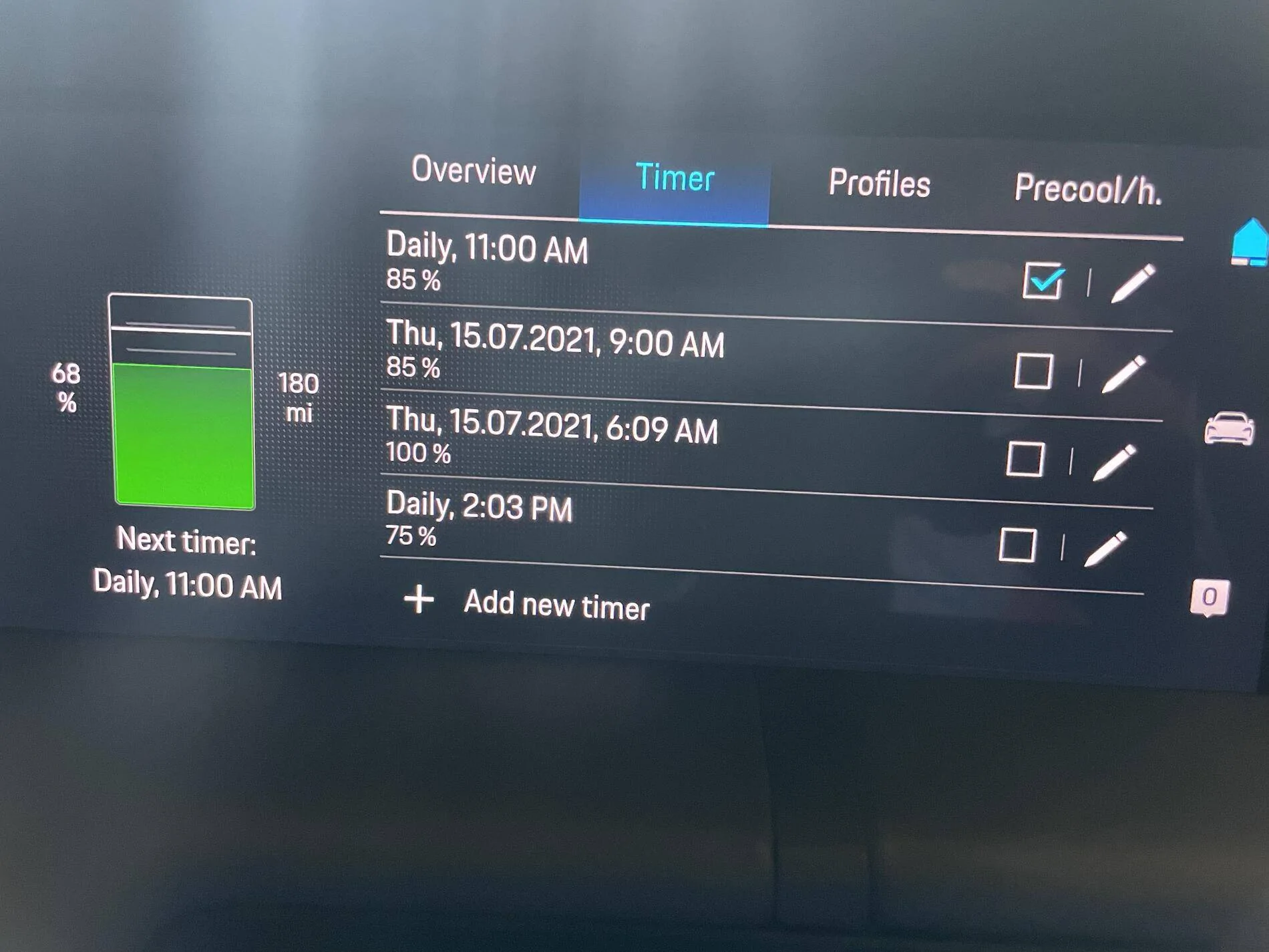

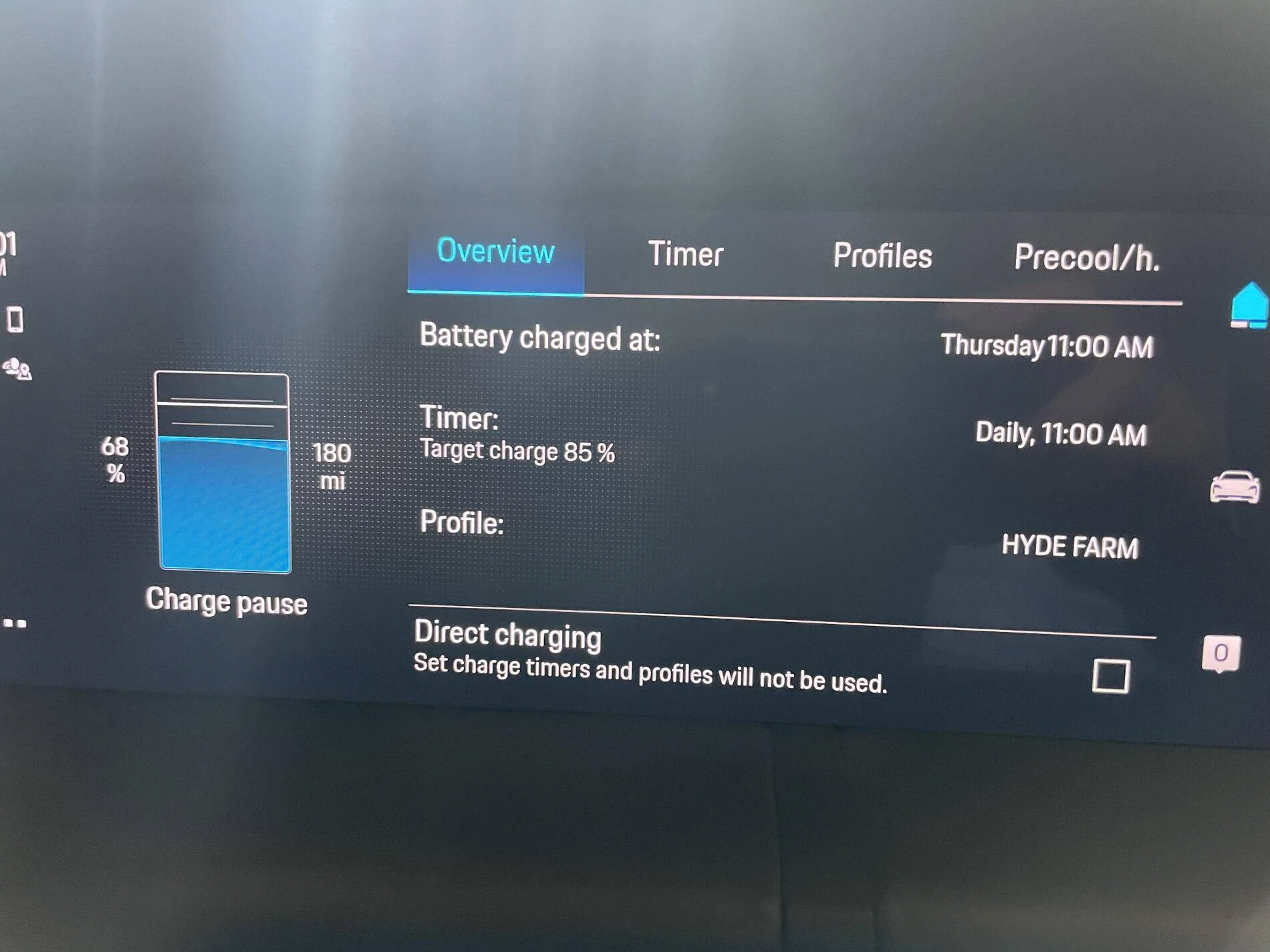

I attach screen shots for my Timer and Profile (plus shots of the "pen" detail behind)

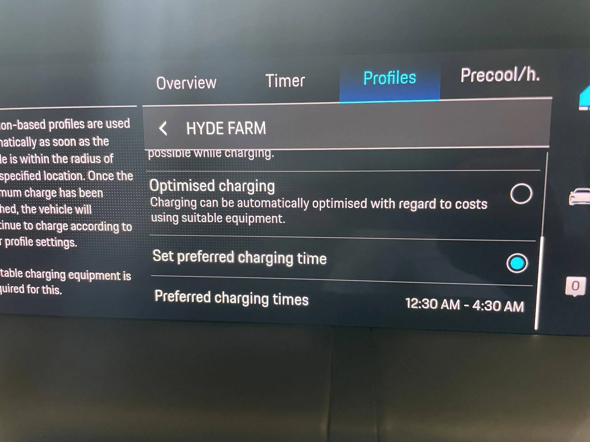

Pre-software update, my 4 nightly hours(00.30 to 04.30) of off-peak electricity routinely delivered a 29% increase in SOC.
I currently have 68% SOC, so I would hope that with these settings the car will; do nothing until 00.30, then charge until it reaches 85%(as set in the Timer) which should be before 04.30, then stop.
Since the software update, the nighttime charging has not initiated at all.
The PMCC works fine on direct charging and the departure timer on its own (ie with no preferred charging times from a profile) also works

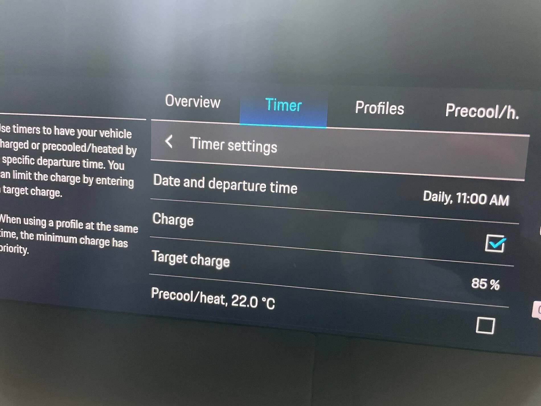

First glance shows a departure time of 11:00am - this should be the same time as your off peak ends ie 04:30 otherwise the car will calculate that it doesn't need to charge until much later to reach your target.
I'll look some more but that is the first issue

Yes, I’d say the departure time is your issue there from my experience. When I was attempting to get it to work the departure time override everything else rather annoyingly. The other watch out is the minimum charge in your profile. What’s this set at, as if below your SOC it could start charging early? Make sure you turn precool/ heat off as no point heating or cooling the car at 0430.
Ideally you’d set a min charge to 56% based on 29% you get in the 4 hours to take you to 85%, but from memory this would need to be 60% ( 5% increments), so the max you will get is 25% off peak with this set up. If below 60% charge and you didn’t want it to charge you’d need to increase the min charge value. Basically the above is why I gave up on this set up as it’s madness you have to go through a series of calculations to avoid it charging in peak times post software update, when all I want is it to charge from 0030-0430. Should be simple but isn’t.

Setting the timer for 4.30 worked. Thanks
However, I dont see what the Profile is now doing for me. The timer seems to charge as late as possible, regardless of the stated preferred times in the Profile. I might as well just use a Timer and accept that I can only ever get 29% SOC at cheap rate.

You must use a departure timer in conjunction with your location based profile. Try the following (note that it doesn't have to be daily nor does the car have to be charged every day - the tech will manage when the car is connected for charging or not) and note that 'departure' doesn't mean you have to leave / use the car at the time set but simply you want it charged to the required level by then and stop charging.
Disable / delete all legacy timers and profiles.
This 'must' work (has worked flawlessly since day 1) - I've used on PMCC and non-Porsche EVSE - perfect every time:

Sorry that's not correct.
Minimum relates to the state of charge (SOC) when you connect your charger. In the settings I've provided 25% means "when I connect the charger and my SOC is less than 25% then charge immediately to reach 25% and then pause and wait for the timer to kick in".
I think you have misinterpreted what these settings mean.
I use off peak too and I can categorically confirm these settings work. I never have an SOC <25% and so my charging pauses until the timer kicks in.
Please refer to the manual to understand the concepts better - it will help you in the long run.
