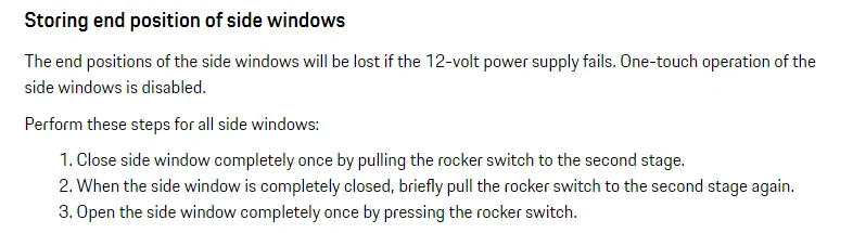

Consult the owner's manual and follow the retraining guide for windows so that they 'learn' the closed position.
Thanks! The reset worked!
