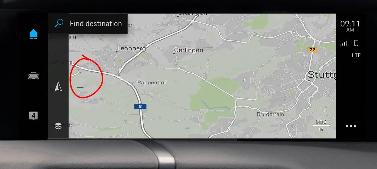

3. Satellite view in navigation stays checked when checked.

Sat view in nav is loaded almost immediately.
It seems my settings are stored correctly and permanently, even in areas with low coverage.
Navigation: street names are shown much better and more often.

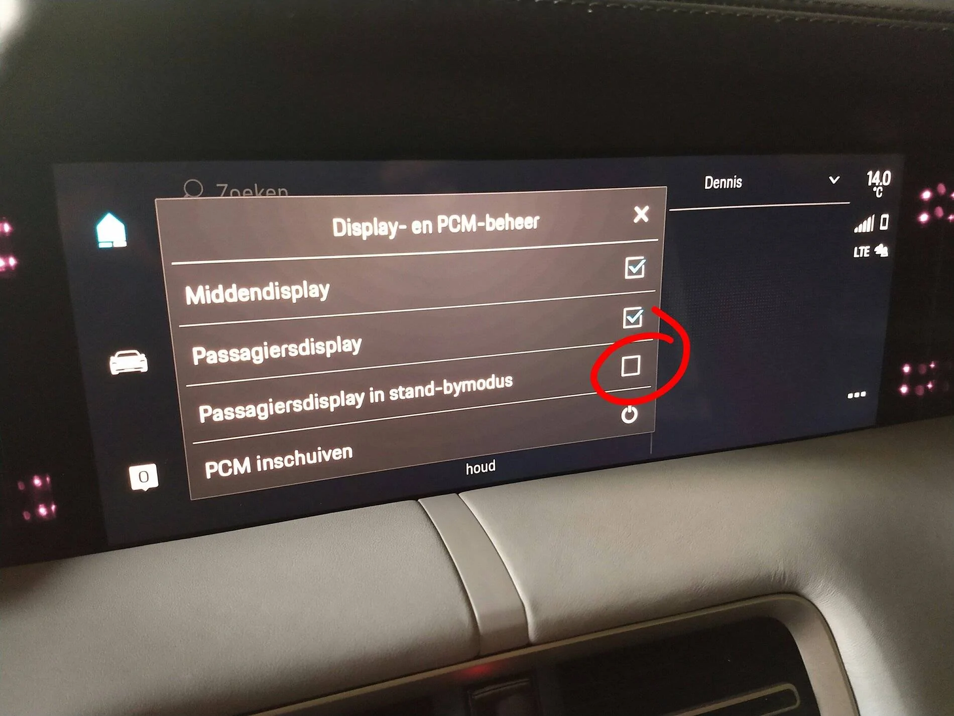

Another new feature is the activation of the passenger display when you're driving without a passenger in the seat.
First, select the middle button in the lower middle display.
Then, deselect the checkbox in the pop-up menu in the upper middle display.
This is only possible in Park.
Close the pop-up menu.
If this doesn't work the first time, try this:
-Call up the pop-up menu again.
-SELECT standby mode.
-Put into Drive.
-Put into Park.
-DESELECT standby mode.
-Close pop-up menu.
-Put into Drive.
As long as you don't put it into Park it stays on.
Unfortunately the setting isn't saved so you have to do this every time you start the car...

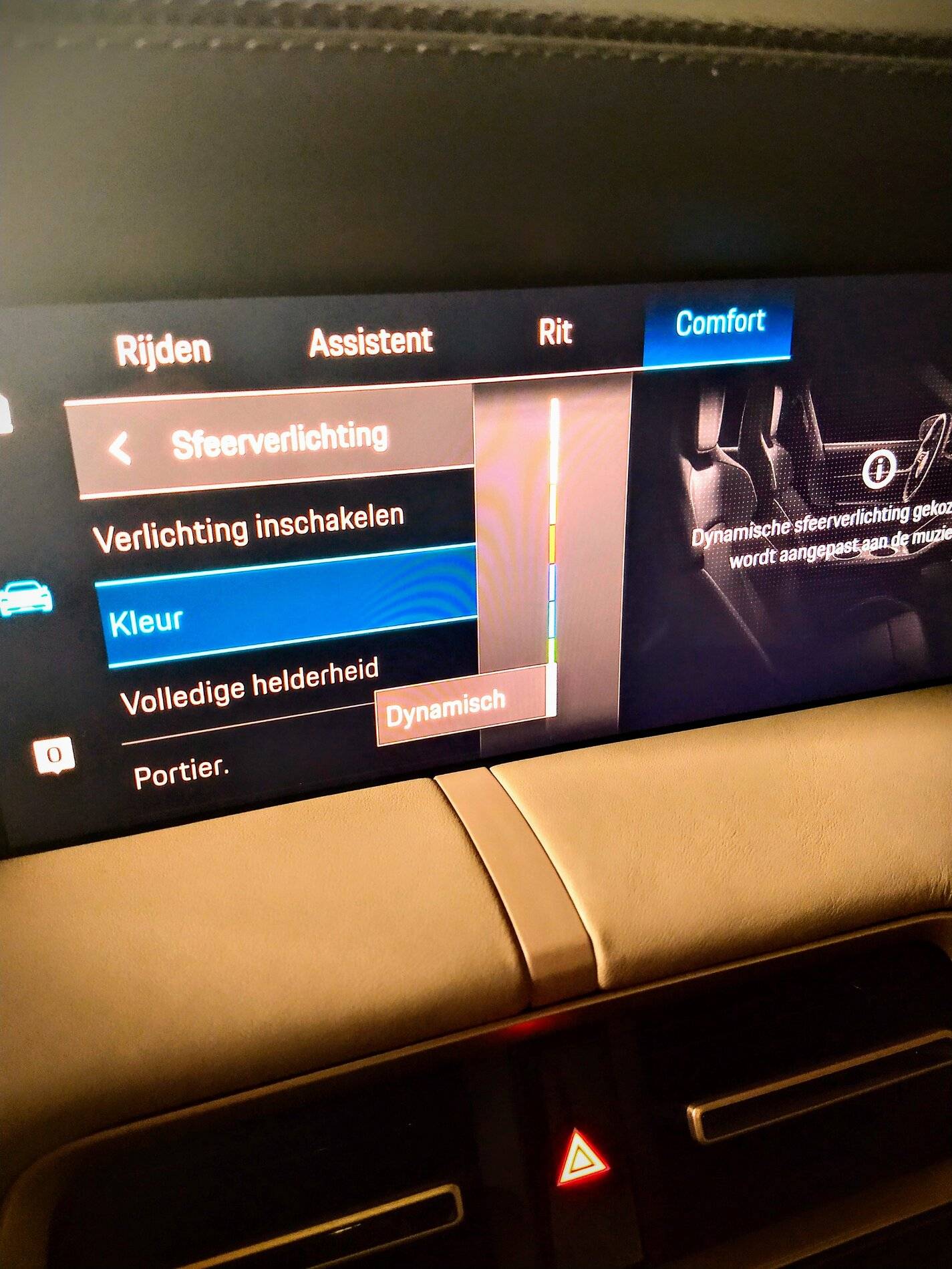

The dynamic ambient lighting is in the color bar (CAR icon -> Comfort -> select color).
To activate:
Home: MEDIA -> submenu (three dots) -> checkbox.

The nav screen now has + and - to zoom in and out (or just double tap on the screen to zoom in).
