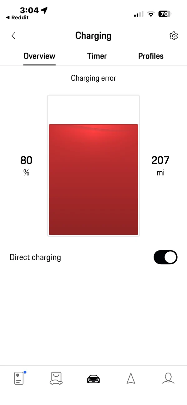

The yellow circle "Electrical System Error" showed up for me last week. Along with that error, I started to get charging errors at exactly 80% charge. To me, that 80% charge limit indicates that the ARB6 software update has identified an issue with my battery. I have an appointment scheduled with the dealership this Friday morning to see what they say.

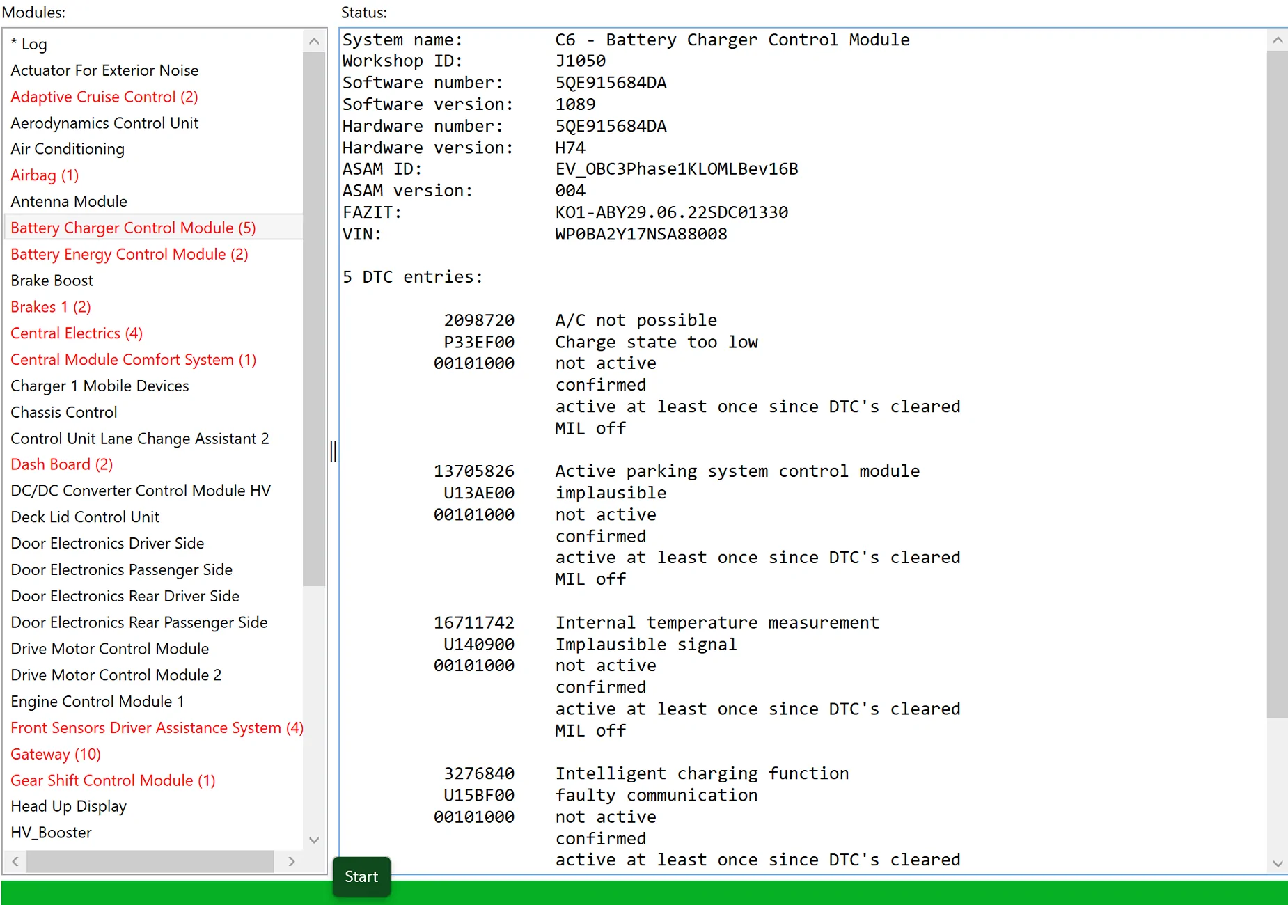

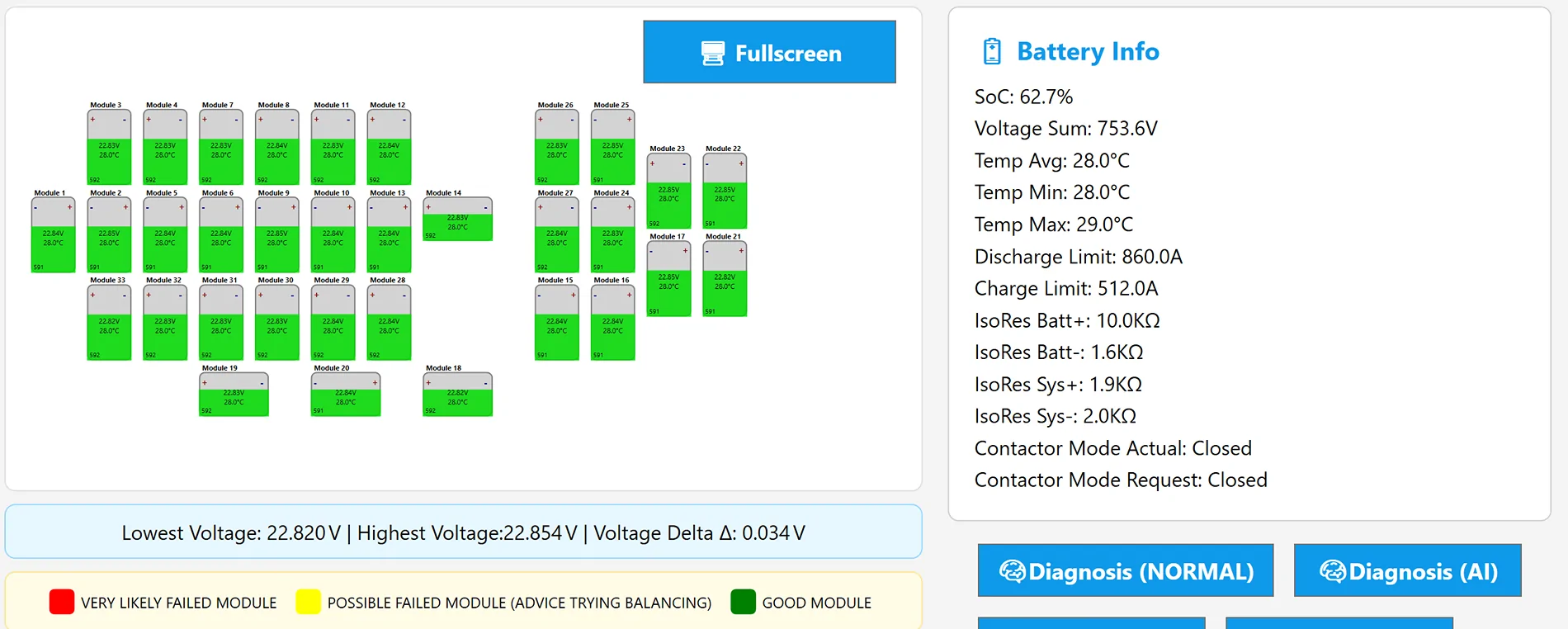

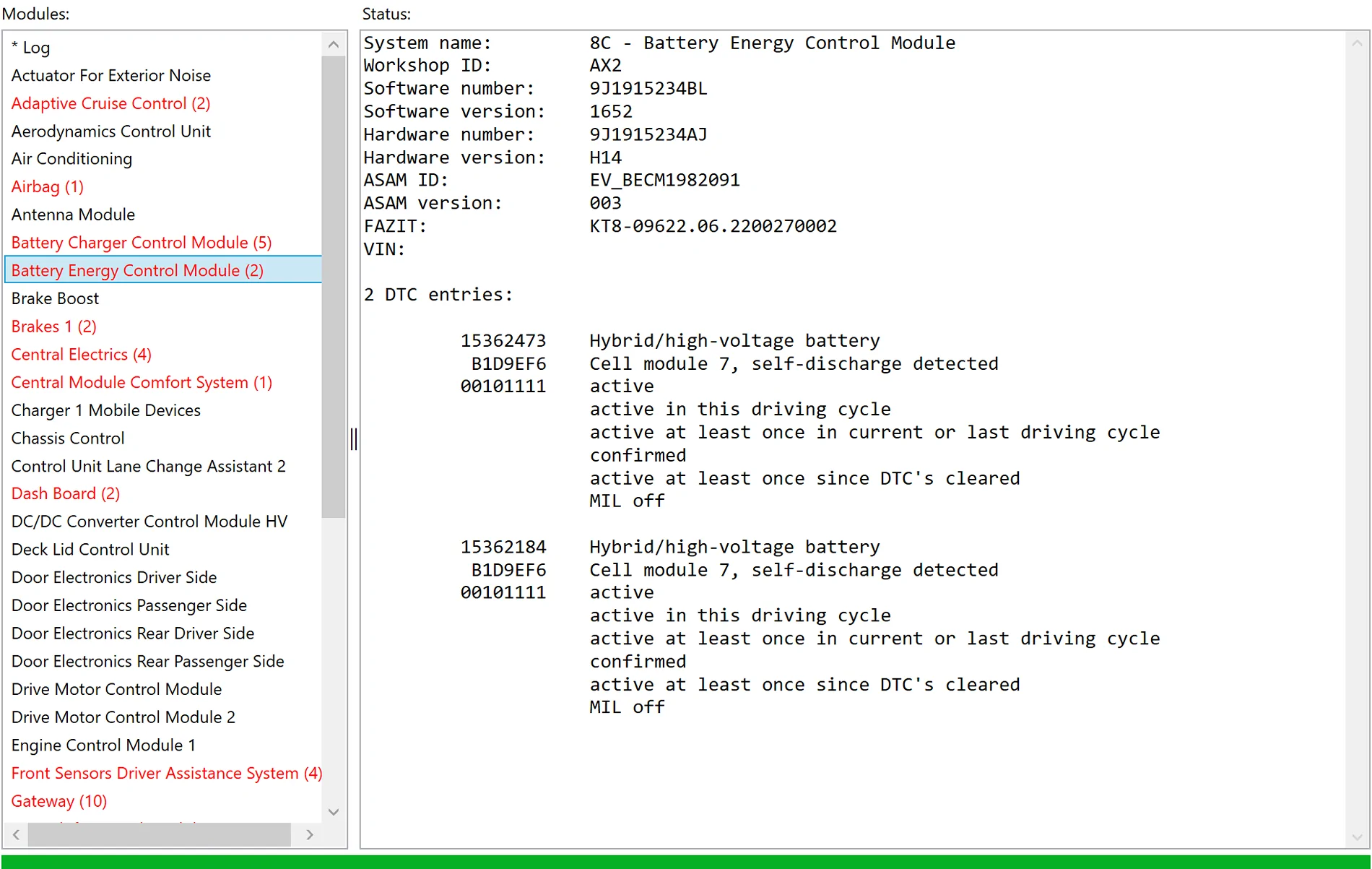

Using the MapEV software (thanks @prj ) I see an error indicating a problem with module 7 "self discharge detected". tCAN-pro software (thanks @ct14garage ) thinks everything is fine. Screenshots are attached.

I got exactly the same error when I tried to charge above 85%. Car now with Porsche waiting replacement of 2 battery modules, to come from Germany. They are saying it’ll be 2 weeks to fix.

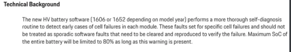

The TSB ā€˜fault inspection necessary’ one advises against clearing the code
If it's a stored value you can't even erase these faults.
If the s/w is properly fool-proofed, all faults related to cell modules are stored.
Why else would we have this new s/w anyway?
But hĆ©, I'm not a s/w developer...šŸ˜

If the fault code can’t be cleared, the TSB wouldn’t say ā€˜don’t clear it? The advice may be hedging or inaccurate.
But erasing a safety warning about a fire šŸ”„ to see if the fault happens again doesn’t seem like a good idea šŸ¤”
