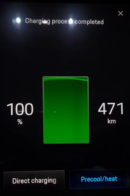

After 3700km range still goes up.
I was noting 270 miles full charge in the summer but now am not quite at 200 Mike’s in cold December. Quite s difference and on BBC an 80% rapid charge I’m really only good for 150 miles. My 4 tubes a year 375 miles trip needs two tops up and it’s a slight irritation.

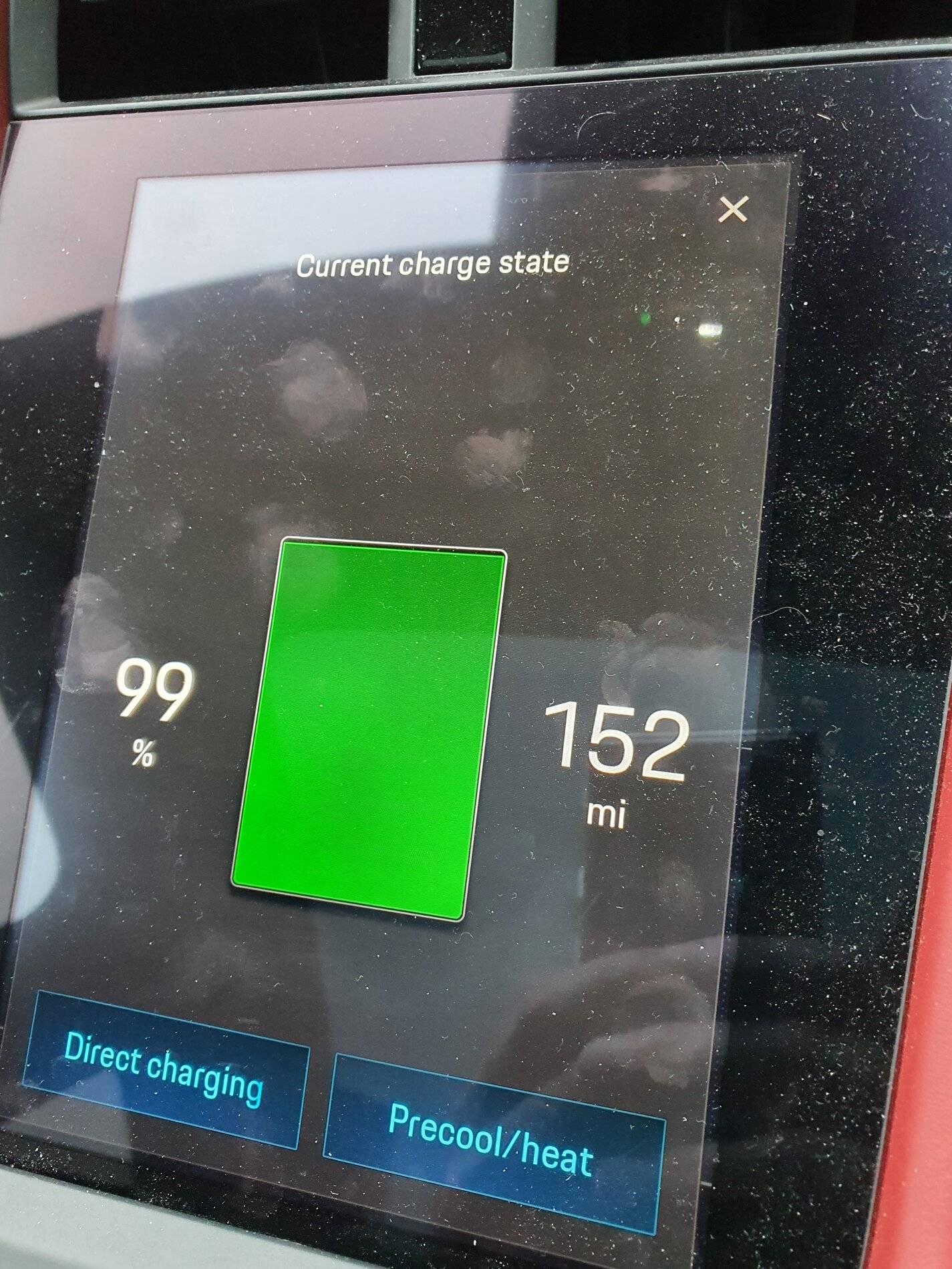

I hope so. Mine has got to be the worst -was 100 percent at 152,miles after opening the door dropped to 99 and driving out my drive went down to 96!
Geez. I am going on my first trip since the second lockdown over the weekend so can post some December figures. It’s about a 160 mile multi-leg round trip over two days and I was hoping I could do that without charging on the way, but sounds like range is still plummeting with temp. Will post the numbers and battery temps next week.
3,081
2,681
Wow!
Did you open the doors and leave it open for a few hours then?
And you must also have a hell of a long driveway?
Seriously what was the temperature and the battery temp then. Did you have the preheat running before unplugging?
That does certainly not sound normal to me!
