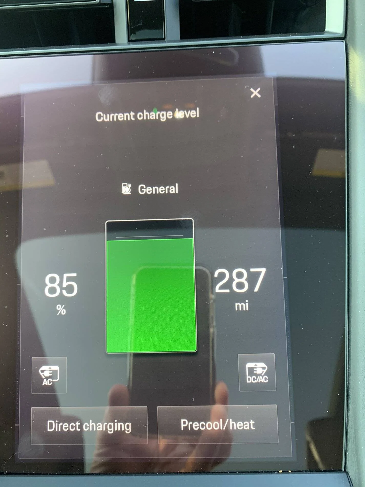

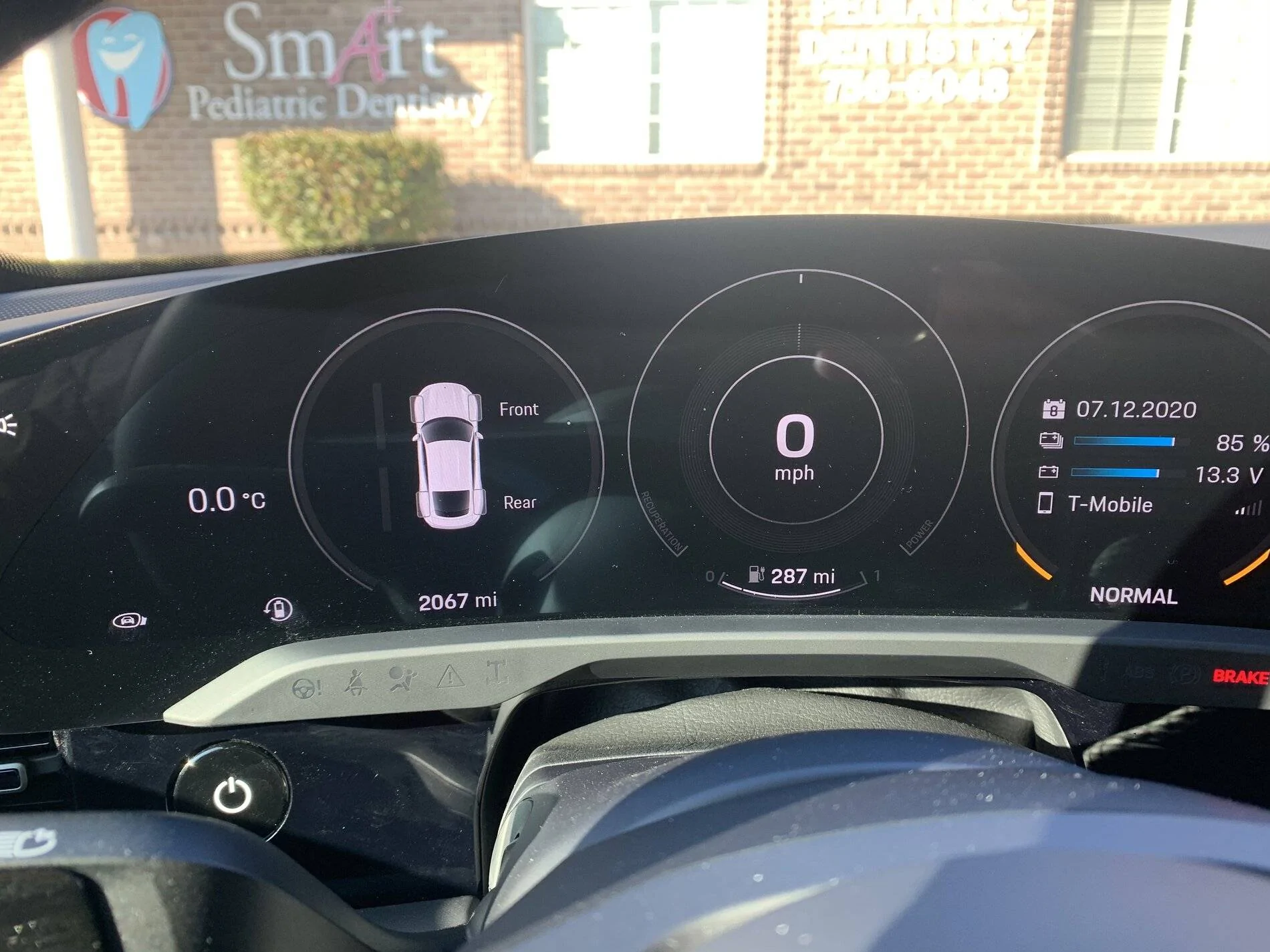

I have a red 4s with the same battery and live in a cold climate at 4500’ to 8000, altitude. Winter Pirelli P Zero Elect 20”.
While I do not commute as many miles as you I consistently see a range of 287 to 291 miles at 85% from -5 to 0 C.
Porsche Taycan 100% charge showing 175 mile range 77E2679D-02C7-4349-ACC5-27BF9DD58CD8
Porsche Taycan 100% charge showing 175 mile range 7DC467AB-42ED-4E3A-AFA2-66B8C1D69FF8
I want your battery pack lol
Wow, so you're seeing around 335 miles on 100%. That must mean you're achieving 25kWh/100mi... you must be the president/founder of the hypermiling fan club! That is insane economy.
