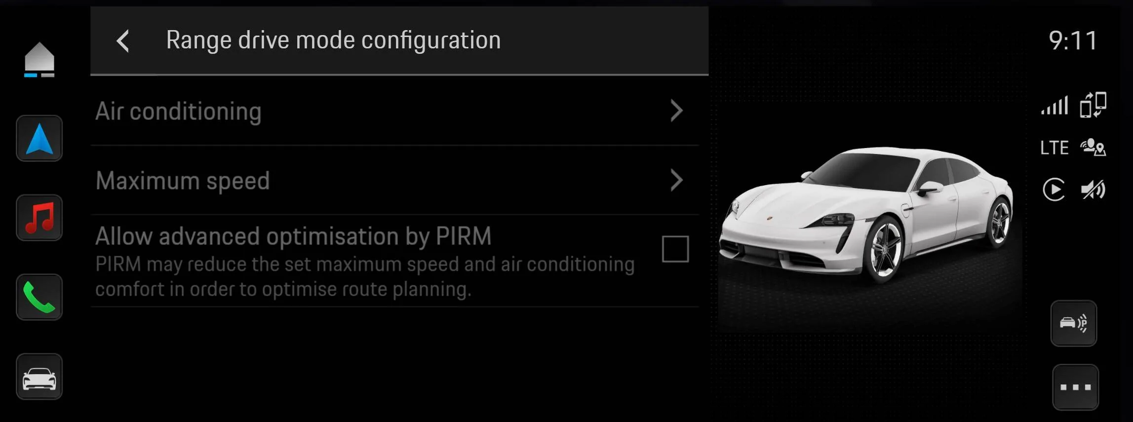

I would use range mode if I could work out how to nudge up the max speed. Looked in all the menus...but should probably consult the manual...

PCM -> Car -> '...' -> Range Drive Mode Configuration -> and then set your max speed

Note you can override by 'kickdown' to get of trouble if needed.
