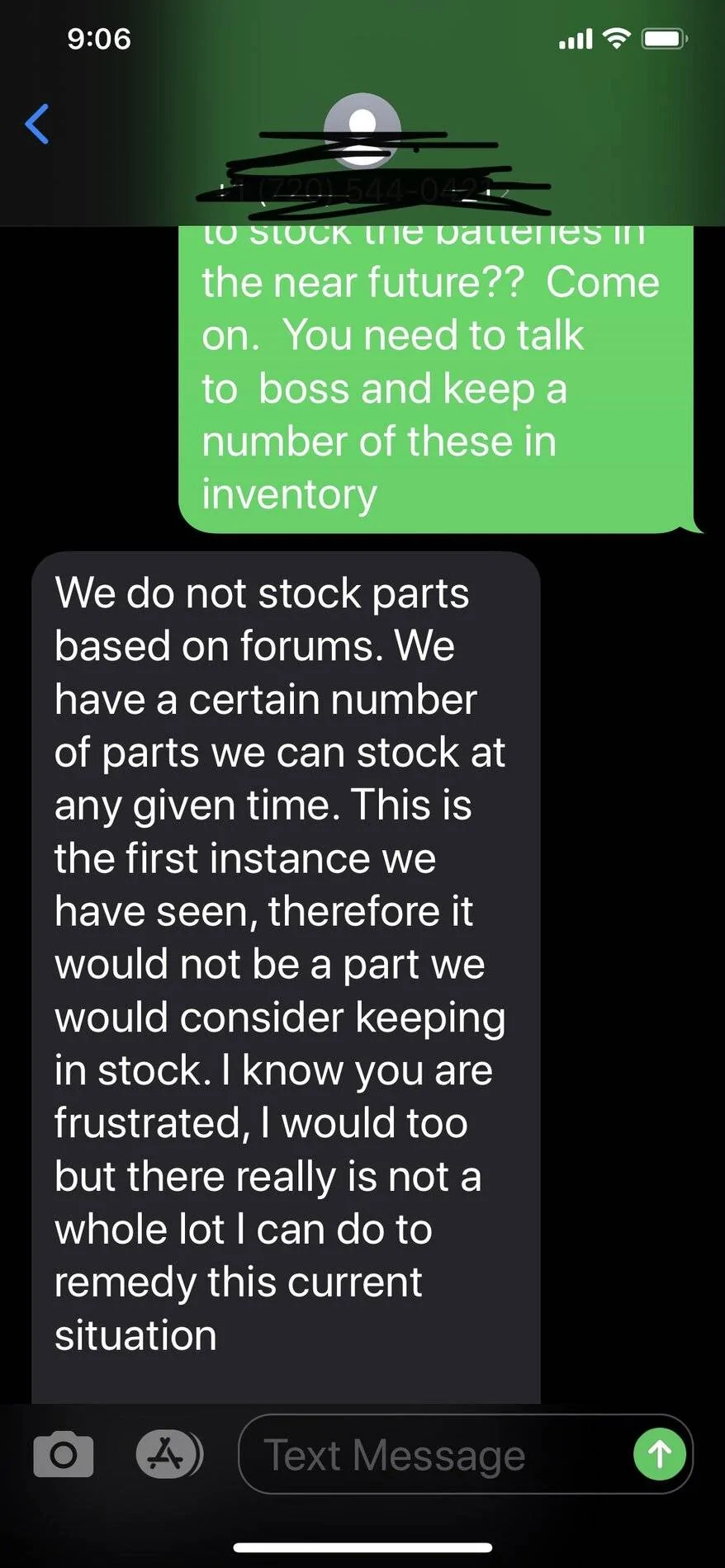

Some great posts have been added to this thread since last night, but I wanted to share a "humorous" text response from the head of service at my local Porsche dealership when I suggested that if Porsche knows this is a problem, why not keep an inventory of 12v batteries in inventory?
His reply is pretty funny considering all of the attention the 12v battery has be receiving over the past two days on this forum. While they are dismissing my Taycan as the first they have seen to have an issue, they have only sold 5 or 6 Taycan's so far this year. The are not accounting for the other ones that have been affected as well.
Seems perfectly logical and valid business response.
(I also strongly believe it isn’t a solution to the root cause problem.)
