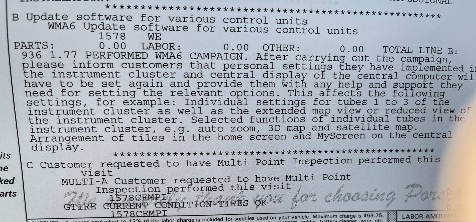

Alright folks. Got the car back and got deets.
Basically in my case - dashcam was drawing power while car was off however the main pack wasn’t charging the 12v properly. So while cam drained the 12v the software bug is the root cause. Latest software update in WMA6 campaign is latest fix.
Go to your local dealer to install the update. This is a control unit update. Since all my instrument panel settings were reset I am speculating this was a firmware update on hardware components in the car not just an OS/application software update for PCM. So it’s a serious attempt by Porsche to address the issue. See image.
Porsche Taycan 12V issue strikes another one 2BD66615-B443-4711-88C0-E191830F2506
