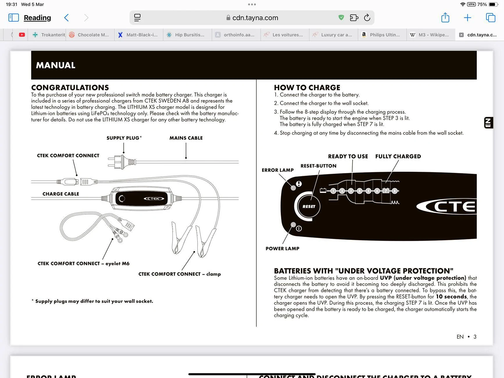

That is odd. I haven't needed the reset button on mine ever. I just connect it to the battery using the croc clips and plug it in.
If I understand the manual correctly the reset button on the CTEK needs to be used if the 12V battery is so flat it has gone into self protect mode. Pressed for > 10 seconds resets the self protect in the battery itself.

Mine is a CTEK Lithium XS UK since I am in England. It may be the same but the instruction book doesn't have that text.
It does say it may give an error if charging is interrupted during accept or analyse phases and need a reset. Given the accept phase is 30 secs maximum and analyse up to 3 minutes it would be unlucky given the whole procedure can be up to 42 hours for a reset to be needed if the charge is interrupted ;)

I have used the same CTEK Lithium XS charger since 2020 and been very happy with it. My unit will start automatically when plugged in and I have never had a problem with any power outage. It has come back automatically. We had some severe thunderstorms and the power supply suffered sevaerl times one year, but still no problem for the unit.
For me the RESET button has been used once when the 12 volt batter was depleted and the safety relay had kicked in. As per instruction all came back and the relay reset by pressing the RESET for 10 seconds or so.
Porsche Taycan Issue with 12v battery IMG_2451
I have been very happy with this unit for 5 years and used it on the Taycan and a few other marine batteries.

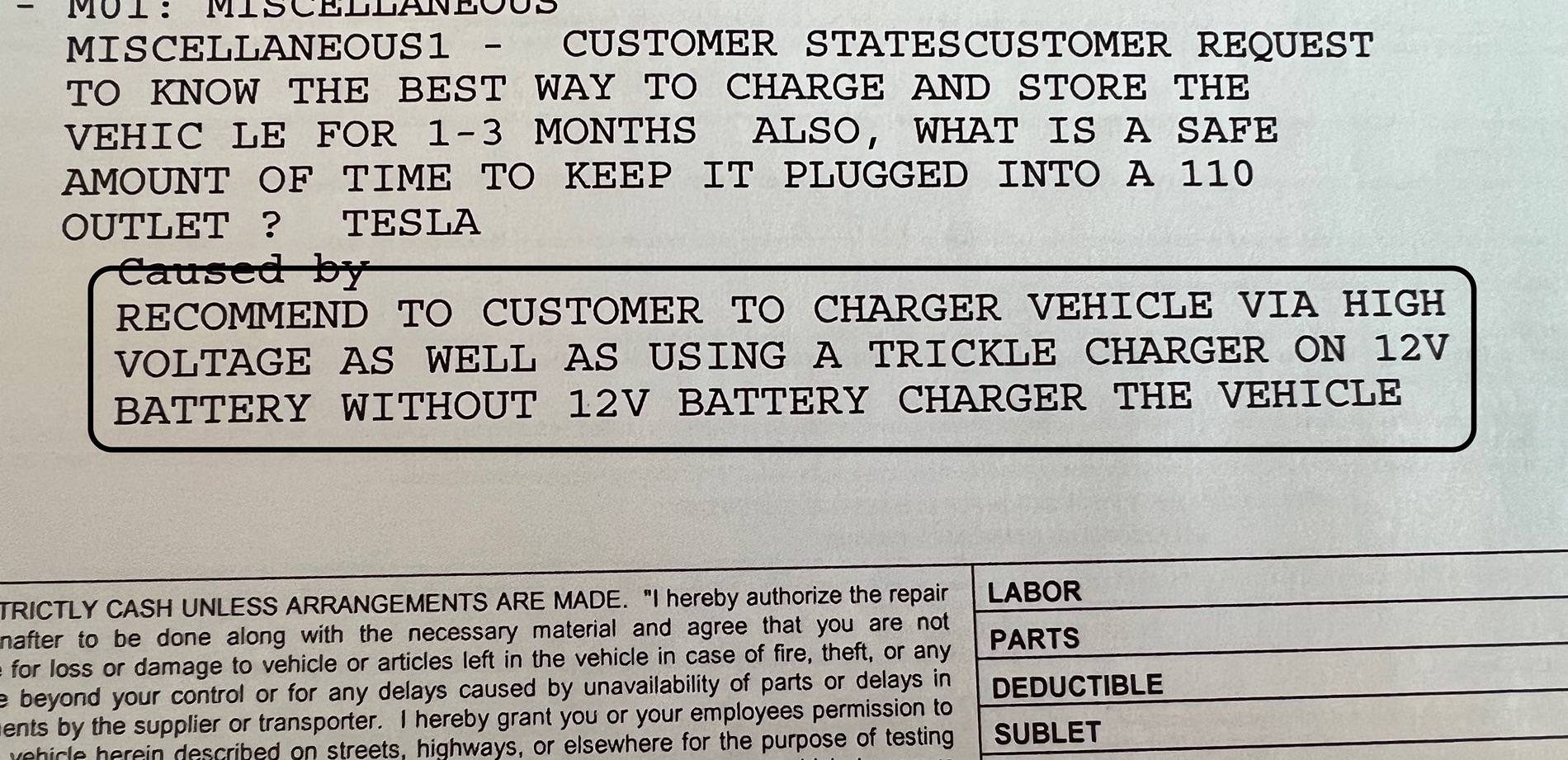

Yes, have read the threads, and the read the manual. Just picked up my 2021 4S from the dealership (Reno), after a multiple-recall service. Asked the service manager to clarify best way to maintain both batteries during one to three month winter storage, inside my home garage. Their answer: Store with wall charger attached, plus trickle charger attached directly to the 12v battery (using gator clips, NOT cigar lighter port). Suggest you all just take this as "one more" view, yet from [what should be] a decent source (Porsche dealer service manager). Ignore the 110v question, and the "Tesla" note, as those were unrelated questions. And do pay attention to charging level pre-sets, use of timers, and so forth....all well covered in earlier thread comments.
In conclusion, having been at this for three years of 4S ownership, and three winters of home garage storage, this is my plan:
1) Attach wall charger.
2) Set timer to charge every Monday, to a 60% charge level.
3) Attach trickle charger, using gator clips, directly to the 12v battery located in the frunk.
4) Follow other owner's manual instructions for tire over-inflation, etc.
5) Continue paying attention to the great community we have here on Taycan Forum, and doing my best to contribute!
