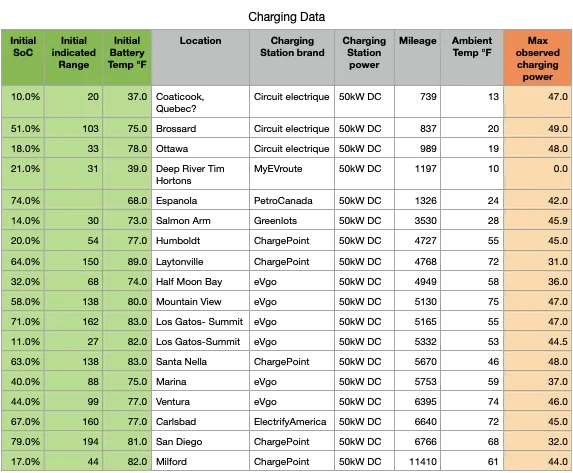

Of the 50kW charging stations I connected to on my trip, He's the maximum Observed Charge Rates (that is, what I saw on the center console screen during the session, accuracy not guaranteed):

Well there you go, proof that what was reported at 37KW is an anomaly and that DC to DC conversion is not that bad. I think a lot of variances are from charger and conditions of the car/battery.
I love the detailed data Don, that is spectacular. If I could ask for a future column added would be the maximum current for the station which you can get from the tag on the side. I have noticed that it matters a lot on my Chevy bolt EV. As some stations are 125 amp and some 150 amp. The issue is that to get 50 kilowatts out of these hundred 25 amp stations you need to be right at 400 volts and generally the car does not get the batteries to that level until pretty late in the charge and by then it's often tapering down. Not sure what voltage the dc-to-dc converter requests, but if it is a fixed doubler as opposed to a variable converter then it would be asking for only 360 or 375 volts which may explain your times getting less than 40 kilowatts. But it's hard for me to do a complete analysis without having the raw data.
Also @epirali, I do not think it is quite a closed topic as I thought Don's car had the 150 kilowatt DC-DC converter. So I guess we would need someone with out of the upgrade to do the test and see if they can get this 47+kW which is great! I am quite hopeful though, I believe that the converter that they would use would be well above 90% efficient so I am hopeful.
