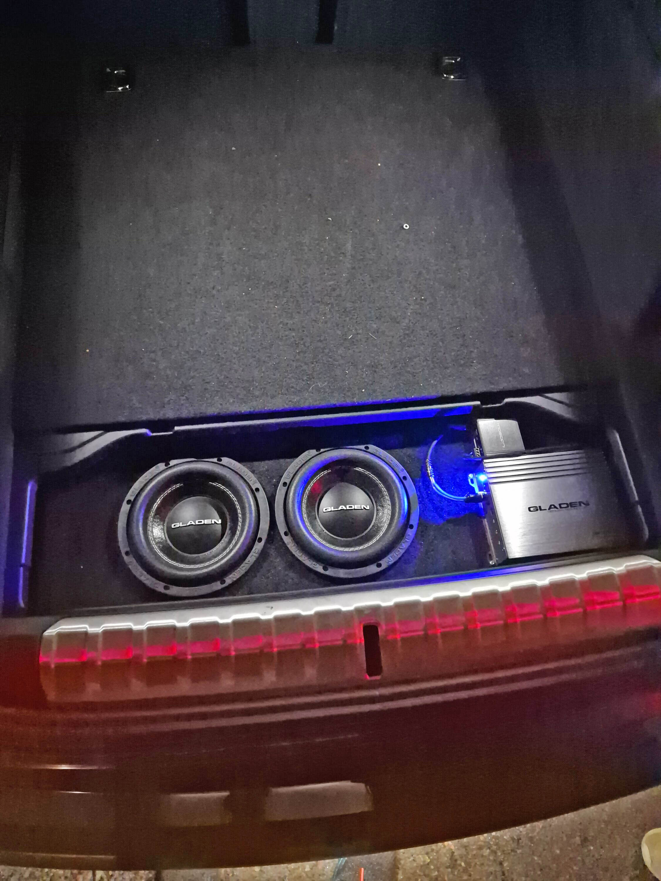

Taycan 4S Subwoofer Upgrade (Bose from Factory)
I decided that the bass provided by the Bose system wasn't sufficient. I contacted a local shop and booked an appointment for mid-September. On the morning of the appointment, the shop informed me that they didn't have the components I requested (JL Audio 6" box x 2, JL Audio 500W amp).
I went to the shop, and after exploring other options, the technician started to disassemble the car. However, after 2 hours, they mentioned they couldn't find a suitable location for a 12V power source and were hesitant to connect it to the 12V battery. After a few more hours, I left the shop without any upgrades.
I then called around and found another shop willing to perform the installation.
The new setup included 2x Gladen SQX08 subwoofers in a custom MDF box, a Gladen RC600.1 amplifier, and a Mosconi Atomo 4 to 6 DSP (not necessary, but I wanted to adjust the factory sound curve for the sub). Power was sourced from the power distribution unit at the back of the car.
This upgrade transformed the car's bass quality, and I wish the previous owner had opted for the Burmester system. I'm extremely satisfied and recommend this modification to anyone feeling that the Bose system lacks bass.
This upgrade transformed the car's bass quality, and I wish the previous owner had opted for the Burmester system. I'm extremely satisfied and recommend this modification to anyone feeling that the Bose system lacks bass. View attachment 60094
Do you have to leave the subs and amp uncovered or do you have a trim piece that covers everything?
From my testing it sounds better without the cover, of course if I use the boot I will put the cover on.

I've been pretty surprised at how rumbly the woofer is with the Bose base setup (the car shakes delightfully with Skrillex's latest album :) ); how much of a change would you say the new setup has made and what genres of music do you primarily listen to?
humppis
humppis
Sep 22, 2023
Finland
Porsche Taycan 4S Cross Turismo
I mostly listen to Rap,House,DnB,Phonk and it's night and day difference.

The original Bose in my car is OK. I go with the notion that if it's OK, then that's sufficient for my needs. Car audio is never amazing, albeit I've dabbled a lot when I was younger and had a lot of fun doing it. Because it's the least controllable place for sound/speaker placement I've left most cars I've had as the quality works in that environment and at home I make sure I get quality
Having said all of that, I think that looks nice and clean so congrats and enjoy! Have you got a custom cover that let's the sound fill the cabin, instead of using the standard cover? A custom one looks like it would be really easy to do with some decent mdf and car felt/carpet and maybe some wire mesh covering.
