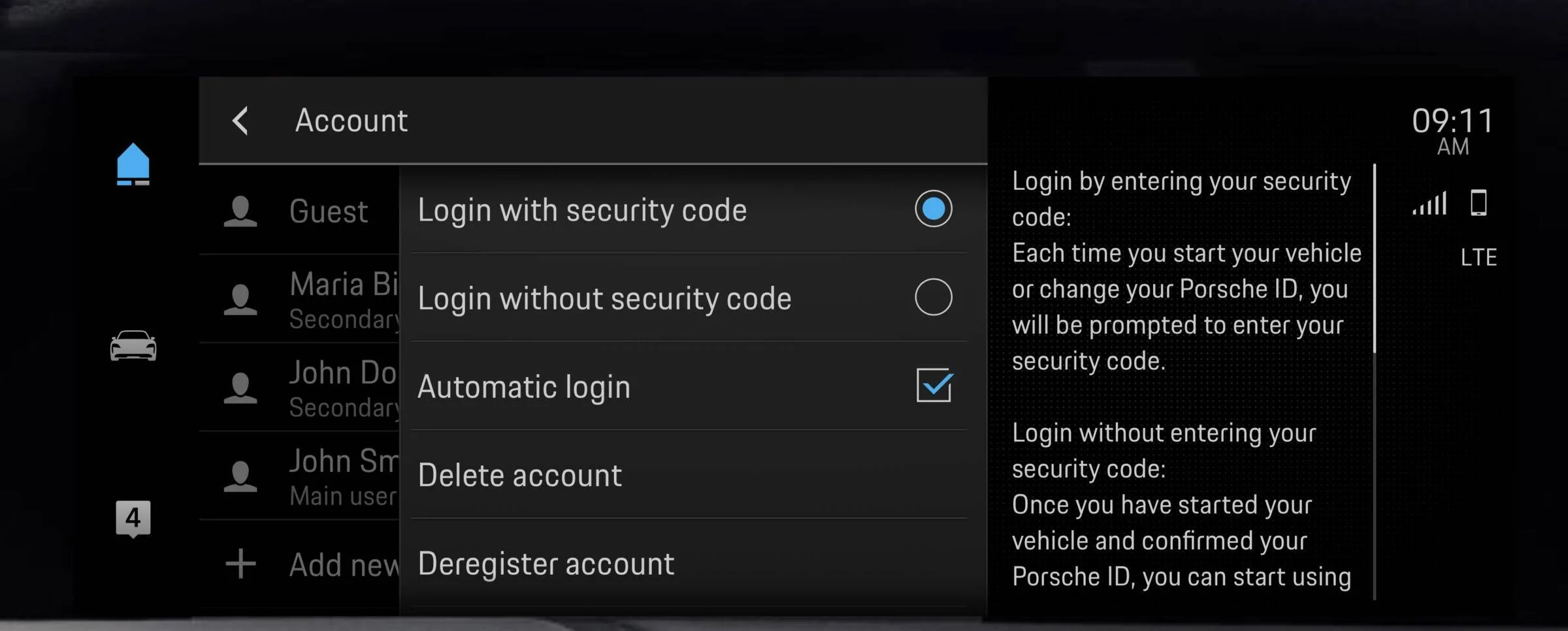

Will get them to do the porsche id thing - they should have done it during their set up. Is it easy to turn off the pin code requirement?
Yes.

Thanks. found it on the simulator now! Any idea what the difference between automatic log in and login without security code is?
Automatic uses your PIN once and then never asks whereas the latter just logs in without a PIN.
