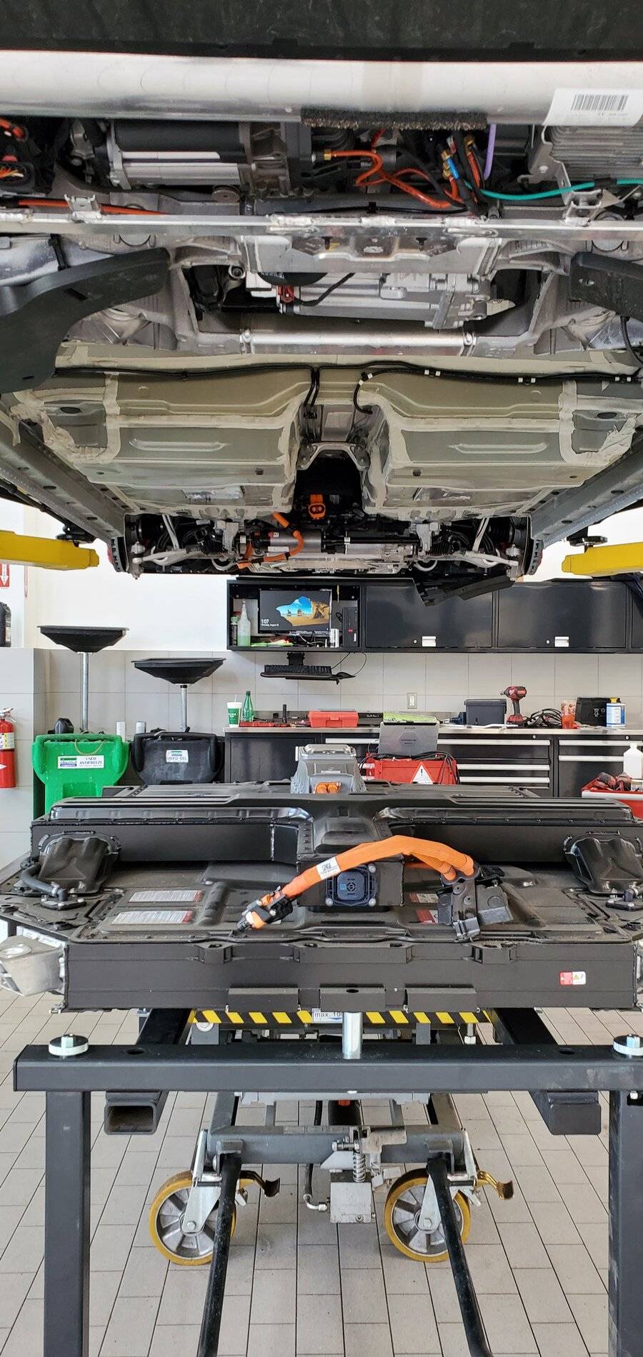

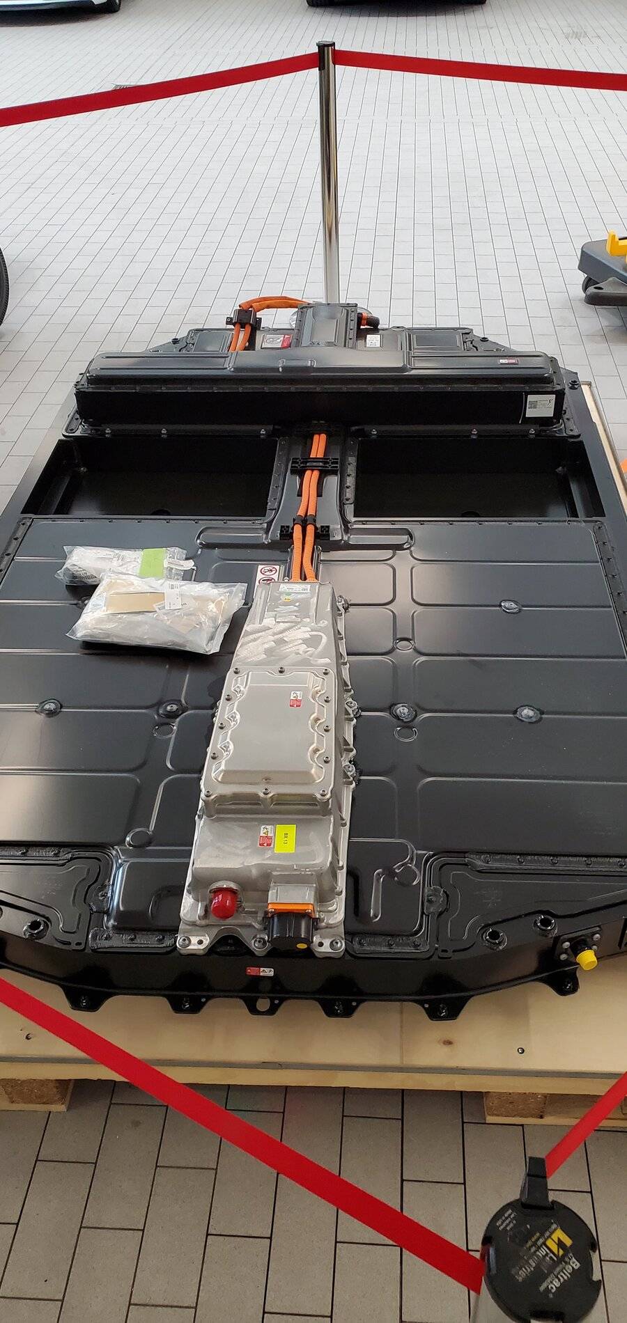

We replaced a battery in a Taycan in 2 weeks. 2 weeks from when the car arrived, and when it left. The job itself was done in 1 day. Waited about a week and a half to get the battery from Atlanta to Los Angeles. If you opt to have the battery replaced and keep it, it will essentially be a new car with a new 8 year warranty. I wouldn't mind that if it were me. But like someone else mentioned, I would get Porsche to pay your 1 or 2 month lease payments. Or for however long it's down for.

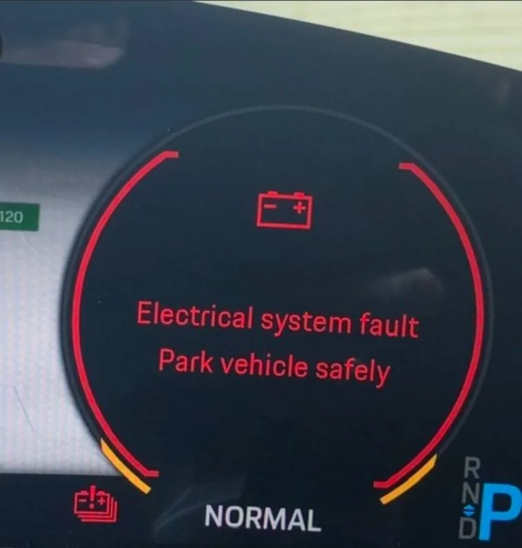

I took delivery of a 2020 4s in August 2020. Five weeks ago, I experienced the dreaded "Electrical System Fault," and had car hoisted onto a tow truck the next day and taken to the dealership. First diagnosis was defective 12v battery. Dealership, as a "goodwill gesture"!!, offered to pay 75% of $600. I declined, pointing to the warranty. Dealer said Porsche was saying that the car needed to be driven 15 miles a day, and I was driving only 12 miles a day [6.600 miles in 18 months](this is actually in the boilerplate of the warranty, but nowhere to be found in the owner's manual). I pushed back, and Porsche agreed to cover the 12v battery 100%.
But, that didn't resolve the issue. I was then told that modules in the battery pack failed, and they need to replace the entire battery pack. That didn't seem to be much of an issue until I was informed that there wasn't a battery pack in the US, Porsche would need to ship it from Stuttgart ("ship" as on a boat, not on a plane), and it would be 9 weeks until the dealer had the replacement battery pack. Porsche has put out a lot of PR about replacing the modules in the battery pack to facilitate repair and increase sustainability, but when quizzed about this, response was they couldn't assure that the battery pack would operate properly if only the defective modules were replaced. I quizzed the service manager as to whether they had proper level of trained mechanics and specialized hoist for this job, and was assured that they did. I've been told that Porsche will cover 100% of the cost of the battery pack. Have considered the lemon law, but being an attorney, I'm not sure that's going to help get me rolling quickly.

That's a lot to go on. I'm a parts manager at a dealership, and I knew what kind of problems we are seeing with some Taycans. But I still love the car enough to lease it. I'm just on my 4th week of ownership and have not had 1 problem, besides the interior alarm going off.
First, what is your VIN? i can check to see if a battery is available in the US. I too questioned, why we could not just replace individual battery cells/modules instead of replacing the whole battery. I haven't gotten an actual answer, but as I understand, it is easier to just replace the full high voltage battery. If it happened to me, I actually would prefer to get the full battery replaced anyway, and not just a few modules.
We've only done 3 so far in the 2 years since we have opened, with potentially a 3rd on the way. A taycan that was taking delivery of his at the same time I did, is already back in the shop for battery related issues. Our gold level techs are actually really good with the Taycans. They are consistently sent out for a week at a time for training. A full battery replacement merely takes 3-5 hours to complete.
Porsche will definitely try and make this right. Whether that be through compensation or something else. Hope this helps.
