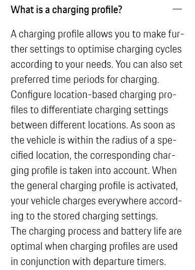

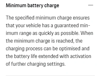

Apologies but I think this description is confusing - in particular "minimum" vs "maximum".
Minimum means exactly that "minimum"
Porsche Taycan 85% Minimum Charge Not Working 1707158544383

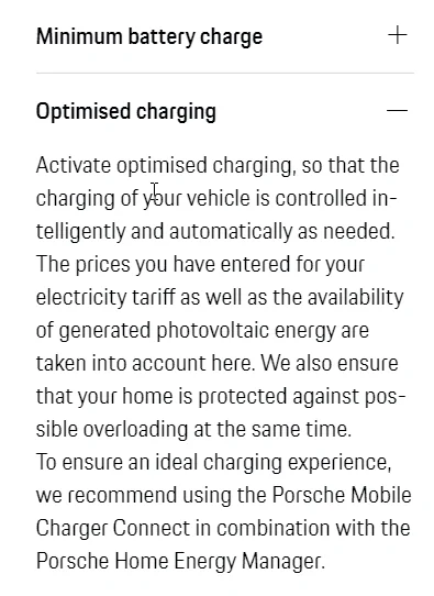

Optimised charging relates to something else entirely and requires the use of a Home Energy Manager (HEM).
Porsche Taycan 85% Minimum Charge Not Working 1707158595921
The purpose of the Timer is to control start and end times within which the desired target charge level should be reached (if possible). A profile on its own is not enough to control the charging session without risking over charging the set target rate.
Porsche Taycan 85% Minimum Charge Not Working 1707158683772
Choosing a timer window which encapsulates your cheap rate tariff can be programmed.
For more sophisticated programming / tariff friendly programming then a HEM is needed OR choose a provider which can integrate with the Taycan PCM directly (e.g. OVO or Octopus in UK) which will charge at periods of their choice charging the lowest tariff possible.
All profiles can be managed from My Porsche App, My Porsche website and the PCM. Only location based profiles can be deleted. There is always 1 profile available named "General" which can be configured, enabled or disabled but not deleted via My Porsche App or My Porsche website.
All of this has been standard since the Taycan launch 2020 and is Model Year (MY) independent.

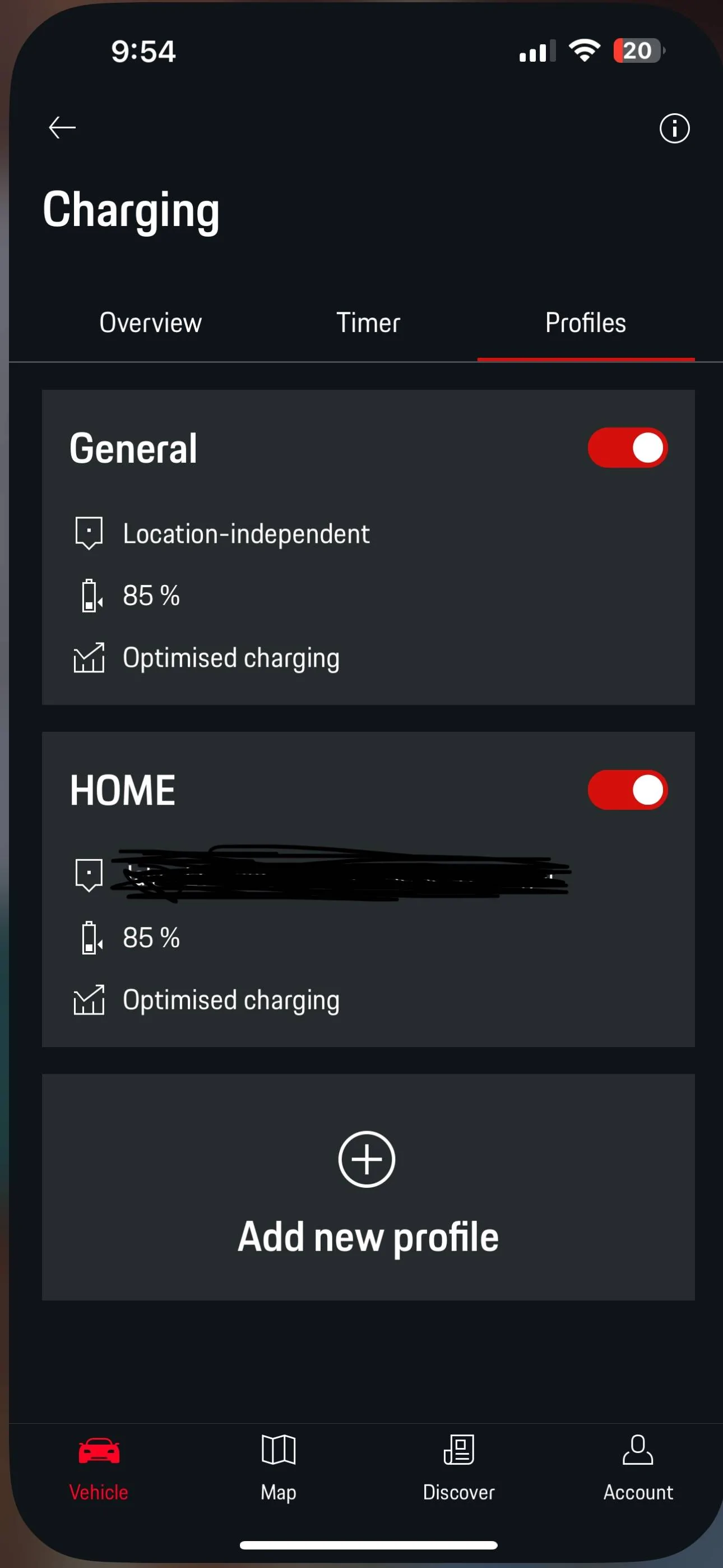

Sorry, but I stand by my description above. With only a non location dependant profile set to 85%, whatever else I set either timer wise or via my EVSE, unless I specifically ask for more than 85%, it always stops at 85%. I can leave it plugged in for days and it won’t charge above this.
I think it’s more a case of language semantics. Specifically, the home setting will always immediately charge to that minimum %. Non-location, it will charge to that minimum level, but only when you allow it to…optimised charging. If you don’t set any other level, then it won’t charge any further as you haven’t told it to via any other means. In effect, the 85% becomes a max charge state, but fair enough, by default. This is exactly how I was told it would work by my SA, and it’s worked every time in this way.

The only difference between a General and Location-based profile is simply whether the profile is automatically invoked or not. I have 2 charging locations and therefore have 2 location based profiles. The setting of each profile is different. The correct profile is auto selected when within range of the nearest location.
There is no need for a general profile unless you do a lot of public AC charging (why would you?) but if active and location isn't then these parameters are used / become generic. That said, most people will have a General profile always active in case of public AC charging (otherwise they likely can't charge their car) or remember to enable Direct Charge to bypass both profile and timer.
To use optimised charging (implies time windows and tariff rates pre-programmed) requires further infrastructure such as a HEM. Folk will use on of these to take advantage of solar and grid power in tandem in order to leverage the most cost effective and efficient means of home charging.
A profile on its own with optimised charging doesn't do anything other than charge until you stop it.
