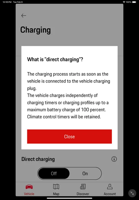

This YouTube is clear and may help.
But note that apps such as Octopus, OVO and other non Porsche apps will override the car’s profile and timer. I find those unreliable and simpler just to use the car to control everything. That removes the internet and 3rd party connectivity dependency.
It is also worth checking that ‘direct charging’ is not set on the central console. That overrides all profiles and timers. You’d typically use it when using a public charger or if you want to override cheap rate home charging. Direct charging means ‘charge now’.

In the case of OVO, if you don't use their app then you don't take advantage of the off-peak tariffs and so this is key. Charge Anytime is child's play to set a timer or instant charge (this disables cheap-rate).
Direct Charging is only relevant to AC charging and has no impact on DC charging.

Also, I saw this early on and forgot about it. If you have Direct Charging On, vehicle will charge to 100% so everyone who doesn’t want that should turn Direct Charging Off.
#sigh. Someone should have mentioned that a page earlier as the possible issue OP was having.
