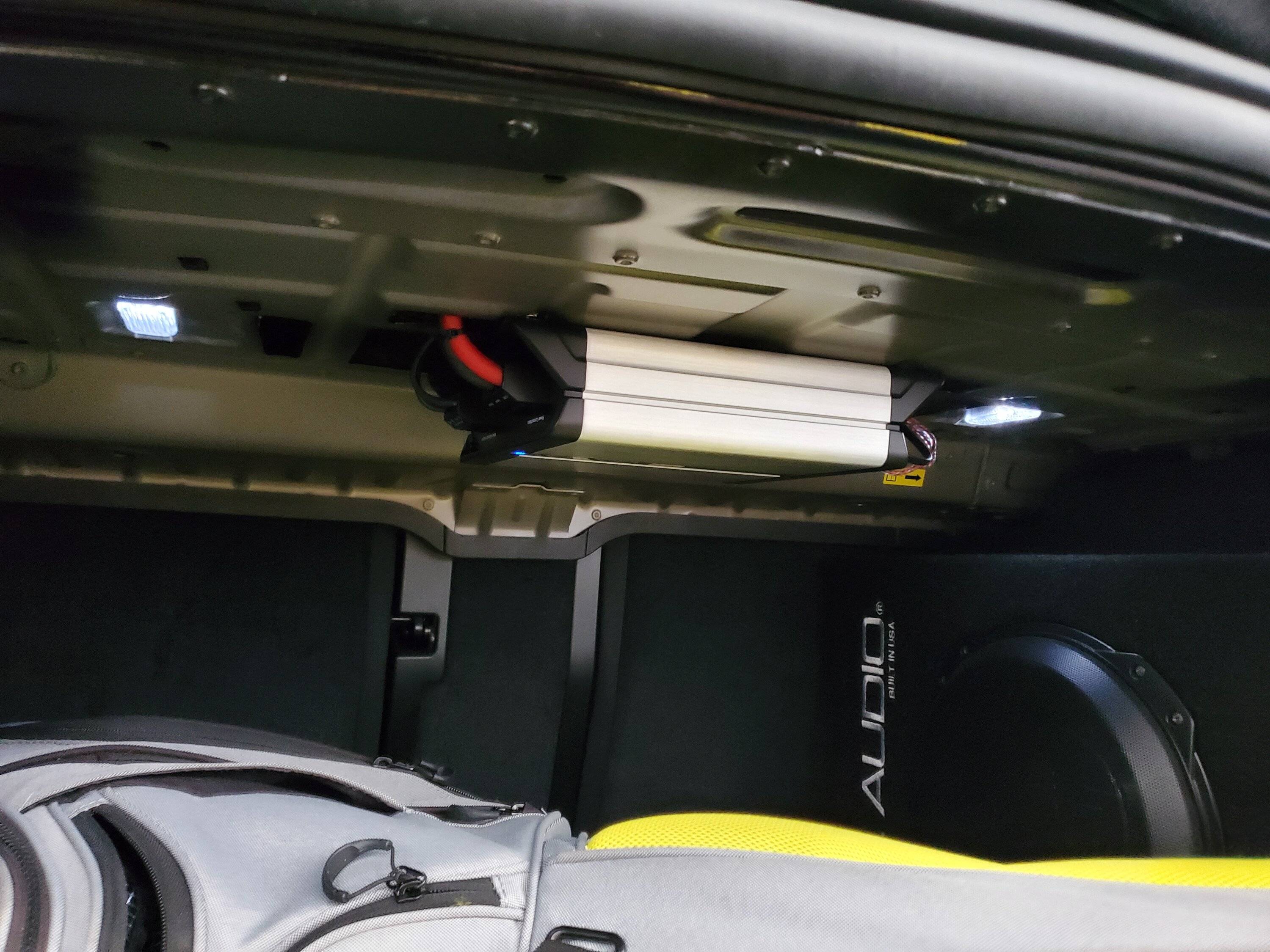

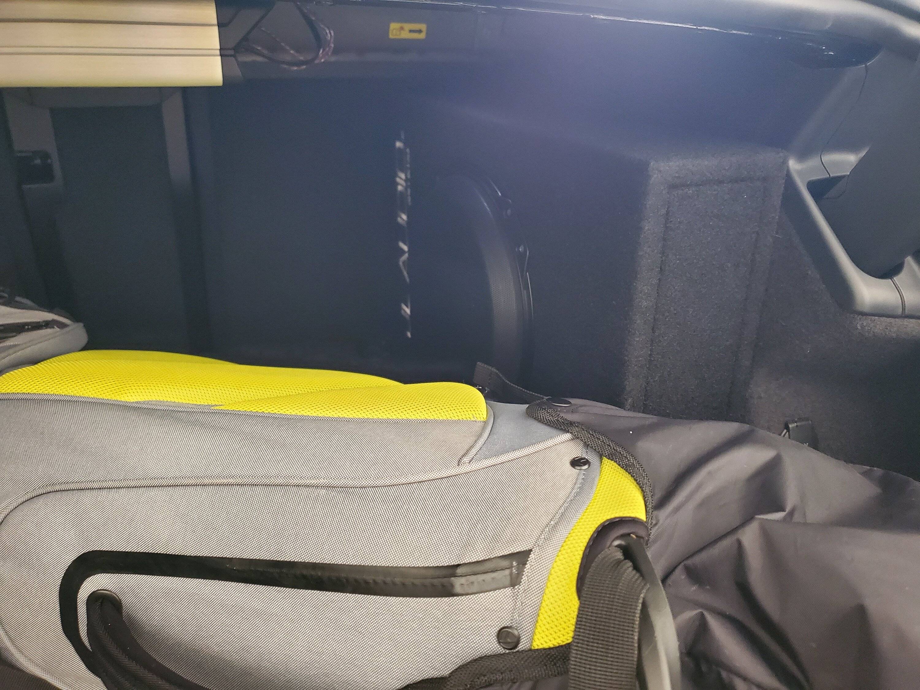

I have the Standard Audio System.
The Taycan is my first porsche ever. I couldn't believe that a luxury brand vehicle would have such terrible base audio system.
In my opinion (although I'm not an audiophile), the highs and mids are the only thing that I can hear with the base system. After long discussions with my local/reputable, stereo shop, we're going to start with adding in lows, and expand our way from there to see where needs improving.
I'm adding a JL Amp and 10" slim box subwoofer in my trunk. It'll be mounted to the side wall and only remove 5" of space.
Not sure if anyone else has experience in swapping out the individual speakers. That would be helpful.
Did you end up doing this? Do you have any photos? Where did they connect the amp? Did they do a speaker level input (line level)?
I have ordered the Bose system which comes with a subwoofer but I am a hip hop music fan and like a lot of bass in my music. Most OEM car sound systems don't have enough bass for me so I'm wondering if I'd be able to improve my Bose system (bass wise) if it's not enough for me.
I did. And I love it. I'm a huge Hip hop fan as well so bass is very important for me. They even added an adjustment knob in my footwell.
Here's a photo of where the amp and sub are mounted. Mounted it on the right side because I have the 2+1 fold down seats, and it's a bigger opening on the left. (Don't mind the golf bag, too lazy to take it out).
Porsche Taycan Anyone happy with the standard sound system? 20221206_115559
Porsche Taycan Anyone happy with the standard sound system? 20221206_115610
Nick808
Nick
Jun 16, 2021
Honolulu, Hawaii
I should also add that the area where the amp is mounted had ports/holes for speakers. I'm assuming the OEM upgraded sound systems have more speakers mounted here. But with the base sounds, these were empty. Someone with the other systems can probably correct me if I'm wrong.
