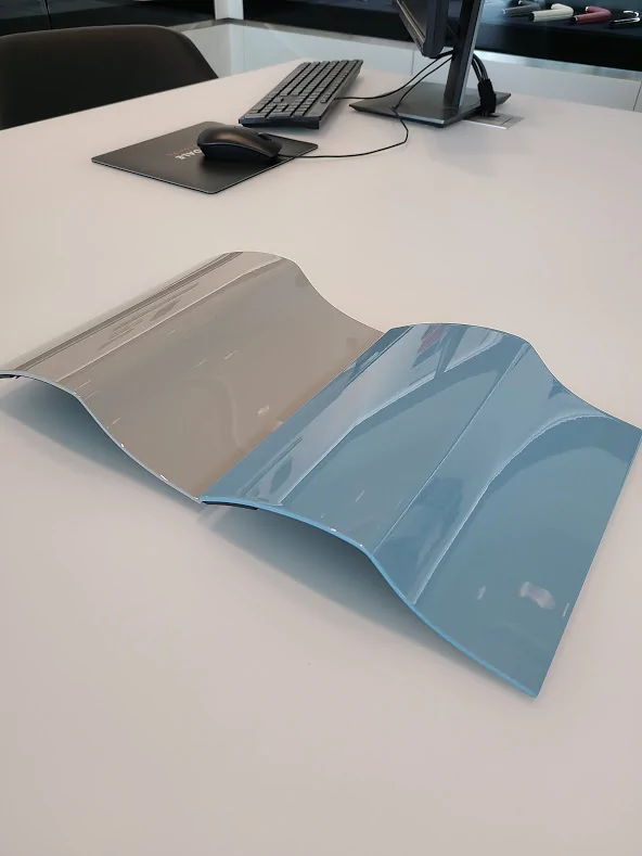

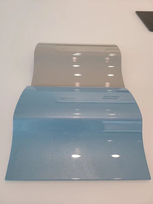

Hi luke
Thanks for this - can I ask have you a sample of crayon - really going back and forward between frozen blue and it
Thanks again
Sure!
Porsche Taycan Ask a Porsche Dealer Anything 1598457527848
Frozen Blue Metallic vs Crayon (Chalk)
Porsche Taycan Ask a Porsche Dealer Anything 1598457544248
Very different colors, especially once they're on the car. Frozen Blue is almost like a Baby Blue whereas Crayon (Chalk) is closer to a Concrete kind of color...
