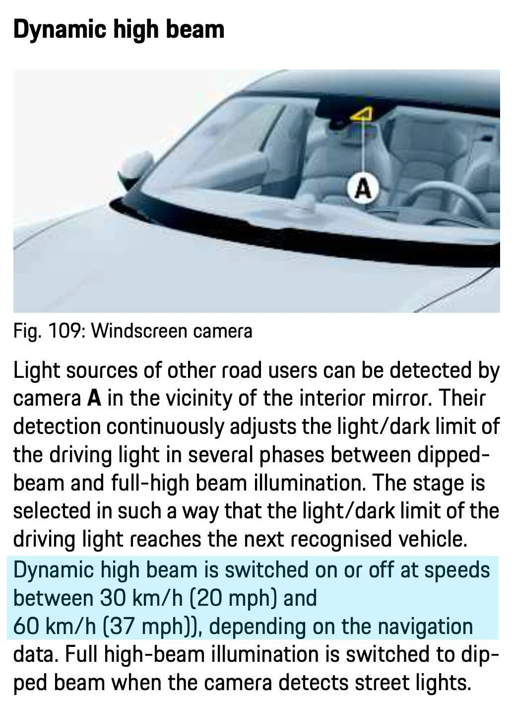

In the US it is 40 MPH for them to engage. You can then go slower and they will continue to activate and disactivate at least for some period of time.
Leaving my neighborhood, there is a road with no street lights with a speed limit of 30 MPH. You really don't want to do more than 35MPH, narrow road, wildlife, sometimes branches from fallen trees. What I do is briefly hit 40MPH, auto beam engages then I can go back down to 30-35 and they continue to work. That stretch of road is about 2 miles. It works for the duration of that stretch. After that I may be going faster but I THINK at some point it resets and you again need to go above 40MPH before auto beam re-engages, I don't know if that is really true or what the threshold is.

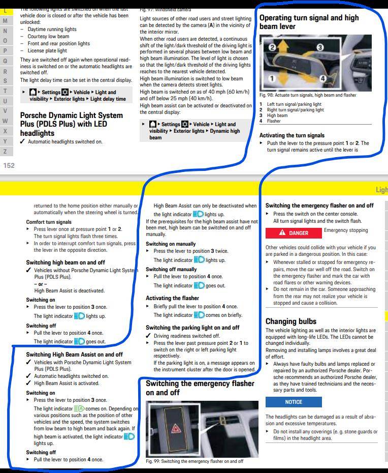

I'm also annoyed by that minimum speed for auto high beam to activate. But they are fortunately easy to switch between auto and manual high beam, and maybe some have not found this out: press the stalk forward. If it's auto it switches to manual high; if it's manual high it switches to auto. At least in my car. So the irritation is a bit less prominent than it was..
778
4,656
3,776
I don't use it enough to remember and keep fiddling with the stalk. Your explanation is a lot easier to follow than the owners manual:
(The complexity is that if you have auto high off, and you want to turn on high beam manually, you have to press the stalk forward twice - the first push only turns on auto but does not turn on high beams.)

In Europe, driving with high beams in the local area (50kmh) is not allowed. That's why it only switches on when you drive faster than 60kmh.
