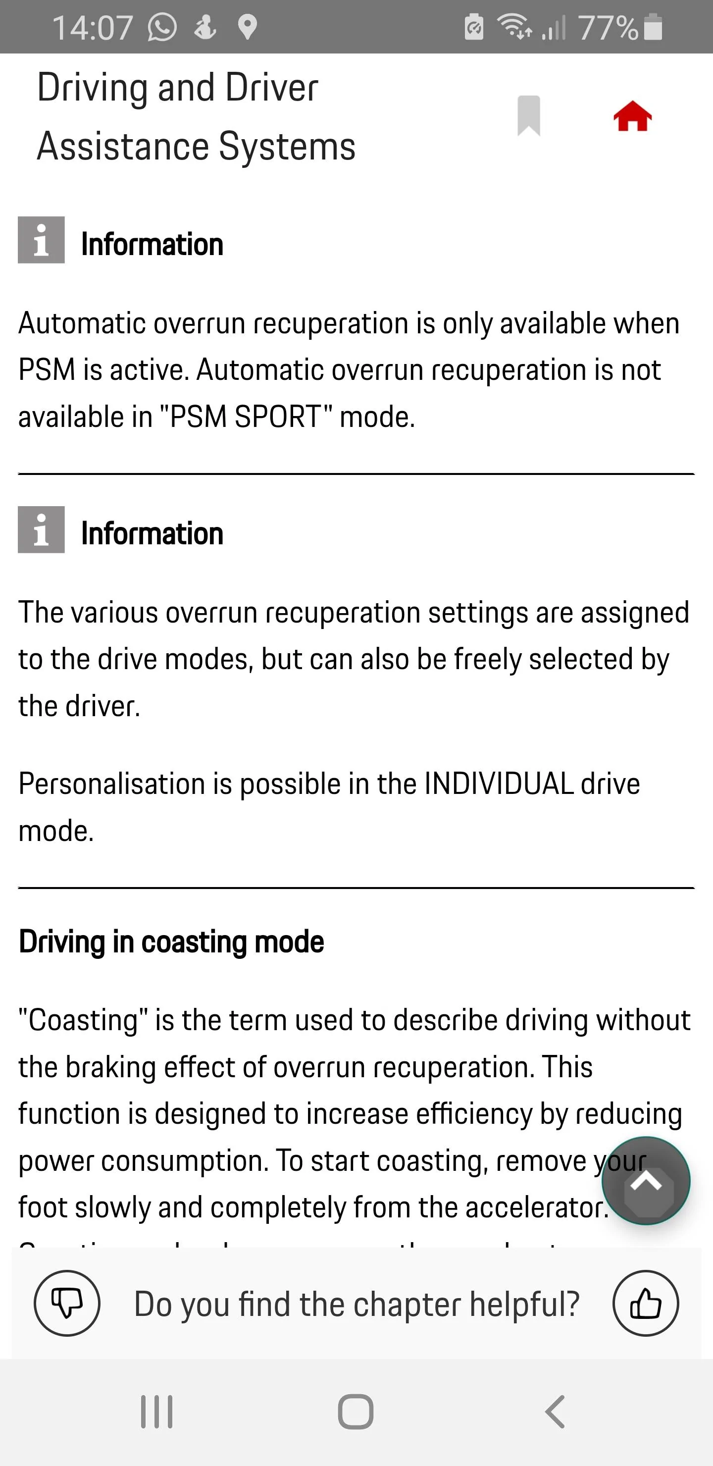

Could be a misprint in the PGTK or a software update change since printed. Refers to PSM Sport mode and not drive mode.
Ok. I was talking about drive mode as we were also talking about range mode.
