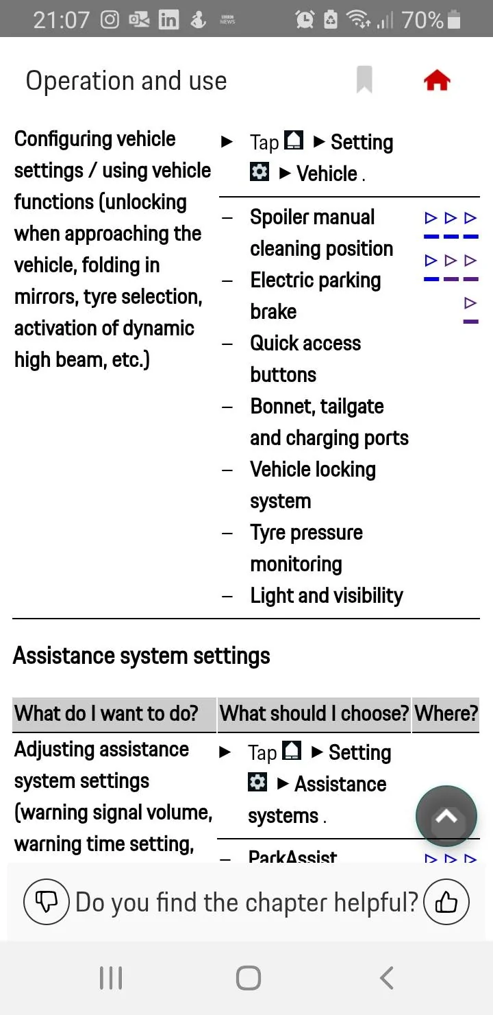

I have just taken possession of my 2021 Taycan 4S. I have finally got everything set up to my liking but I can't figure out how to set up the mirrors to autofold when the car is locked and to unfold when the car is started. Does anyone know if this is a programmable feature on the Yaycan?

Vehicle locking settings option in PCM alongside comfort settings. Set to off by default annoyingly.
Holding the lock button on the key will do the same.

Download Porsche Good To Know App - you'll find it really useful to find obscure stuff.
Porsche Taycan Automatic Mirror Folding with Door Lock? Screenshot_20210325-210723_Porsche Good to kno
