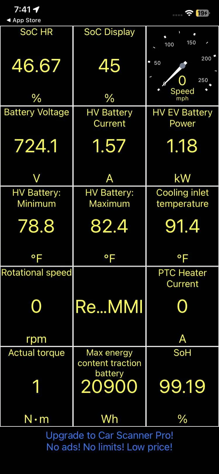

1) Delivery Soh - unknown
2) Current SoH - 99.19%
3) Current mileage - 1560
4) kWh DC charging -minimal, whatever they did at the dealership before I picked it up
5) Build date -July 2022
Porsche Taycan Baseline for HV Battery SoH Performance 523EFE45-02D1-40B6-BD1F-A5CB040DD480

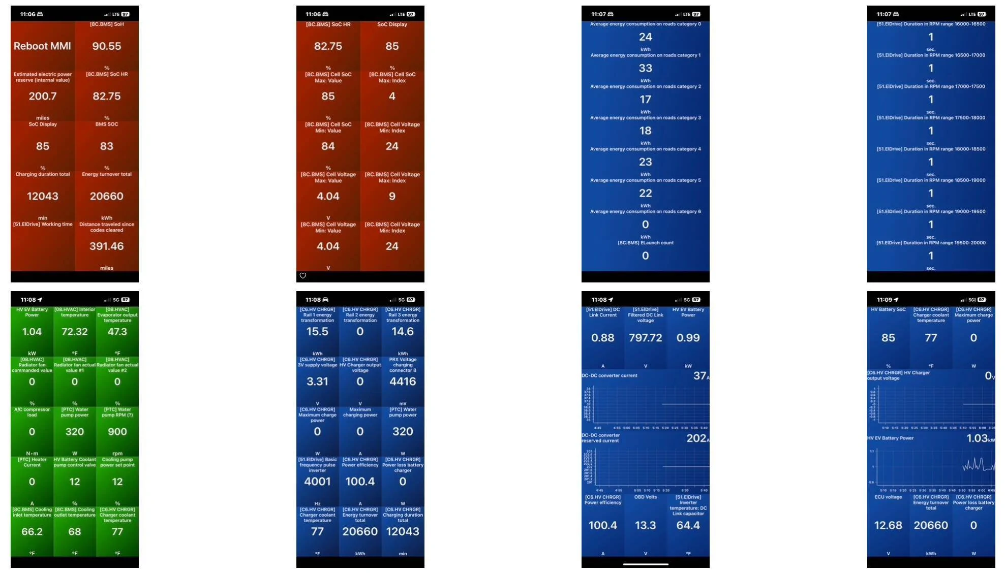

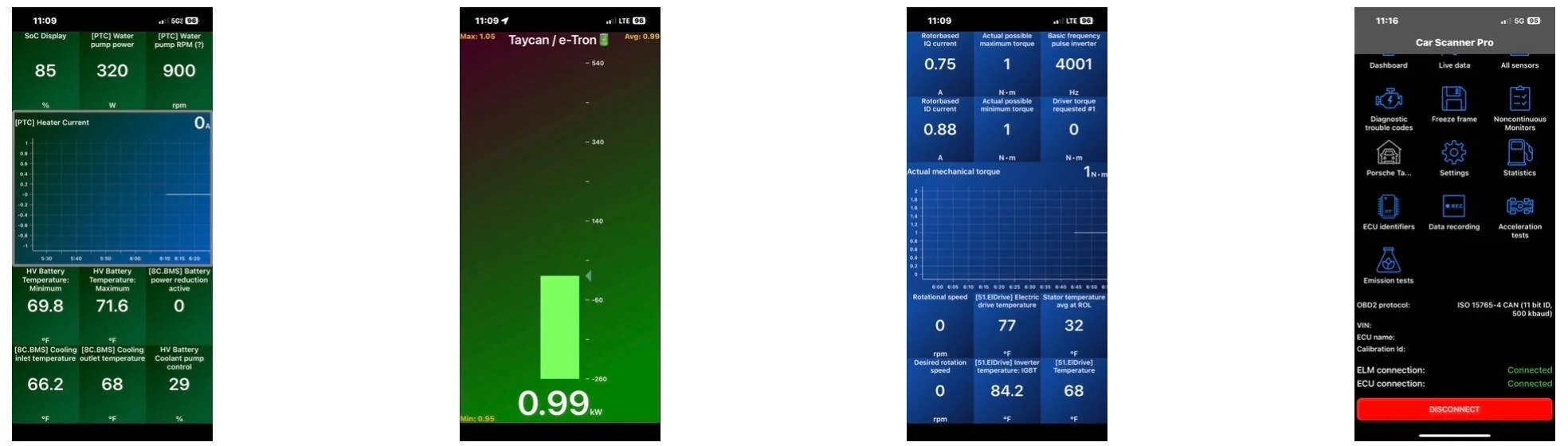

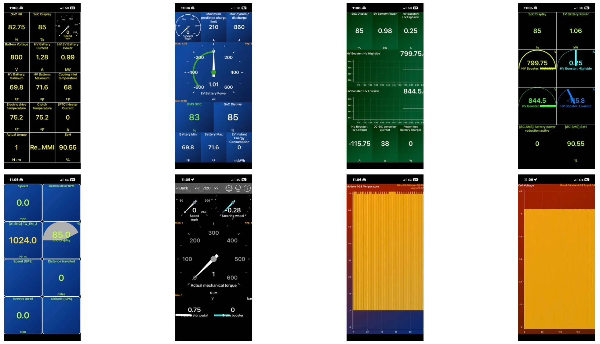

Thought I'd post the default screens that are pre-loaded/configured in the CarScanner App and OBDII scanner once you chose the Taycan profile - all customizable (and may have missed a couple of the first screens!) - just to give an idea of how much info you can extract from this simple tool:

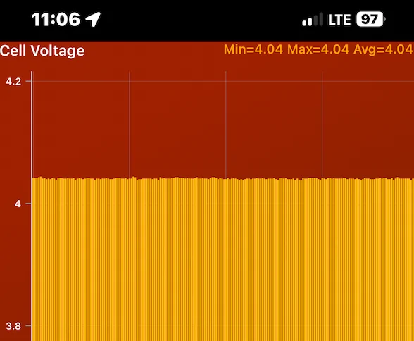

Just adding more info to my low SoH of 88.14% (2020 Turbo, 5810mi). Here is the cell voltage overview screen:
Where there is one cell that is clearly less than the rest, at 3.66v while the max is 3.674v. That is not much difference, but I think the worst cell determines the SoH (I think?) and thus that may explain the relatively low score.
But, for balance, the car is fantastic and I have no problem with range or anything so not sure how much to read into these numbers :)

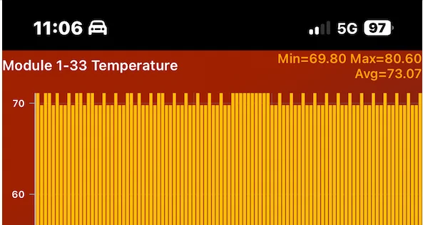

Another weird thing is that the temperature display seems to show that some (every third!) cells are cooled less well? Do others have this too? Maybe this is completely normal though and those cells sit in the middle or further away from the cooling or something.

Cell voltage health looks decent I guess:
Porsche Taycan Baseline for HV Battery SoH Performance Screenshot 2023-02-14 at 11.29.38 AM
Temp data fairly different to yours - my readings when car 'cold' (i.e. early morning after resting overnight):
Porsche Taycan Baseline for HV Battery SoH Performance Screenshot 2023-02-14 at 11.29.19 AM
