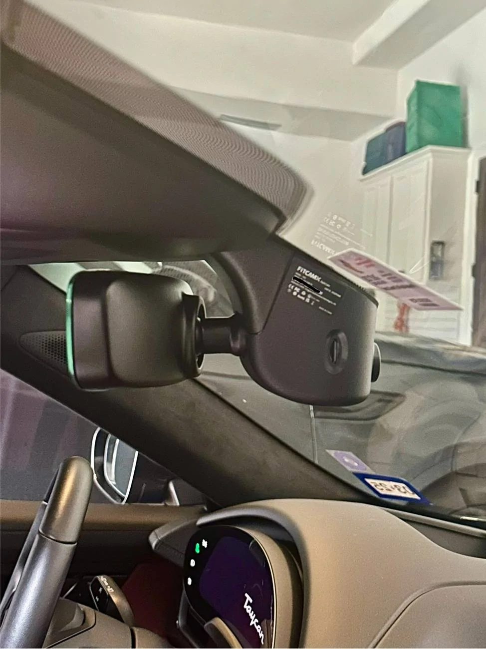

The concept and installation of the FitcamX dash cam made it the best choice for me. The specs (4k 2160P) and resulting videos meet my needs, and the seamless physical integration looks better than anything else. I have the front cam only, but there are many threads here that discuss installation of both front and rear cameras. I've had no technical issues with the camera. I access it via the self-generated Wifi every other month to clean out any unneeded locked videos, etc.

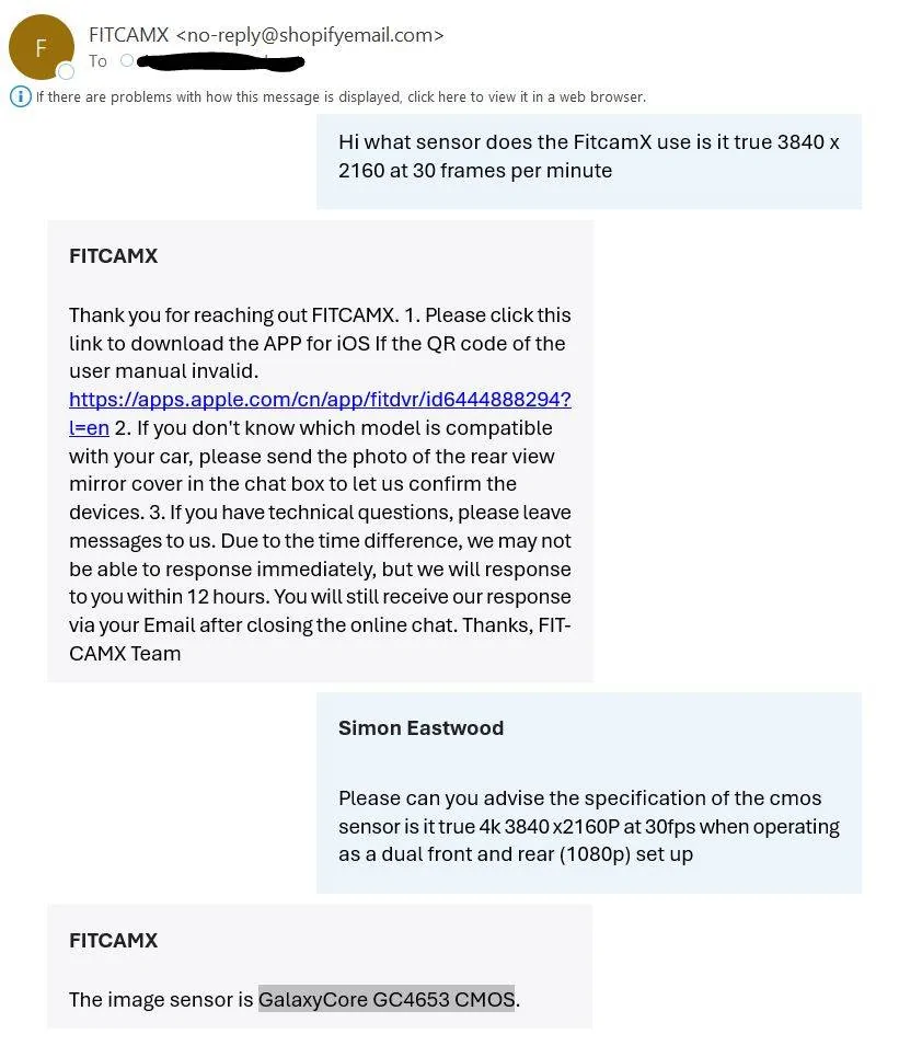

I queried the spec with FitcamX as other reviews had said it is not true 4K see attached response. The image sensor is a Galaxy GC4653 which when you look at the data sheet only supports 2k, that said it produces good enough quality for most purposes.

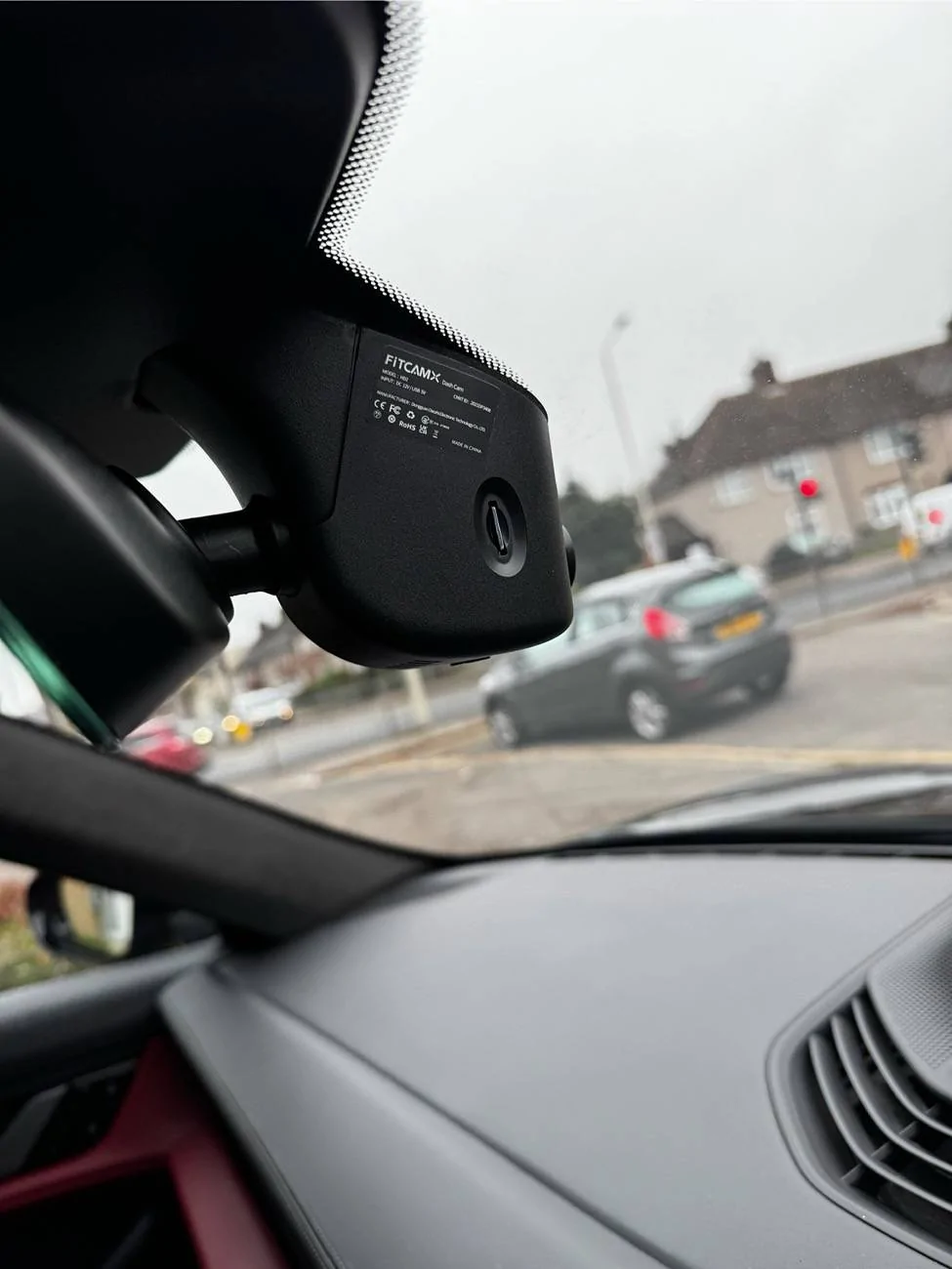

After fitcamx shipped me a different style cam than the one on their pic (and same as in the pictures above this message), I ended up with some other brand at half the price from aliexpress that has that same look ... does the job just fine.
Only one issue, it stores "accident" videos in a separate folder so the clip of the event in question doesn't get overwritten ... turns out it classifies all my stoplight sprints as being accidents LOL

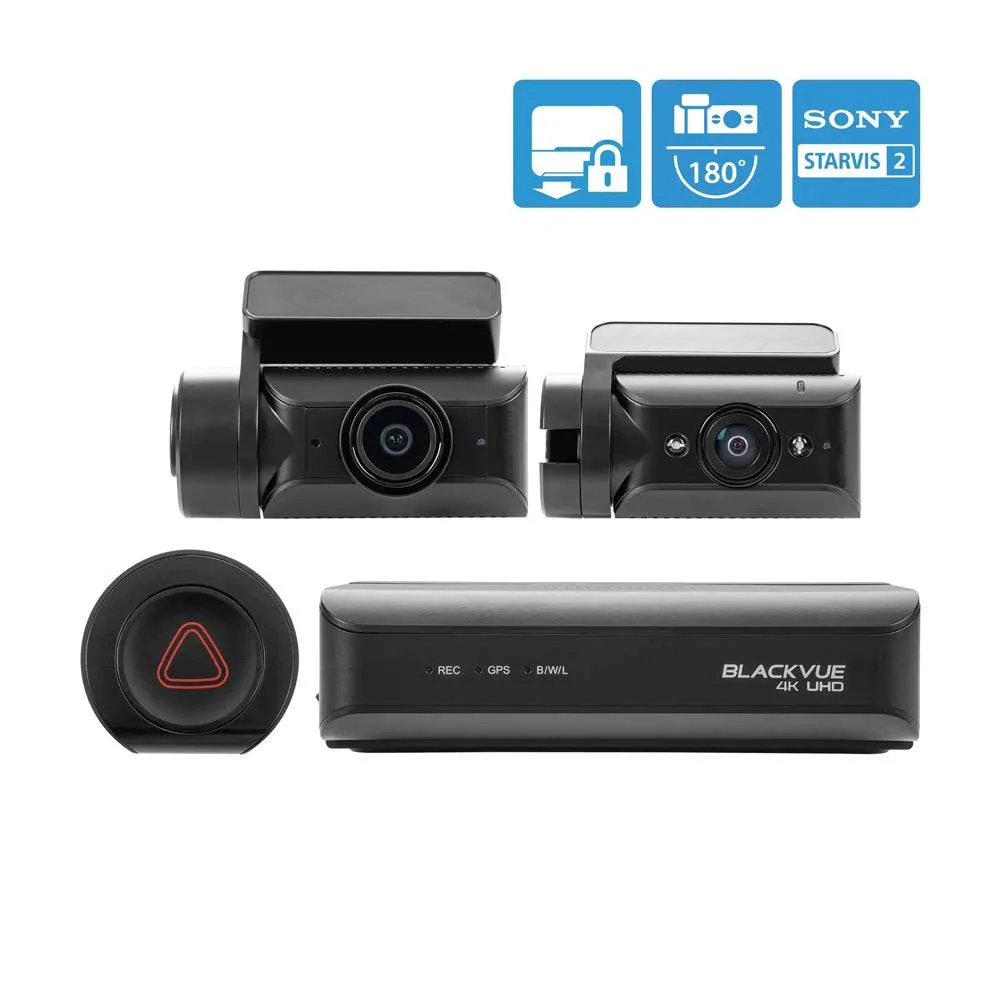

I have a DR970X 2CH that I’ll try to install this weekend in my CT. The unit itself might be in the under trunk storage in the rear and maybe use a battery with the 12v outlet for charging power. So compact in the Taycan not sure where else I can stick the unit yet.

My previous Blackvues are like what you installed but the DR970X has 2 standalone cameras connected to the main box unit. The cameras are a lot smaller.
Oh, just front cameras (the small one is an IR driver facing one)? Is that a separate GPS antenna (the one with red triangle)? I wish I had a separate GPS, but not enough to change my install now. As for where to place them, under the lower screen in front might be a good place, or hide in the foot wells.

Sorry that was a bad example. I don’t have IR. One is front facing and one is rear to the outside of the car. The little button is a Bluetooth receiver you can mount in your car. Tap it to record an event. I probably wont use it. For GPS, you’ll have to plug in an external little module and run it back to the box.

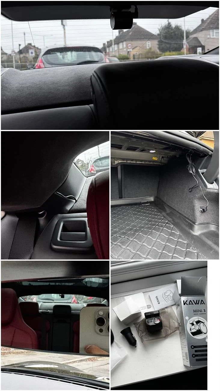

Got the cameras installed and reviewed your post and some others on the hardwiring. I don’t have a multimeter but seems like the hardwiring doesn’t provide enough juice through the wiretap to power up the cameras. Using the same taps, I can charge up the BlackVue battery.
got tired of working in the dark so I’ll give it another try tomorrow. Currently, battery in the trunk floor board, connected to the cigarette lighter to charge and powering the camera. I rather have it hardwired and going to try it again tomorrow with some daylight.
