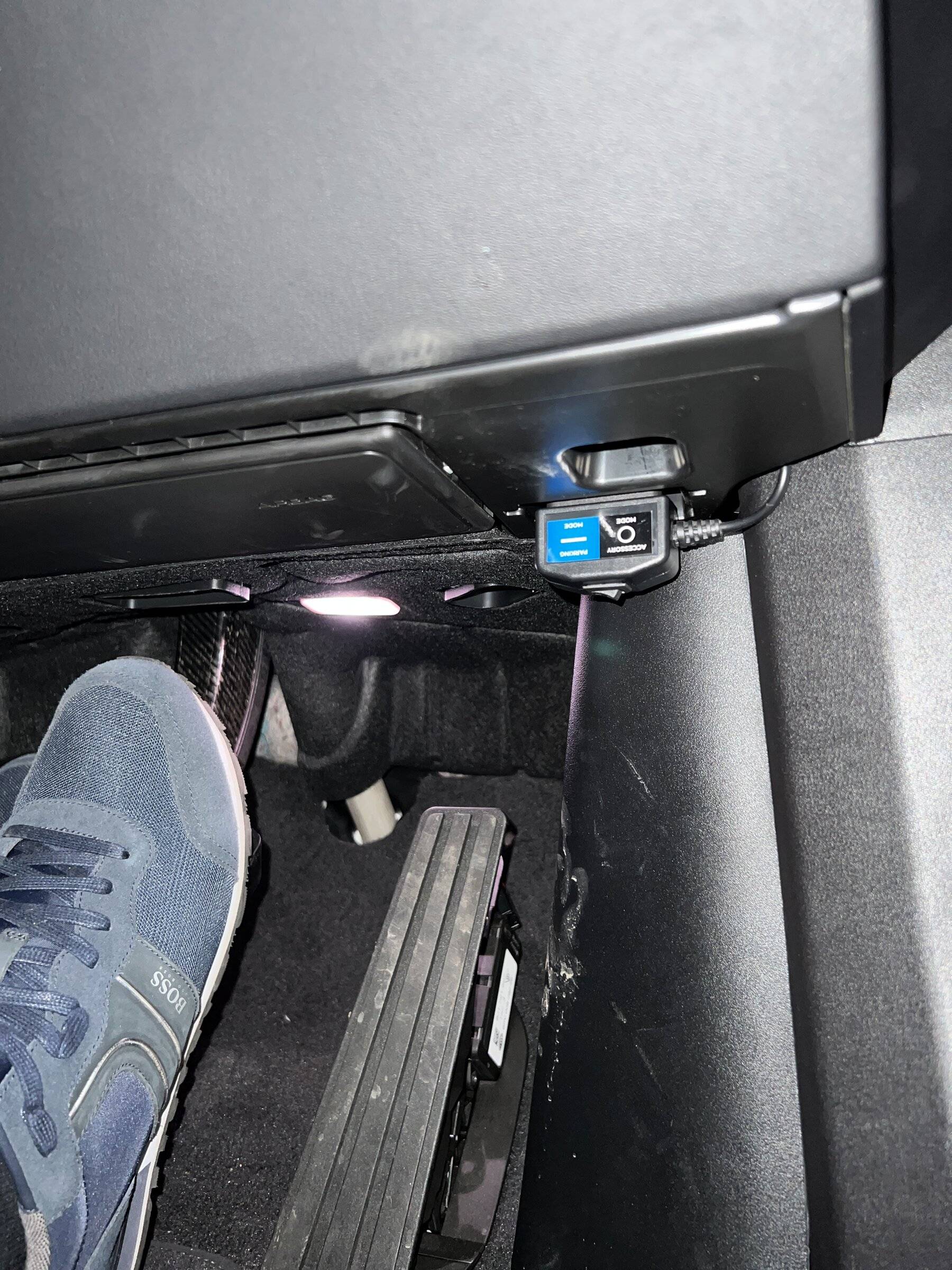

Yes this takes power from the OBD port and works both when the car is on and off. Just finished doing a similar install on my daughter's Audi A3 and my BMW M4 this weekend. Snaps into the OBD diagnostic port and then rest is same as any other hardwire without going to the tap into the fuse box or anything. Very efficient. Will see how it works out long term. :)

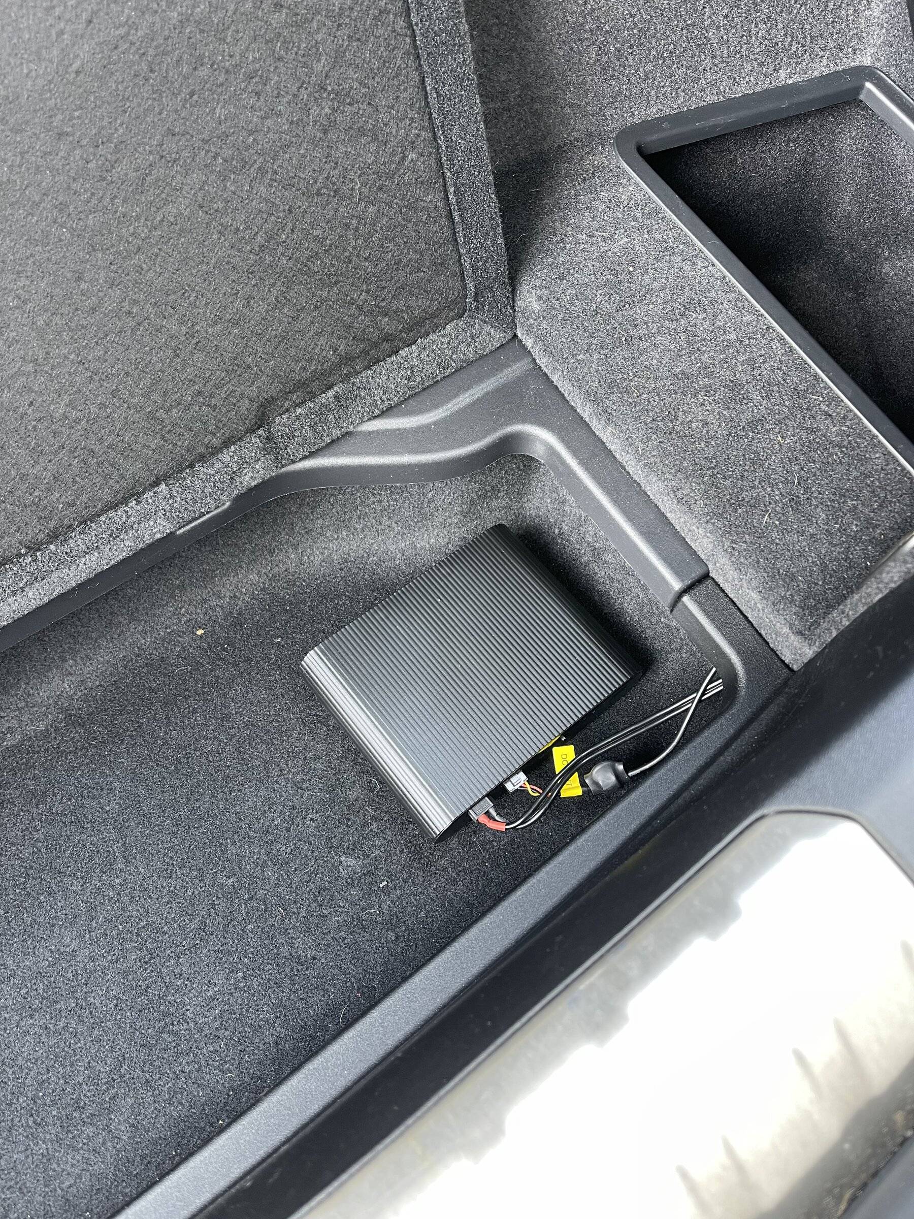

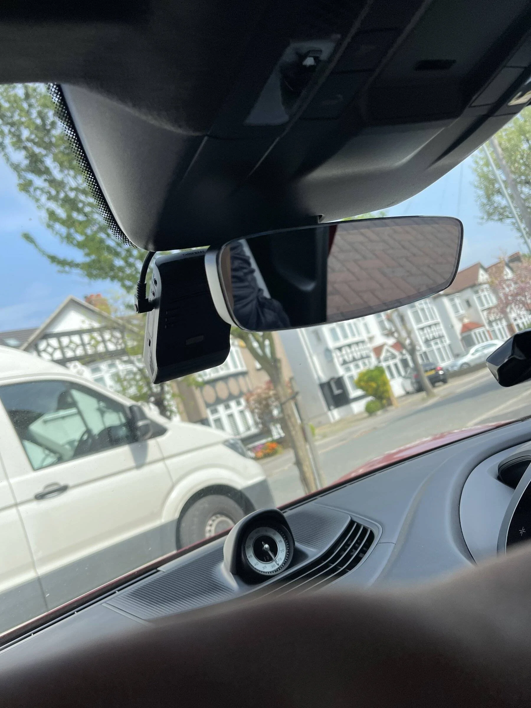

Just had the Thinkware U1000 with the ivolt battery fitted to the under boot storage area to my CT. Hopefully this removes any 12V issues a dashcam could cause. Decided against getting the rear done.
