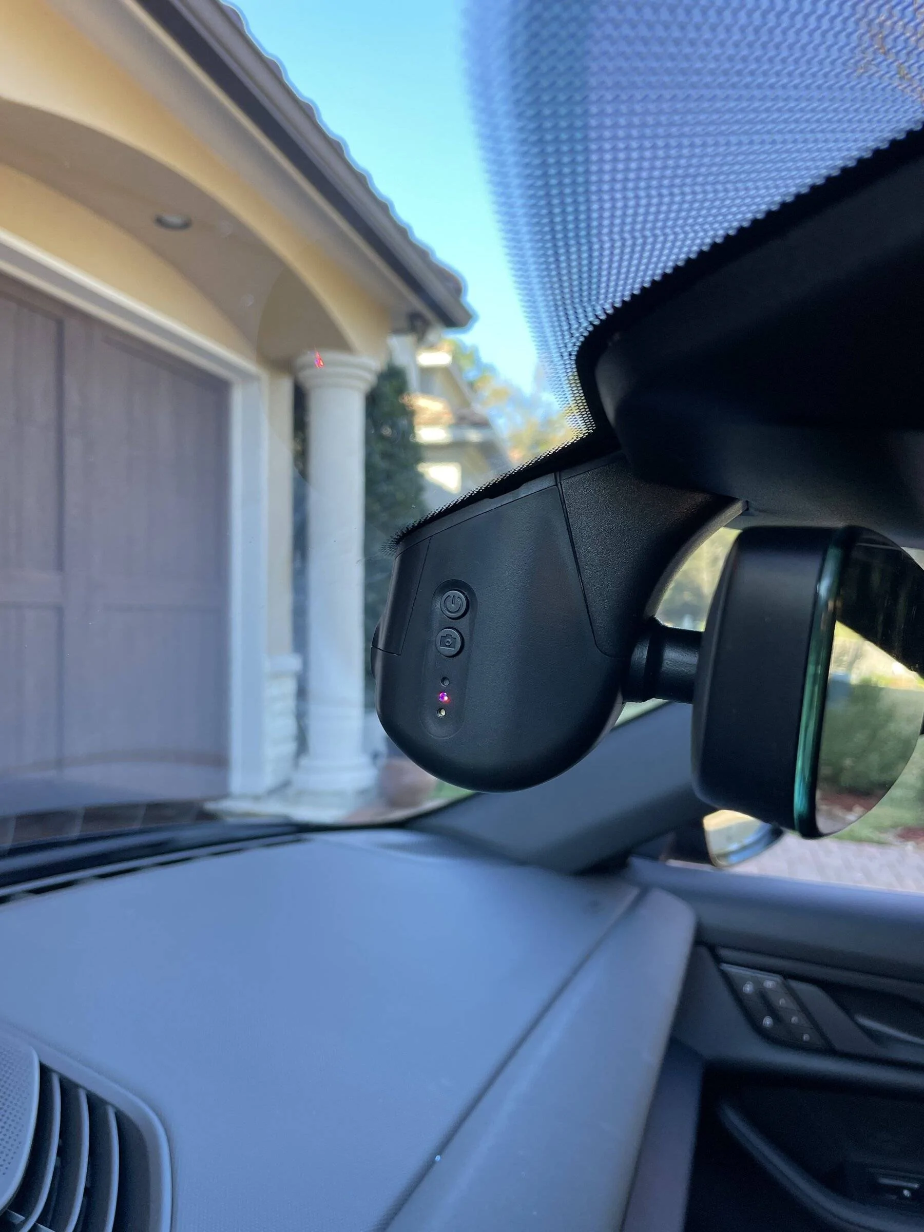

I have a Fitcamx installed in my 22 CT. It took one hour to install and it looks and works great. Since it is using the rain sensor power it is not powered on when the car is off and there is no 12v battery drain. This is the 4th Porsche I have had dash cams installed in and my Porsche service center has never made it an issue when they have been in for warranty work.
Is that the 4k version? My buttons are on the bottom of the camera.
But man, the cover where the camera installs was a b*tch to remove! I don't know how you did it so quickly. I also found it very difficult to tuck the wires under the smaller, middle trim piece in order to snap it back into place.

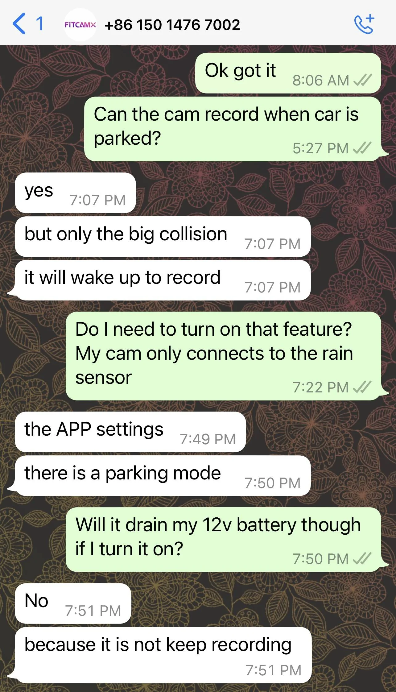

I asked Fitcamx support, and they said turning on the parking mode only wakes up the camera in the event of a "big collision". Otherwise, the camera is always off. See screenshot.
It has 3840x2160 resolution which most consider 4k And is listed as 4k by manufacturer. The trim removal tools I had were much better than the inadequate one that came with the camera but the 3rd trim piece was the most difficult. I got lucky and pulled all the wires up the left side and was able to snap the middle trim piece back on the first try.
If it's connected to the rain sensor I fail to see how it could wake up as there will be zero power.
I agree with you, but that's what he told me. Go figure!

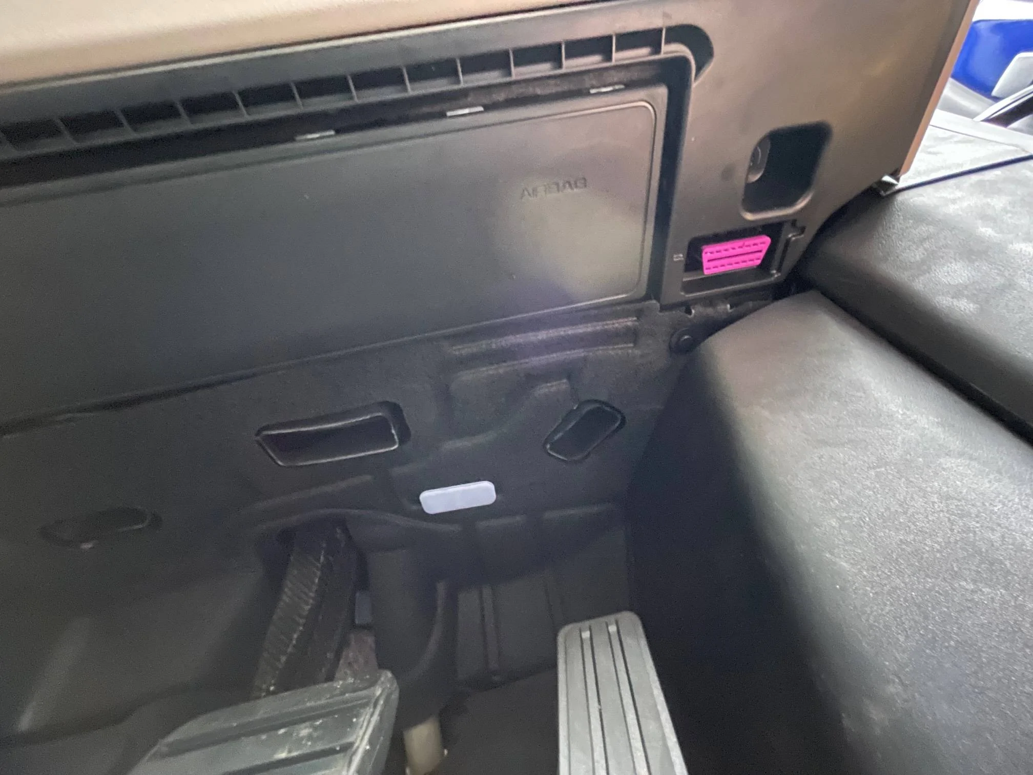

There is a plug under the steering wheel to the right hand side (same place a normal bonnet lever would be placed) that dashcams can be plugged into, I had an installer fit mine, it’s perfect and isn’t then hardwired into the car. You can’t see the cable either. Not sure what type of plug you need to fit it though as not seen one like this before.
Ive got a black view front and rear cam installed, both on the same plug socket.
Hi Mark
I had a look for this plug this morning, but couldn't find anything except for a diagnostic outlet. Where was the plug on yours please?

Here you go mate
This is for a Blackvue right? Any chance there's a part/model number for that adapter? I'm not familiar with what that plug is.
Also, what does the switch on it do exactly?
Thanks!
Switches it on or off. Yeah it’s for the Blackvue.
The guy who fitted it is Simon Holbon www.Holbon.com
