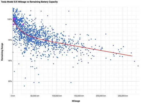

Clearly not unheard of with Teslas either:
You know what I find interesting about this chart ? Not a single Tesla in this graph would qualify under the terms of the Porsche (and probably most other EV manufacturers) battery warranty AFAIK. Surely not a coincidence.

Always IONITY charging? Always to 100%? Always fast German highway driving? More info, please?
This. If you're always charging to 100% at fast chargers, this can really degrade the battery.
A lot of early Tesla adopters were exclusively charging at the superchargers in California because it was free, only to learn at around 40-50k miles they had nearly double the degradation of folks charging at home. Similarly, people ignoring the guidance always charging to near 100% also saw reduced capacity much faster.
Of course not! To be more brave on this and get more competitive with better warranty offerings, they need more long term experience.

How fast are the Tesla DC fast chargers that cause the issue?
Any indication whether the issue with fast charging is linear or non-linear. For instance, is 50kw 5 times worse than 9.6 or is it just several times worse, but when you get to 150kw, it is much more than 3 times worse than 50kw?
the manufacturers aren‘t super forthcoming so most of the data we have is from independent researchers and cooperative owners like the above graphs. Some references to their sources here
https://electrek.co/2018/04/14/tesla-battery-degradation-data/
but there have been a lot of long running Tesla model S, so the data is pertinent. Nobody knows exactly why owners who made frequent use of high speed chargers were correlated with more wear and owners with less were closer to the median.
chemically high speed chargers generate a lot more heat and slamming the electrons in is definitely more stressful. So as a hypothesis it seems coherent.
the outliers don’t seem really far apart. Eye balling, it looks like the worst effected were closer to 80% original capacity while the median was more like 90%.
