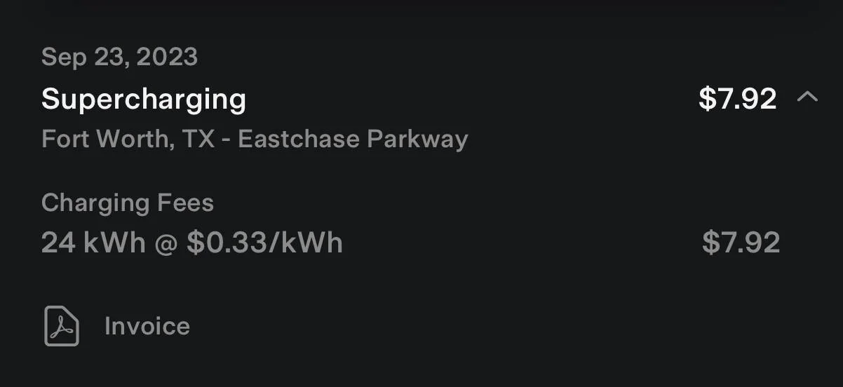

Interestingly, the brief 1-2 second of charging that I got reported as this in the Tesla app:
Porsche Taycan Broken DC Flap Causes Bad Charging Day IMG_1730
So it's still a potential that my 150kW option got zorted, or the Tragic Dock can't handle it.

You're probably right. If something got legitimately zapped I'd expect some complaining in the car's UI about it.
It is interesting that I got charged for 24 kWh though...

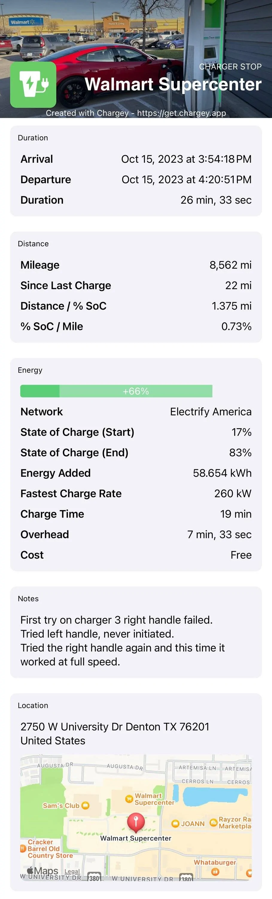

Well, some good news. After I got a healthy AC charge on the car at home, I took it to a fast DC charger and confirmed that's working as well.
I tend to think @Archimedes is right; the plastic bit from the flap blocked the channel and prevented the magic dock from seating properly.
I will (eventually) try it again, but I won't go into it empty. I do want to confirm my 150/400V option works, and confirm to myself that I can count on Tesla Superchargers when traveling.
