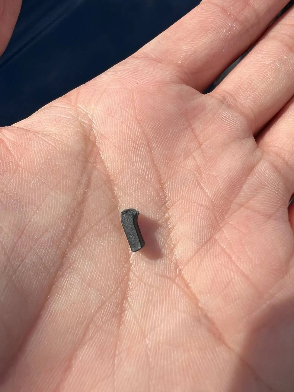

TLDR: Be careful not to break your DC flap inserting the Magic Dock (or any other CCS charger)
I decided to drive to Fort Worth this morning to try out the Magic Dock Supercharger.
I arrived with pretty low SoC and was a bit stressed, but hey these things work great right?
The app and dock worked, but charging immediately halted with an error.
I tried several times and it would not work. I also tried another stall.
At this point I am experiencing range panic for the first time. I limp to nearby Kroger with a Blink AC charger to find one stall can’t scan my card and the other just didn’t dispense any power.
I’m currently waiting for a tow to get it home and hopefully charge there before I assess further.
if that doesn’t work then I’ll have it towed to the dealer Monday morning.
I’m sorry I tried this.
EDIT: What I think happened here is I broke the DC flap while plugging in the Magic Dock, which put some plastic debris in the channel around the DC pins preventing a solid connection. Car is fine both AC/DC working as expected. I'll try it again one day but with more overhead for contingencies.

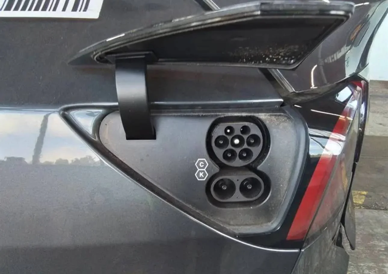

Both CCS2 and NACS could not have had this problem - it's impossible due to simpler design with fewer moving parts.
We’ve got the silly little flap on our CCS2 equipped Taycans here, but as we don’t have any need for any third party adaptors at Tesla sites like magic dock here, I guess we don’t have any potential for an issue like this.
Not all CC2 cars have the little flap by the way. Tesla vehicles ironically are good example. Just the main cover is all that’s needed:
Porsche Taycan Broken DC Flap Causes Bad Charging Day IMG_0011
It’s just an over-engineering step too far and clearly just something else to break eventually.

It's a great question that I have no answer to!
This morning I got out there and examined the port some more...there's nothing visibly broken about the flap.
https://share.icloud.com/photos/084z-1j4C2XlqWI66iYNw5b5A
However, I shined the light in there and found that the "microswitch" I thought was in there was actually the broken bit of plastic! I was able to fish it out with a starbucks stopper and some sticky tape.
It's still very strange this happened. I've only used the DC charger (checking Chargey)...9 times before the Magic Dock attempt.
I still have no idea how this was broken; if the Magic Dock somehow caused it or just dumb luck. I do feel pretty confident that if I try again, charging at the Magic Dock will work fine.
