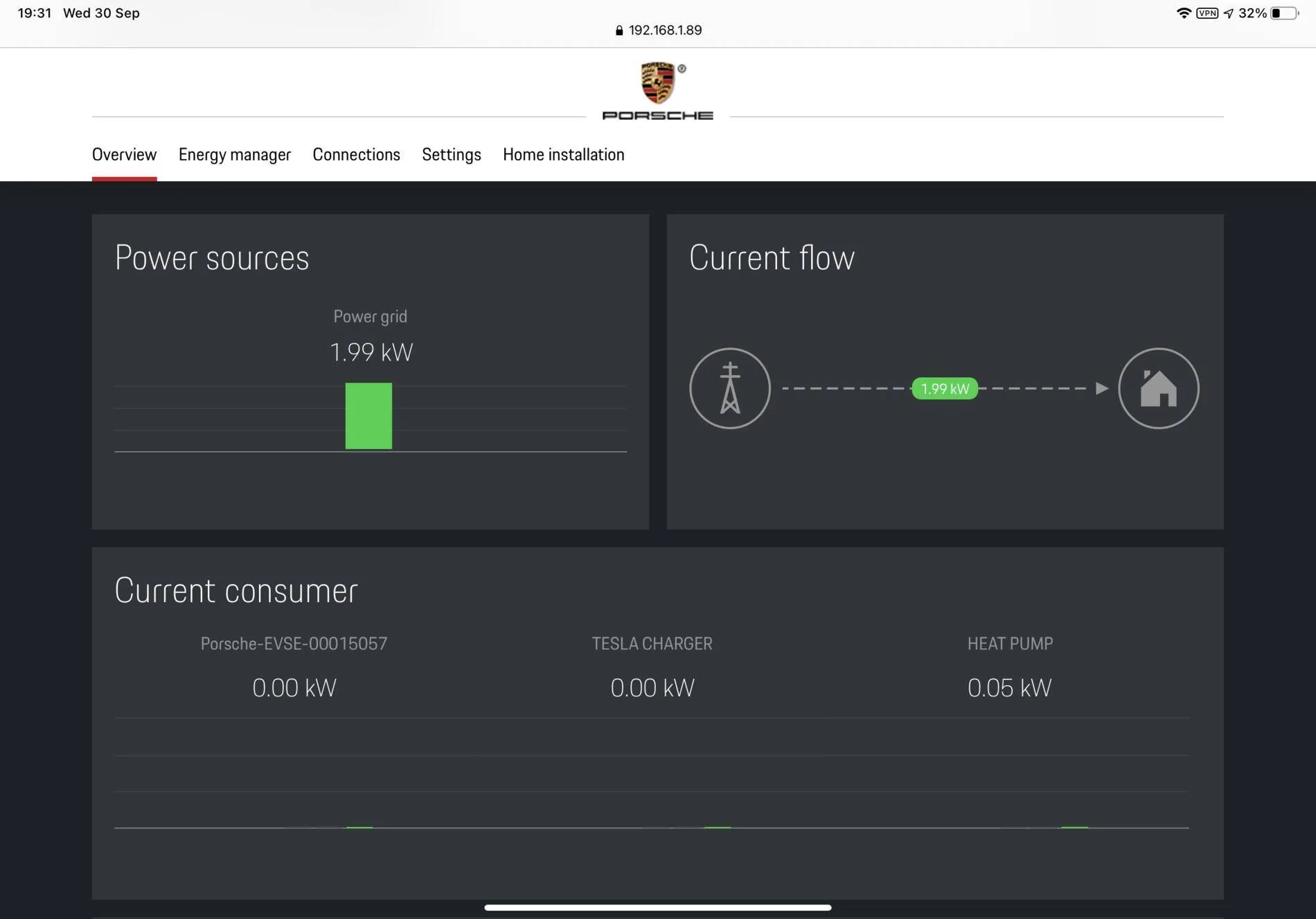

Thats a cool screen! I've never seen it before. Nice way to see what your spend is on home charging. I found the screen on the website, but my costs are blank. Presumably you need to tell it somewhere what you pay for electricity. Something you set in your profile? I can't find it - can someone tell me where that setting is?
3,047
2,638
Well you can see some costs on the screen shot yes. But the costs that are displayed for me are not my electricity costs at home. The Porsche site seems to have calculated the costs this time using the rate we have for charging at Porsche Charging service stations, ie charging on chargers in the approved Porsche network? No idea why it has taken these costs or where you could adjust them? My main interest was really to see how the charging did during the night.
I do have the Porsche Home Energy Manager installed in the house hoping that it will adjust the charging power during the winter half so that I do not trip the main fuse by overloading my circuits. And in the setting for that unit I can set the the correct costs per kWh. But those are a third of the above costs and not used. That system I need to get behind later on as well. That’s for another day.
Huh. In my screen, the costs are blank. It would be nice if you could tell it what your electricity cost is. I have a home energy monitoring system that lets you do that. But it doesn't break out the car charging from the total.
3,047
2,638

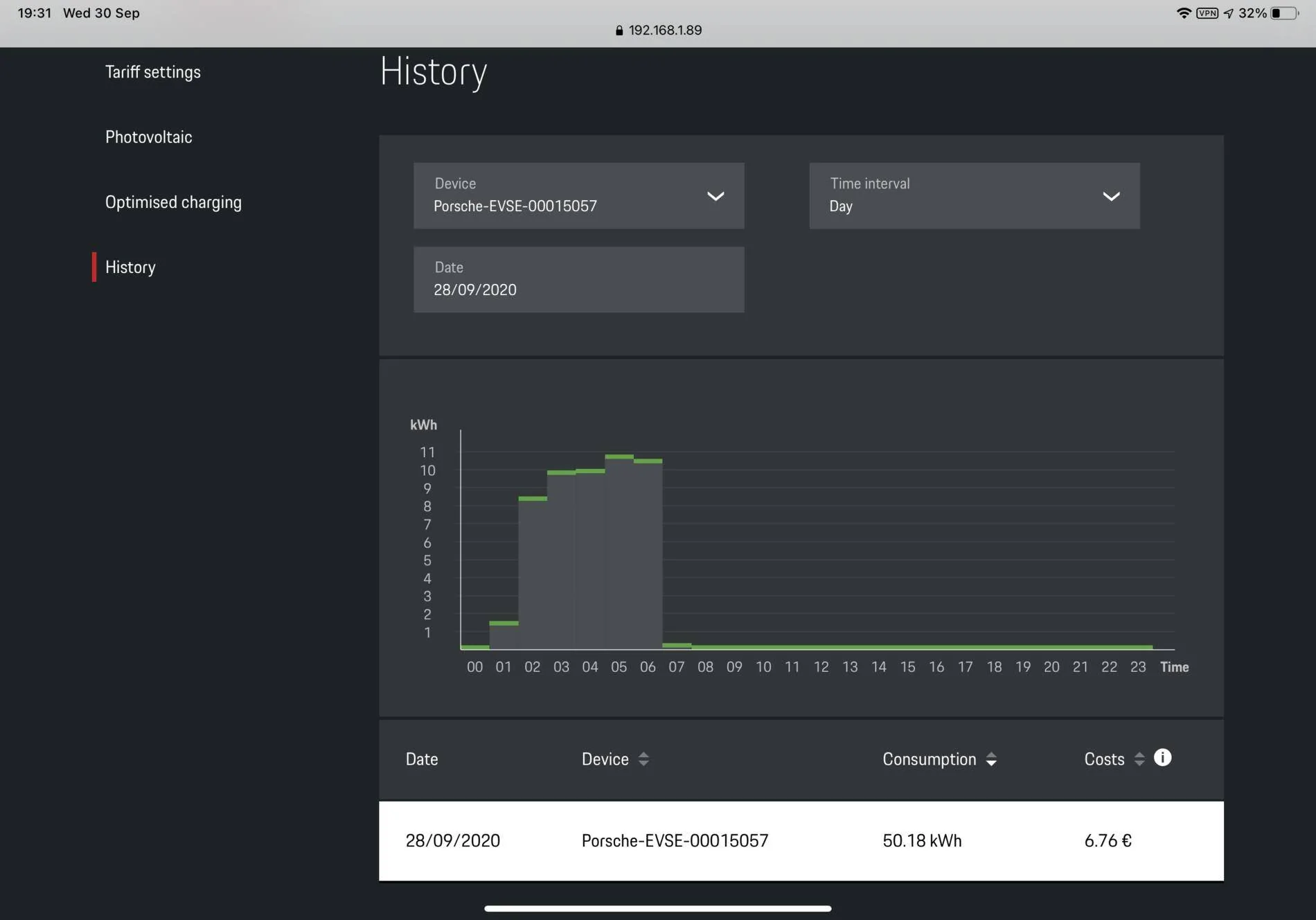

@Dave T
Here are two screenshots from my home energy manager. I hve not had any of the chargers or the heat pump running today so the graph is Not visible
Porsche Taycan Car died over night… 01B2D9CE-5B9D-4642-BDD3-A0B08A57AE1A

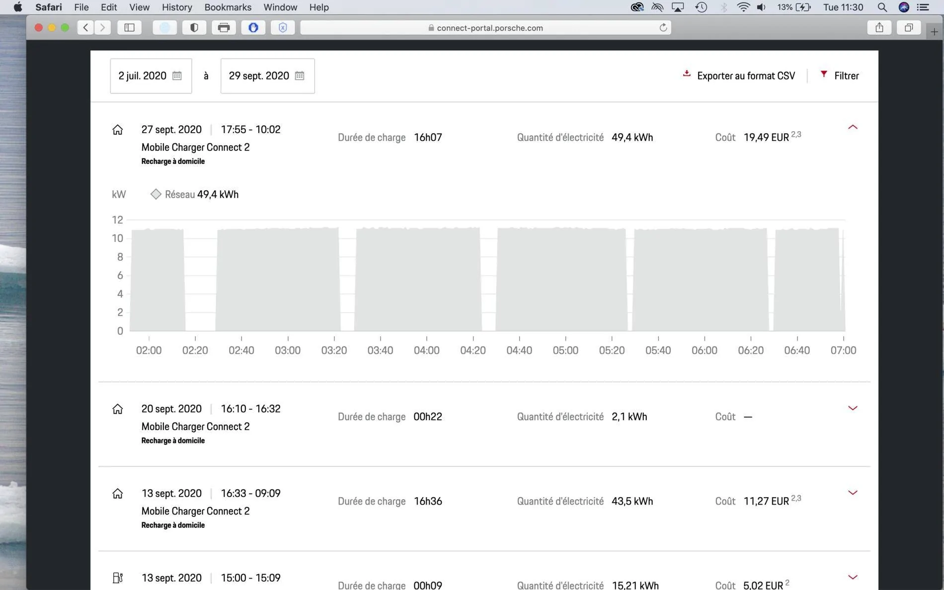

Here is a graph from the PCCM from Monday, which is the same day as in my other post. This shows how the PCCM was charging over night as well as the correctly calculated costs. In the settings for the costs, I have had to set the different rates during the day, both two day time rates and two night time rates. This should then theoretically enable the car to charge t optimal times to minimise costs.
Porsche Taycan Car died over night… CDFE210D-4E70-4DE5-B604-E3F03C35E740
I have set the charging profiles in the car to charge to 25% when plugging it in, and then optimised charging to 85% and it works a treat.
