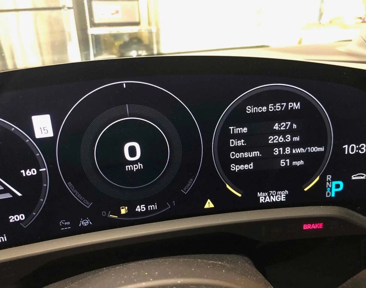

I arrive at my destination at 17% battery - my gingerly driving worked!!! Range extended!!!
This was an awesome trip!!! And the vehicle achieved an average consumption rate of 3.22 mile/kWh - very very efficient and well above EPA estimates

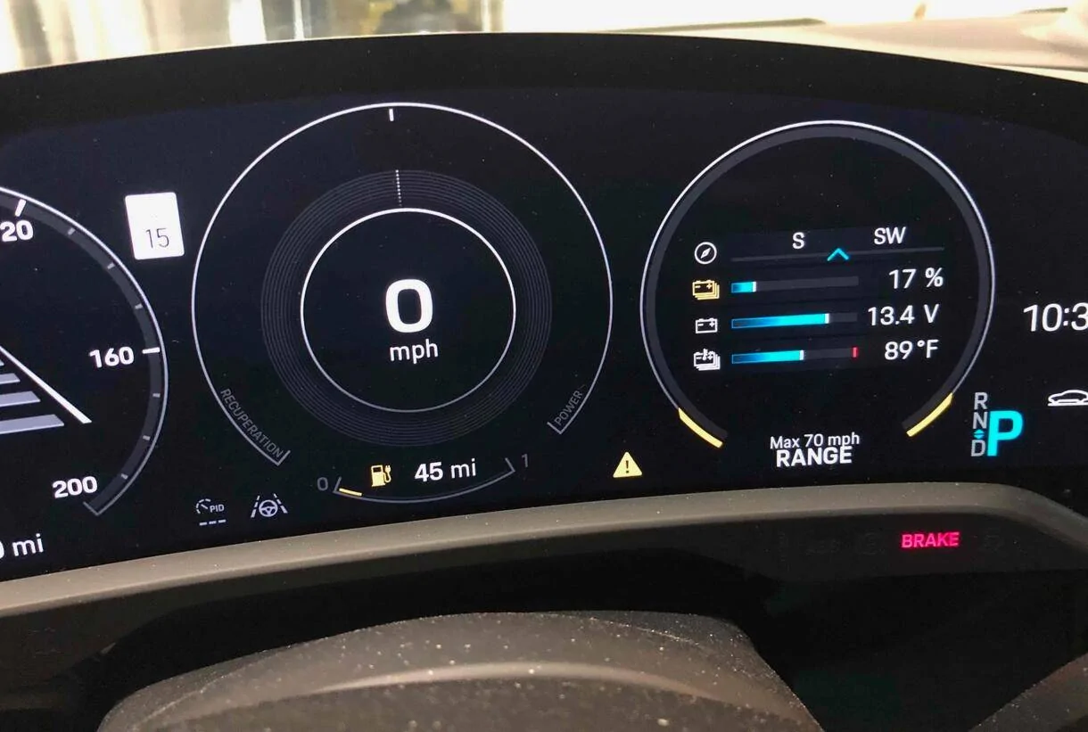

Vehicle Status upon arrival shown below - this should be interesting to Porsche because I track the battery Voltage and main battery temp in my information screen - battery SOC 17%, 12volt Battery voltage 13.4 volt (normal based on my experience), main battery temp 89F, time 10:33 pm

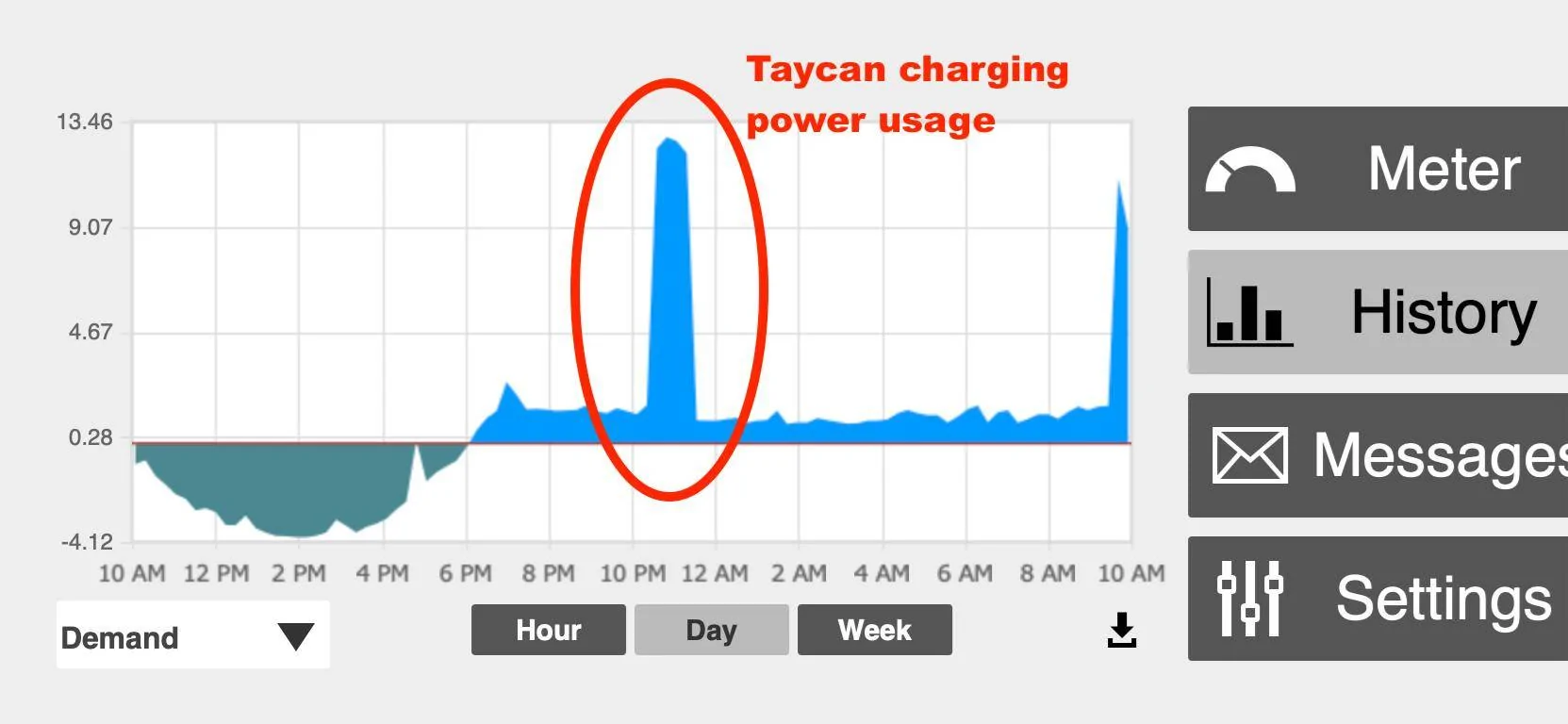

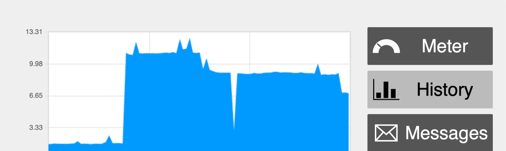

I plugged into my 11 kW EVSE at 10:35 pm
Charging was cooking along at 10.5 kW at 10:39 pm with a target SOC of 85%
I verified charging was still working via Porsche connect app between 11 pm and 11:15 pm - then I went to sleep According to my home power monitoring the vehicle continued to charge until 11:22 pm - but by 11:36 pm it had stopped for some unknown reason - see picture
See picture below - the “blue” spike is power usage for my whole home - you can clearly see it had stopped charging shortly before midnight - reason for charging stopping is unknown at this time - EVSE had power Sunday morning and showed no faults
