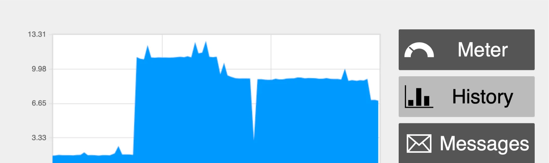

@daveo4EV the above is a copy of your image in your post. I wonder why the Porsche charger seems to stop charging at some regular intervals? Are these stops linked to the 12 volt going bad?
Here is a screenshot of my charging the other night which was visible in myPorsche under domestic charging. It seems the car starts and stops the charger several times during the charging process. Are these stops perhaps linked to the 12 volt issue?? Does the car get into some kind of loop at these stages and can not get out of it?

@Scandinavian - good questions - with out access to the logs we don’t know why the vehicle sometime’s stops charging -but it’s an excellent observation.
