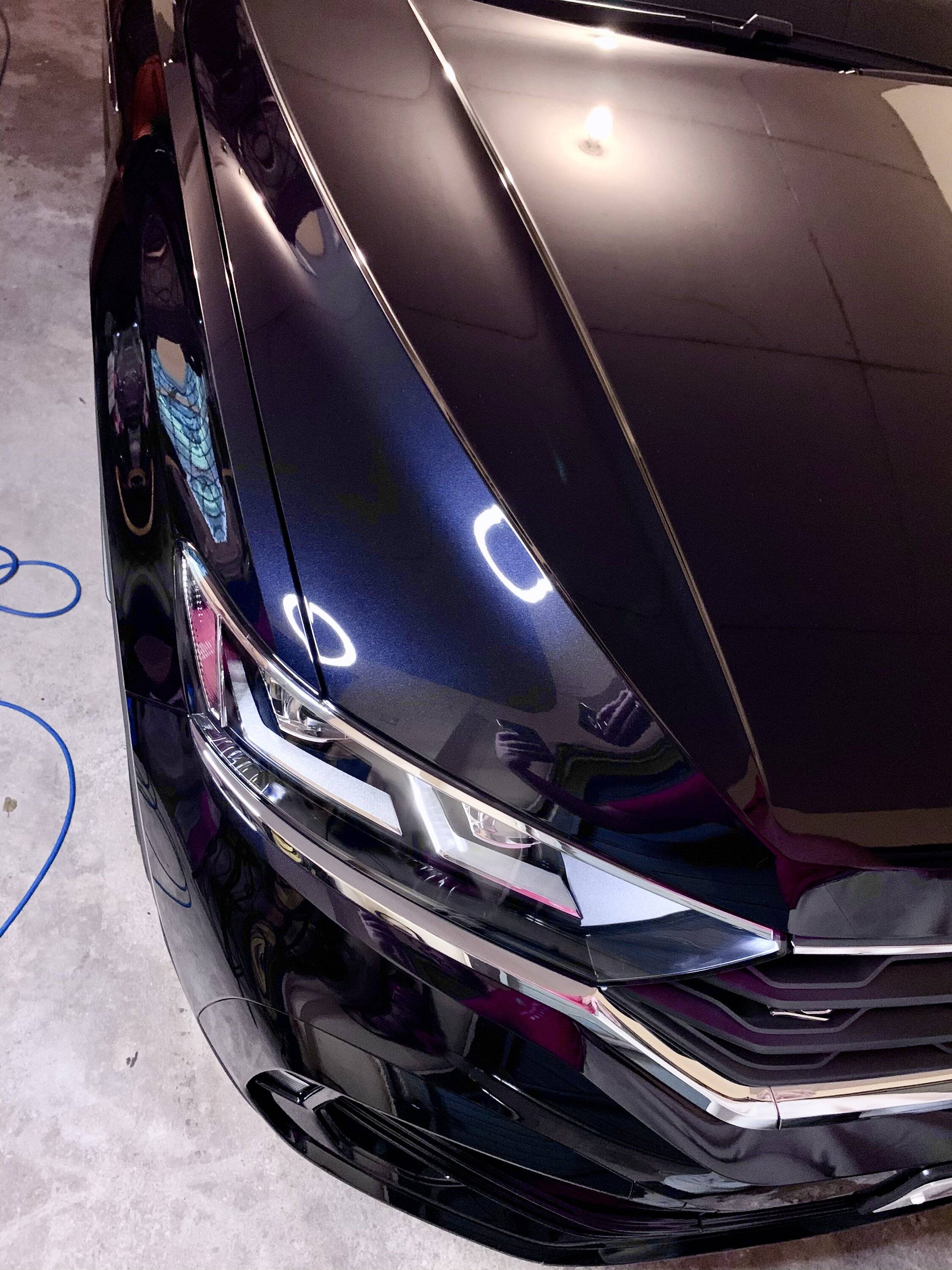

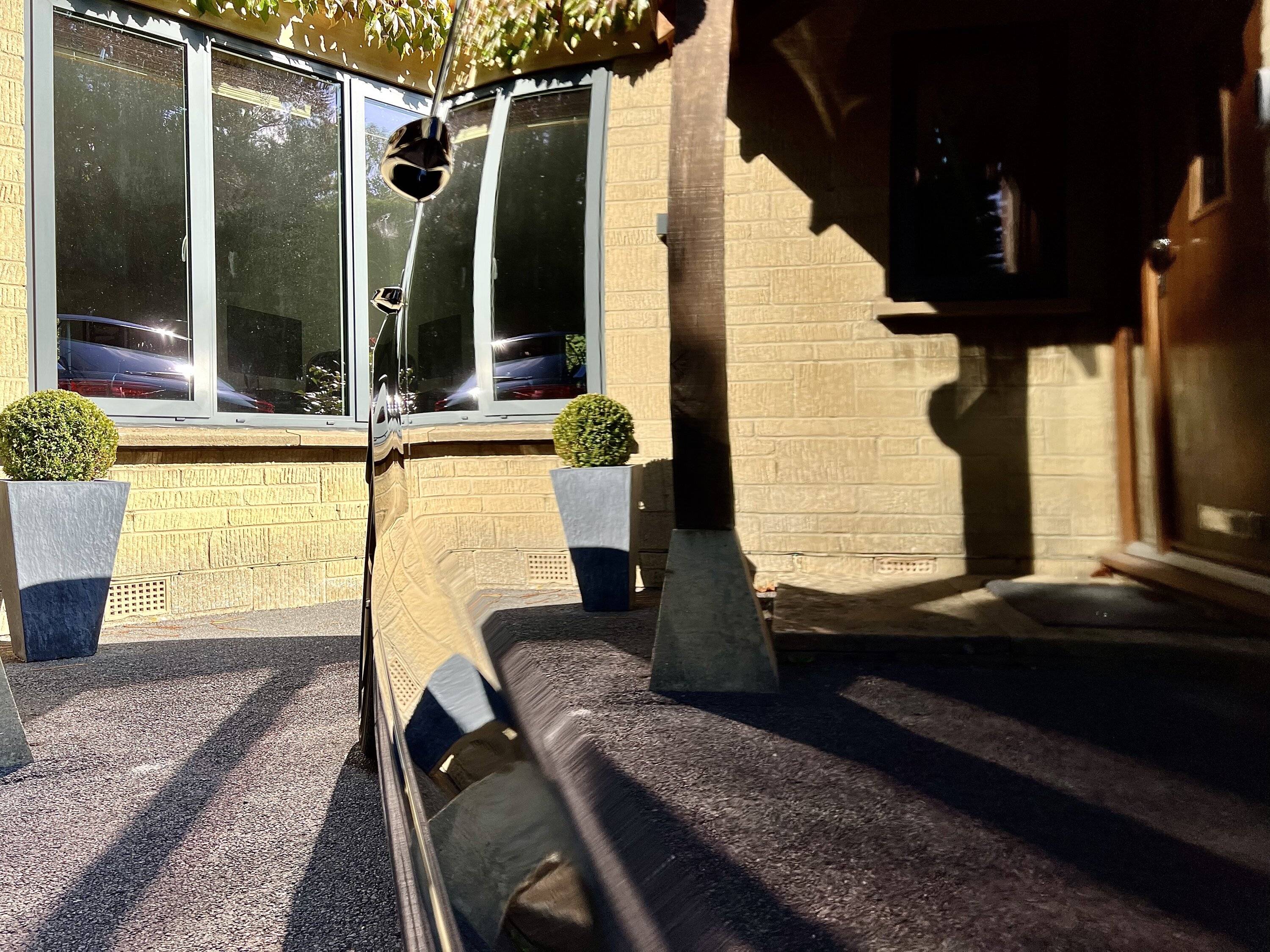

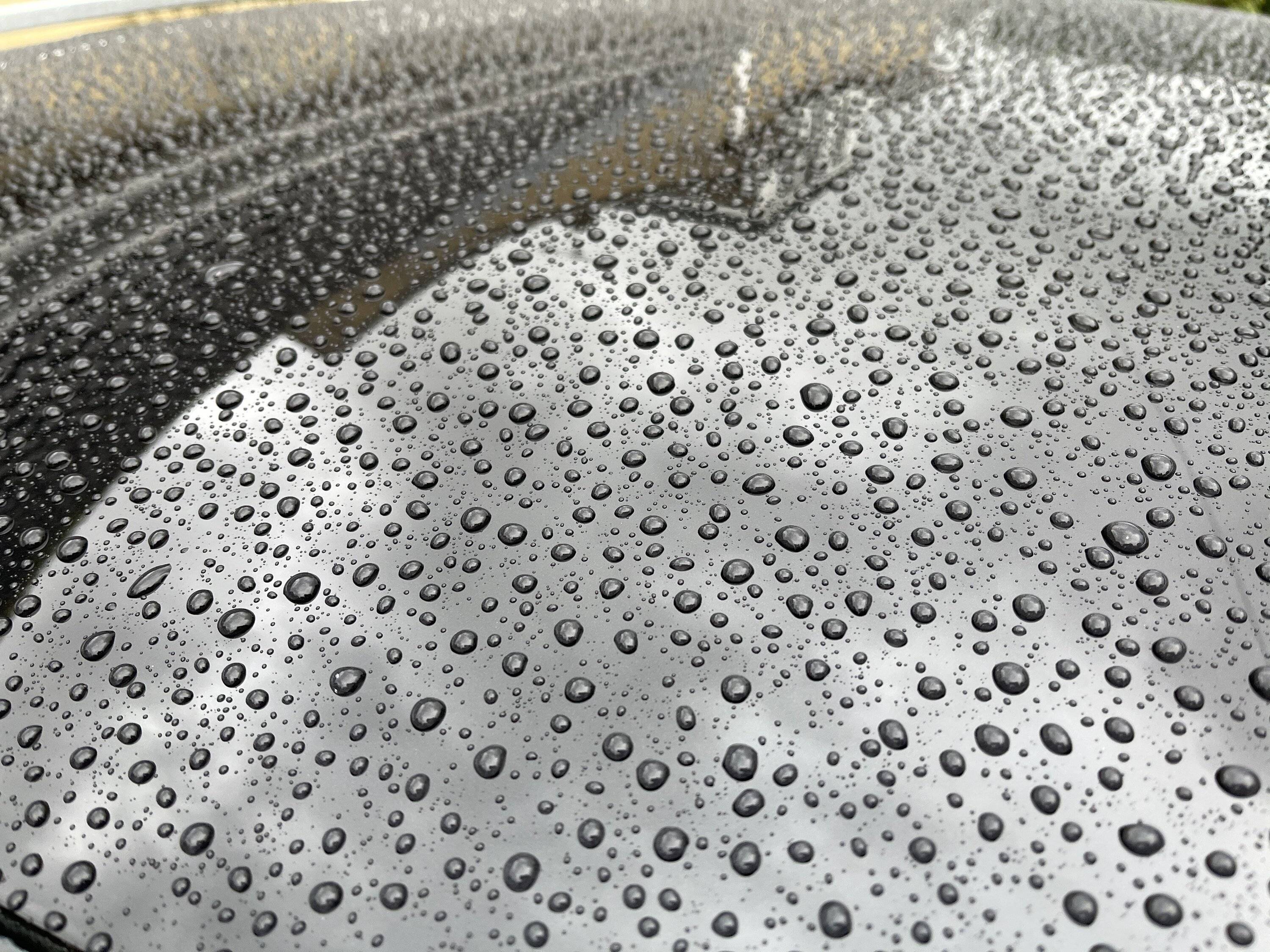

Depends on which wax but while it’ll look marginally better on gloss and bead even more, it simply won’t hold for more than 3-6 months depending on how often you wash it.
I had been detailing my cars for 10 years before adding ceramic to one, and I’ll probably carry on doing it.
Few caveats on ceramic based on my experience - 1. it is less recommended for older paint / with defects and requires great prep work 2. You can’t polish any fine scratch out or it’ll remove the coating 3. It requires extra care for people not used to spend time on washing (pH neutral products, pre wash, avoid contact when dying…) 4. It’ll require a top coat boost after c.18mo if you want to keep the gloss / beading properties. Alternatively, it can be enhanced with wax or quick detailer sealants after washes.
But final result of ceramic will be worth it if you’re prepared to care for it:
Upon application:
Porsche Taycan Ceramic coatings / sealant, do details guys not like this produce because it takes their every-3-month work away from them? E207A530-63AC-4DB6-ABF6-AF060D00DE24
Porsche Taycan Ceramic coatings / sealant, do details guys not like this produce because it takes their every-3-month work away from them? FA701A94-F3B1-4B1A-9D42-0F1AF281D438
Porsche Taycan Ceramic coatings / sealant, do details guys not like this produce because it takes their every-3-month work away from them? D71F9D7A-497E-4552-AF3F-D0D318FD2BDC

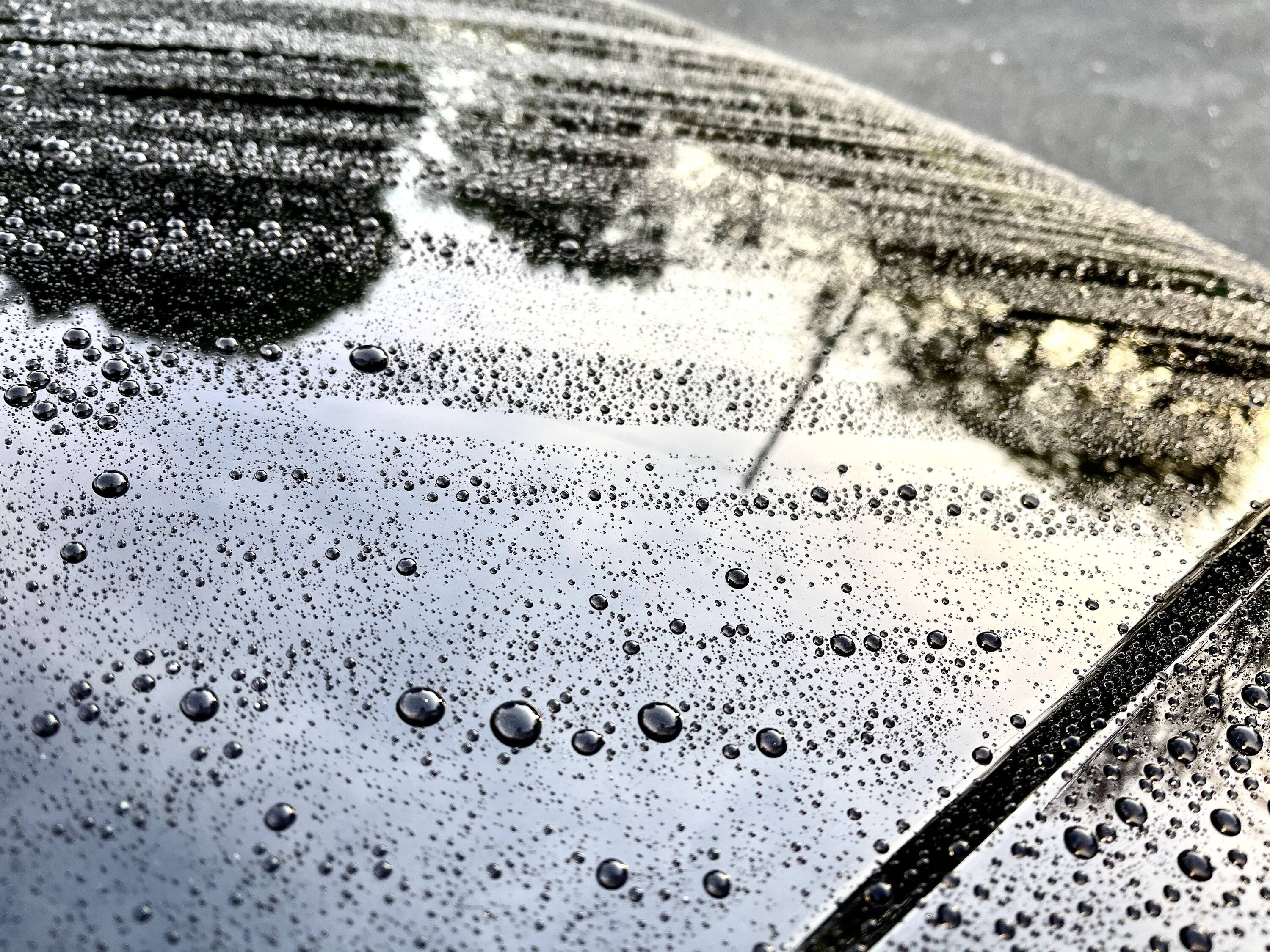

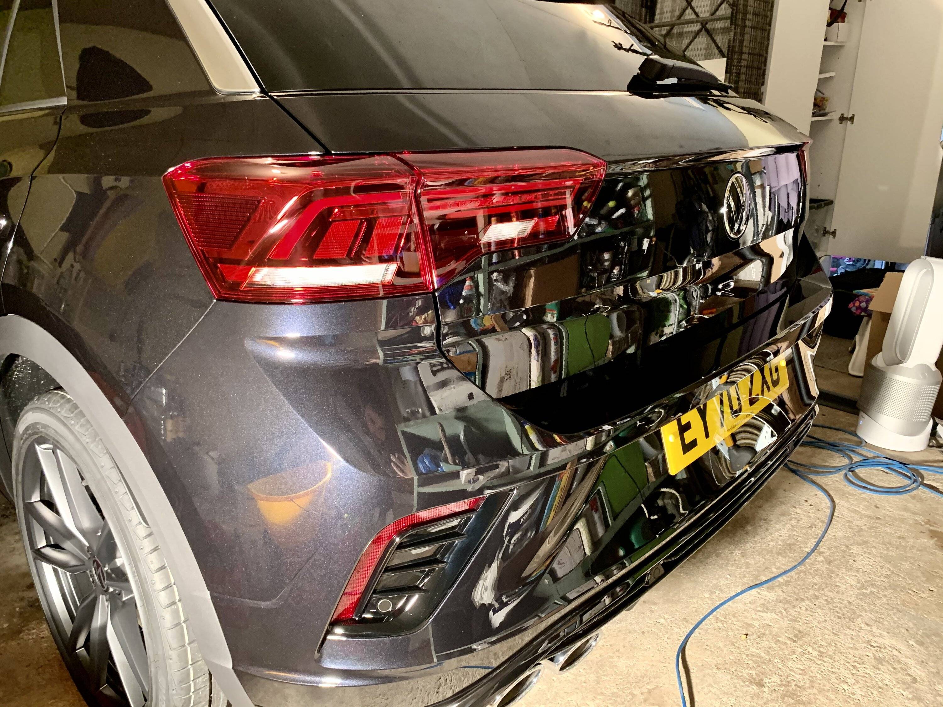

After 1.5 year:
Porsche Taycan Ceramic coatings / sealant, do details guys not like this produce because it takes their every-3-month work away from them? 5D61A770-C094-4361-94C8-F78B1D9AAD51
Porsche Taycan Ceramic coatings / sealant, do details guys not like this produce because it takes their every-3-month work away from them? 5FEC4BE7-1B66-47B9-BD8B-9B463FB70FA7

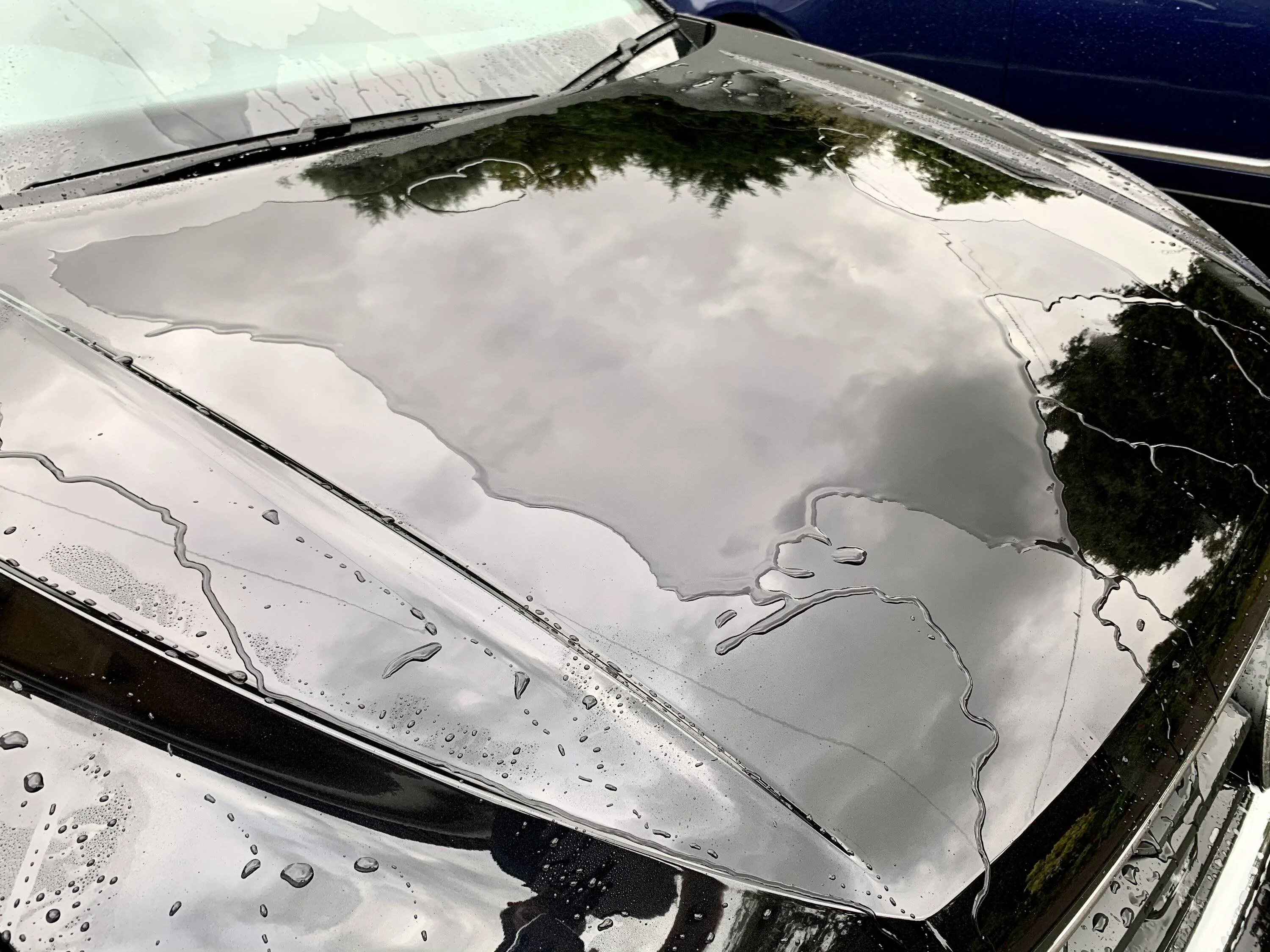

Without any coating on brand new paint, all water just stays there:
Porsche Taycan Ceramic coatings / sealant, do details guys not like this produce because it takes their every-3-month work away from them? 8E2644A1-357C-48CC-8434-38D83A0CD36C
