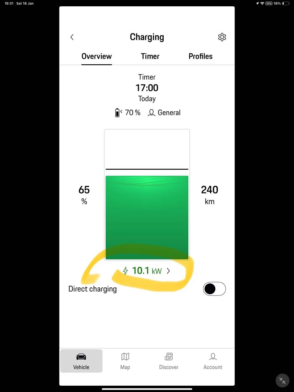

there’s no explicable reason why this should work and what I shared doesn’t though, right? Unless the whole thing is simply a total mess.
I agree with your statement. My assumption at this point is that your car has a bug. If you want to try duplicating my setup, you have the info. I hope you get it sorted.

Sounds logical! But I have found it does not always follow logic. The only thing I could think of here would be to reduce the profile setting to a lower setting say 70% and then set the timer at 85% for tomorrow at 07.00 .
I would also like to know how much power you get from your street lamp post. Maybe tha car has not got enough time unr´til 02.00 to charge all the way to 85%. And when the profile finally hits that it stops for a while and then it has no further instructions! Then it might well start again and just completely charge the battery. Not logical, I know but this is German engineering at its finest!
That is why I have had success with setting the timer on repeat
It’s all an insane mess.
even if I set the timer to many hours longer than it needs it still overshoots it

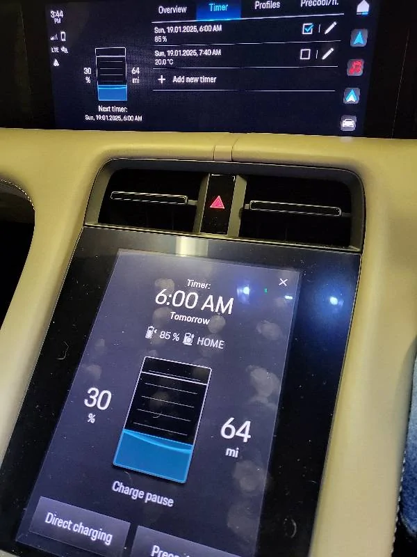

I may not have an answer for you but here are a couple of thoughts.
Don't trust the app, half the time what you set on it does not go to the car. To be sure the car's going to do what you want, look at the charging screen in the car and be sure there is a white line at 85% and a time when it's to get there.
If you forget to tick the profile box (blue tick in my photo), what you set won’t work (probably why 'repeat' seems to be popular).
Finally, direct charging, if that's pressed, all bets are off and it will go straight to 100%

Thanks, but yes, have made sure the car has the settings too, and it still ignores the limit :(

Have already said the specific public chargers being used don’t allow you to set any limits

Read through the whole thing looking for the obvious to help.
Confirmed this is in fact AC charging at 10kW or so and Direct Charge is OFF.
Solution 1: Standard procedure to just set Profile (location independent) for 85% and Optimized. Make sure the EVSE is a dumb one and no Timers. End of story. Tested by many. Car will start charging immediately to 85% and STOP.
Solution 2: However, if you start playing with Timers, and want the car charge to 85% by departure time, then the obvious miss is that it MUST be recurring or you set a ONE OFF dummy Timer way into the future if you do not have predictable daily recurring schedule, because, this is how we verified with multiple tests the logic works.
Non-Recurring Timer like I saw above for the Sunday, if it expires even though you said go to 85%, will be executed, BUT the car is looking for the NEXT instruction on what to do and if there is NO recurring Timer or ONE OFF Timer, then it will restart to charge to 100%.
